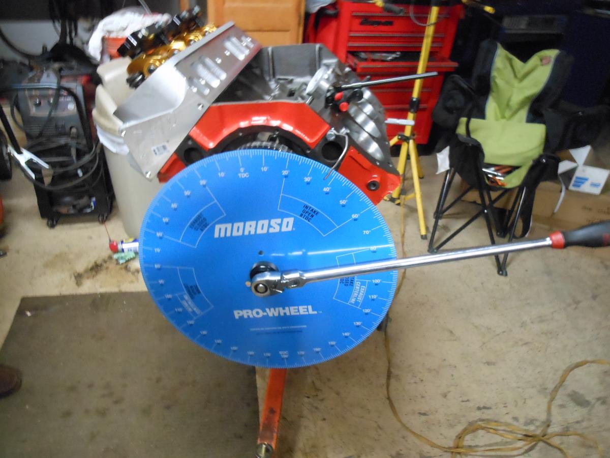

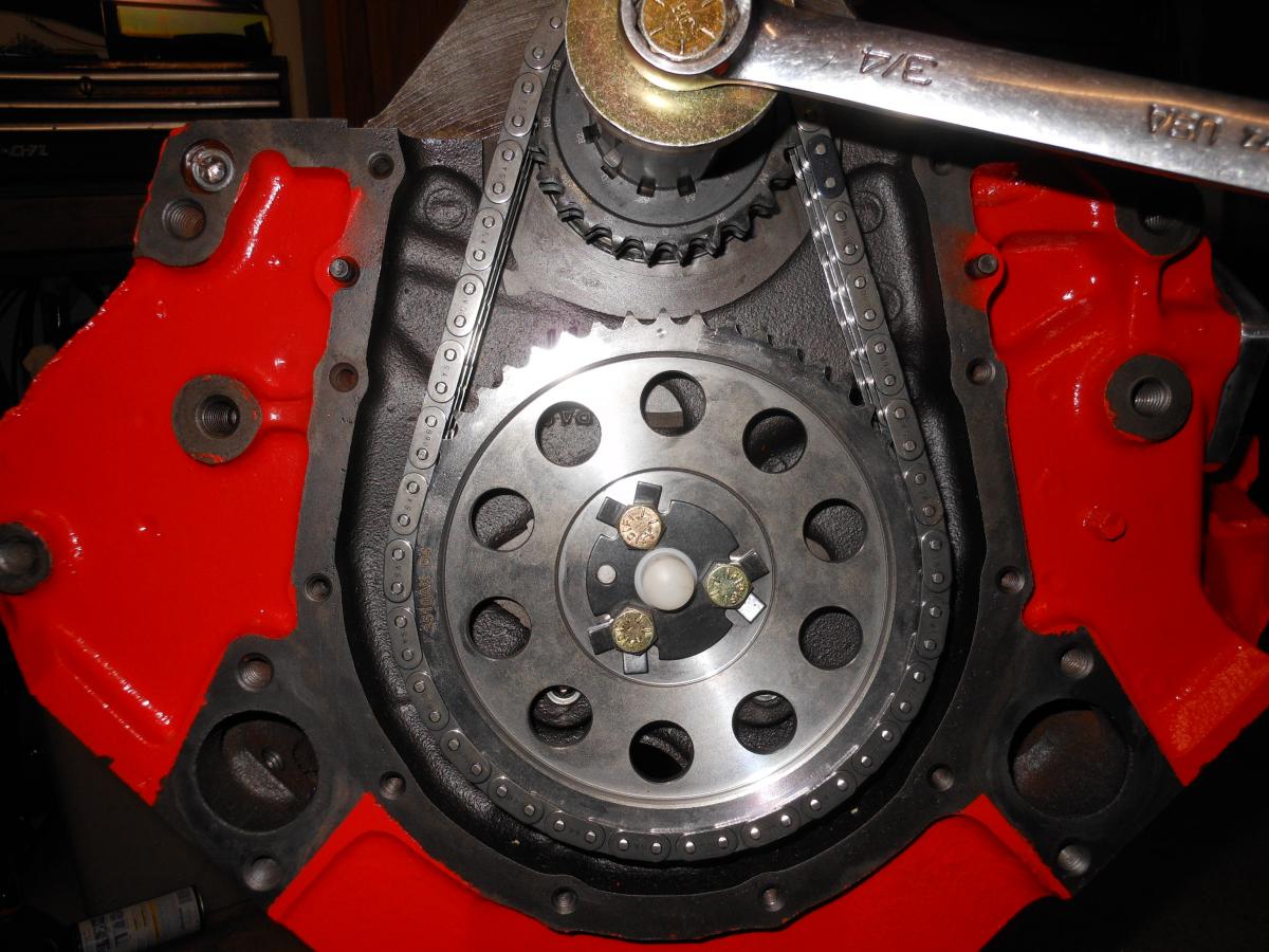

GatorDog72 Posted February 26, 2015 Author Share Posted February 26, 2015 Sam- I will definitely have to degree the cam. I do have an adjustable cam gear in 4 degree increments. If its within a couple degrees, i'm just going to leave it alone. This will be a learning experience as I have never done this procedure before. I watched a few videos on youtube on how to do it. So far I ordered a moroso pro wheel, its the largest degree wheel I could find. Also a comp cams dial indicator with magnetic base. My engine uses solid lifters, so i'm all set there. Any advice is very much appreciated! So far I have learned a lot. I have had lots of engines apart before but I have never done anything close to this build. Quote Link to comment Share on other sites More sharing options...

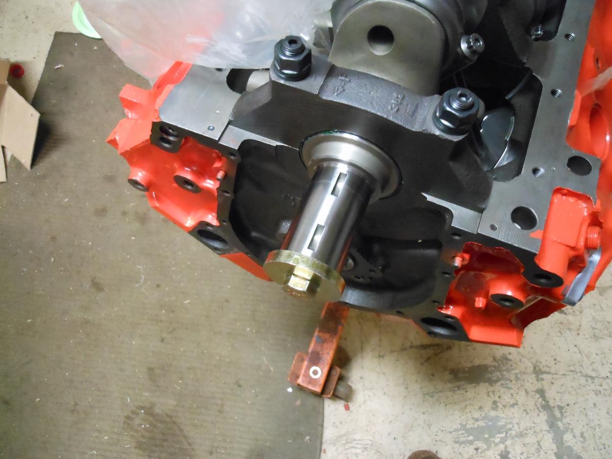

Its Just Me Posted February 27, 2015 Share Posted February 27, 2015 If you don't have a crank socket by now... get one. It makes life sooooo much easier when it comes to rotating the engine precisely while degreeing the cam. I would NOT, NOT, NOT buy the proform aluminum socket #67492. You can read my review on summit website (Scott from WI). I highly recommend the STEEL moroso socket , tho I see summit doesn't have it listed anymore. Be sure to get a socket that will clamp your Pro Wheel to it. Also be aware that not all degree wheels are the same. Some will be indexed 0-90 degrees, some 0-180 and some 0-360. Just be aware of what your indexing is vs. what the instruction video is referring to. This may not make sense right now, but when you begin degreeing, it will become clear (hopefully). The Pro Wheel looks like a nice set-up and clearly marked as to what the valves should be doing and when. Nice build. You seem to be on the right track, grasshopper. I can't wait to hear how it runs. Scott Quote Link to comment Share on other sites More sharing options...
Its Just Me Posted March 1, 2015 Share Posted March 1, 2015 Found it...The summit part number for the Moroso crank socket is #61756 http://www.summitracing.com/parts/mor-61756 Scott Quote Link to comment Share on other sites More sharing options...

GatorDog72 Posted March 5, 2015 Author Share Posted March 5, 2015 Scott- thanks for the heads up on the crank socket! I ordered it, just waiting for it to arrive now. I also received some other parts earlier this week. I decided I wanted to run a rocker stud girdle. I was told that it was a good idea to use one with a solid roller cam. I assembled one of the heads with all the hardware, rockers, etc. with the girdle attached to make sure everything would clear, and now my valve covers hit. I have the tall Moroso stamped steel covers and they need about another 1/8" to clear the girdle. I will have to send these back and get different ones... anyone running a stud girdle know of a set of covers that will fit? As far as the head studs go, I just bought the 8 longer studs I needed. The only ones that are different are the holes next to the exhaust ports, they are 1" longer than stock height. Once that crank socket gets here, I can get the cam dialed in and move on to putting this thing together. Hopefully we will hear it run in the next few weeks. Quote Link to comment Share on other sites More sharing options...
GatorDog72 Posted March 8, 2015 Author Share Posted March 8, 2015 The crank socket arrived last week and I finished setting up my cam over the weekend. At first when I watched the videos I thought this was going to be complicated. Its actually very easy once you get started. The whole process took about 45 minutes and now I know for sure where my cam is at. I forgot to buy a piston stop to find "true" TDC, but I was able to find it with the dial indicator with pretty good accuracy. After I found TDC, I zeroed my degree wheel on the pointer. (I bent up a piece of solder wire and wrapped it around a water pump bolt.) I carefully set up my dial indicator on the edge of the intake lifter and zeroed it. (Make sure the cam is on its base circle, I screwed this up at first.) At .015" lobe lift, the degree wheel should read 37 degrees. If I read my cam card correctly, it says my cam was cut 4 degrees advanced from the factory. I wanted to install the cam with a little advance anyway for more torque. After installing the cam in the "straight up" position, it checked out perfectly 4 degrees advanced. I went through the entire process again to check it and got the same result within 1/4 degree. Hopefully, I didn't screw anything up! (Don't bump into your pointer like I did and have to start all over!) I will update again soon, 1 step closer to done! Quote Link to comment Share on other sites More sharing options...
