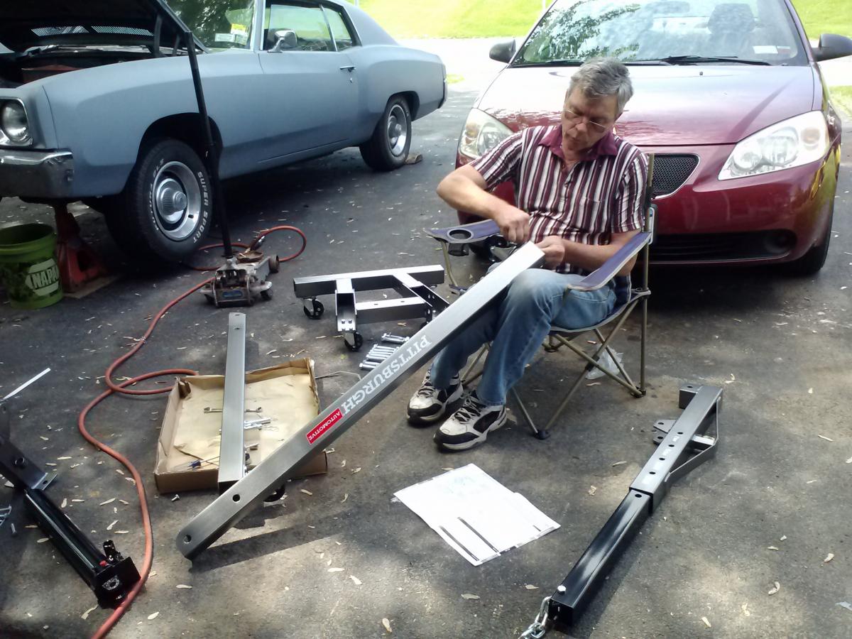

GatorDog72 Posted May 25, 2015 Author Share Posted May 25, 2015 I got to ripping and tearing on the car this morning and made a lot of progress. I figured I would start with the removing the motor/trans and do the rear end after. First thing I did was remove the exhaust. It must have been apart recently because the bolts looked like new and it separated without having to use a torch. After that I removed the drive shaft and took off the speedo cable. Once the transmission mount was unbolted and all the fluids drained, I lowered the car down off the jack stands and unhooked everything up top. Meanwhile, my father was assembling our new engine hoist. The engine and transmission are ready to come out, but I have to take off the front bumper, grille, and radiator core support because the boom on the hoist wont reach in far enough lol. These Montes definitely have a nose on them for sure! Everything that's in the grass in the picture is for sale except the aluminum radiator. Here's some more pics! Quote Link to comment Share on other sites More sharing options...

dbreese Posted May 26, 2015 Share Posted May 26, 2015 Hey Ryan, I was able to R&R my engine by just removing the shroud and radiator. What I did was removed the right side tire and supported the lower control arm with jackstand. I was able to slide the engine lift in with the legs straddling the jackstand. I didn't even remove the hood. Now if you are pulling the transmission/engine together you will probable need to remove the hood. Going from the side may save you a teardown of the front clip. Just a suggestion. Car is looking good!!! David Quote Link to comment Share on other sites More sharing options...
GatorDog72 Posted May 26, 2015 Author Share Posted May 26, 2015 Motor is out! Took the fender off and that gave me plenty of room to get the hoist in close enough. Now it looks like I have quite a large mess to clean up in my engine bay. Of course I found some minor rust issues...nothing critical, but I'm glad I found it so I can repair it before it gets too bad. I think I'm going to finish removing the front clip so I can paint up the frame and some of the rusty parts before the new engine and transmission go in. Also found some spots of the original gulf green paint. I think I would like to repaint the car the original color at some point. Quote Link to comment Share on other sites More sharing options...
