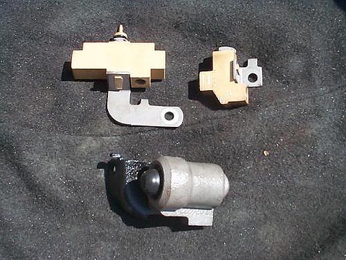

I have a 1970 MC that has factory front disc brakes and factory rear drums.  I purchased a number of brake system parts from Inline tube to replace factory parts,  I successfully removed and replaced the booster and master cylinder. I also replaced a valve (PR-115) referred to as a hold off valve that attaches to one of the bolts on the booster and a distribution block that attaches to the driver's side of the frame.
They also sold me another hold off valve  (PR 104D) that I cannot seem to figure out where it attaches.  Anyone have an idea or picture where it goes?

I still am unable to find that valve. I traced the brake line all the way back to the rear after it leaves the proportioning valve (top left device in the 3 device pix above) and do not find it. I specifically focused on the drivers side near the cross member (around where the driver's door is). Could my 70 not have had that part?
It made not have that valve, does it feel like the hard line goes right into a rubber line? You are in the right area where the valve should be on the rear cross member that the upper control arms for the rear end mount to. I know my 70 Monte doesn't have that valve as I taken the line lose at that spot to suck the brake fluid to that point in the brake system.
