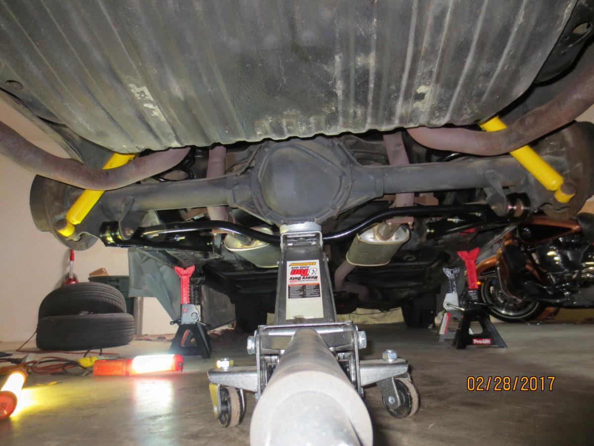

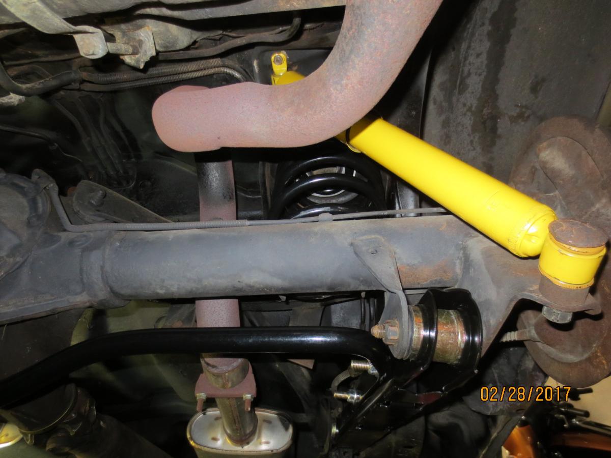

I ended up getting all my stuff except my new tires Friday and started on my rear end upgrade. Got 2 15X8" with the 5" offset rallies, the Moog cargo springs, 1' spacers, boxed trailing arms, new shocks and a UPI 1" anti sway bar kit. Had a hell of a time removing the upper shock bolts as I posted with help and guidance needed on those but got it all done tonight, I'm just waiting for my Cooper GT Cobras to arrive to get them mounted and drop her down.... here are some photos of the job. Will post some when I mount the tires and drop her.

Wow, Mike, you made a lot of changes in a short period of time - should tighten up your rear suspension a lot.  How difficult was it to remove the upper control links and replace the bushings?  I neglected to do that when I installed my rear sway bar so I have no experience to relate to.  Thanks.

Hey Dennis thanks,
I bought the rubber replacements bushings in thought to do them also but they looked in good shape, not cracked or dry so I figured I would leave that project for when I have the rear end pulled to install a posi in the near future.... trying to find a friend with a lift for that project..  :2beers:
