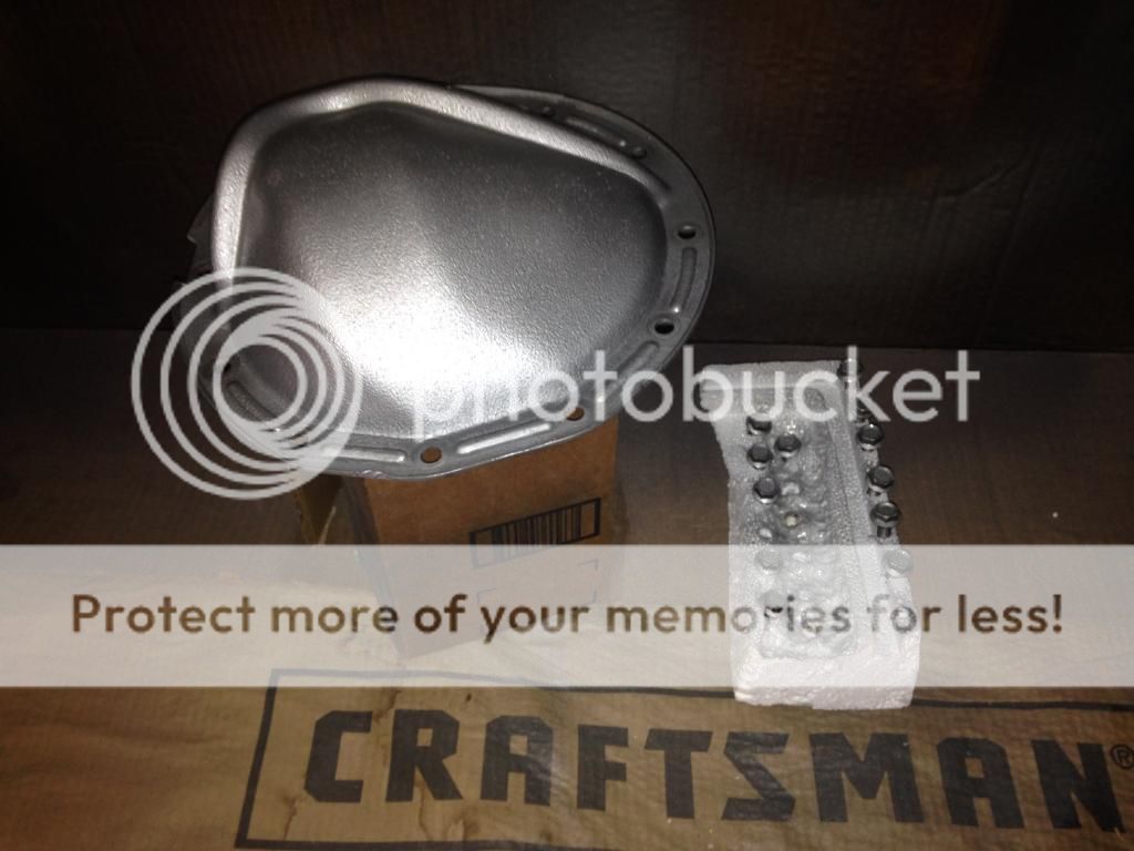

1970MonteCarloNH Posted April 13, 2017 Share Posted April 13, 2017 Hey guy , just check to see how some of you have restored 12 bolt housings ? Should I have it sand blasted ? Wire wheel ? Paint ? Por15 ? Link to comment Share on other sites More sharing options...
MCfan Posted April 13, 2017 Share Posted April 13, 2017 Hey, Phil, I think this a common area of customization, especially the rear gear cover, so you see a lot of different treatments including chrome. When I replaced the rear wheel bearings in my '70, I applied a fresh coat of Seymour's Cast Blast to the gear cover and prefer that look to black. Here's a list of restoration finishes and paint colors that shows the rear axle assembly as painted semi-gloss black: Underhood Detailing: Frame and upper/lower control arms and upper shafts = semi-gloss blackFront coil springs = gloss black or natural (better detail contrast)Firewall, inner fenders, radiator support = semi-gloss blackRadiator and fan = gloss blackFan clutch = natural aluminumRadiator shroud = natural black plastic or gloss blackSteering box = natural cast iron graySteering linkage = natural steelFront sway bar = natural cast iron grayHeater or AC housing = semigloss blackHood hinges, latch, catch and springs = gray phosphate platedBrackets and steel pulleys = semi-gloss or gloss black (gloss gives more detail contrast)Cast iron pulleys = natural cast ironMaster cylinder = natural cast iron (some use gloss black)Brake booster = gold cadmium plated (master cylinder lid also)Windshield wiper motor = gloss blackAlternator = natural aluminumPower steering pump = gloss blackAC compressor = semi-gloss blackSteering column shaft = natural steelHorns = gloss blackCoil = gloss blackVoltage regulator = gloss blackDistributor = natural aluminum with gloss black capFuel and brake lines = natural steel Undercarriage Details: Transmission = natural aluminumBellhousing = natural aluminumTransmission support = semi-gloss blackDriveshaft = natural steelRear axle = semi-gloss blackRear swaybar = semi-gloss blackRear coil springs = gloss blackRear control arms = semi-gloss blackGas tank = natural steel (shiny)Gas tank straps = gloss blackParking brake cables = natural steel 1 Link to comment Share on other sites More sharing options...
