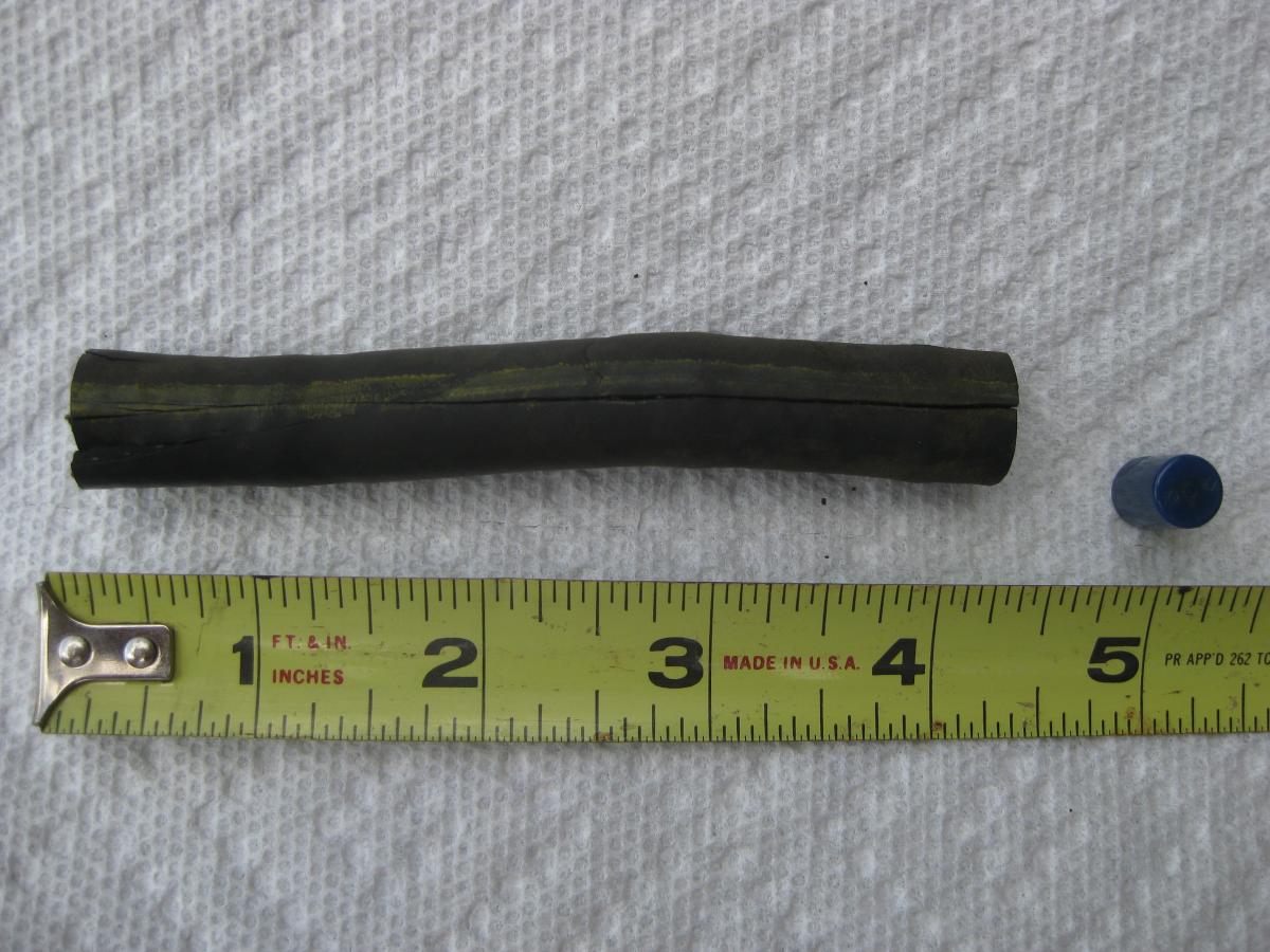

stangeba Posted September 10, 2017 Share Posted September 10, 2017 I replaced all the hoses on my 71. There was a "hidden" restricter in one of the hoses at the tank. Here are some pics: 1 Quote Link to comment Share on other sites More sharing options...

Paul Bell Posted September 10, 2017 Share Posted September 10, 2017 I replaced all the hoses on my 71. There was a "hidden" restricter in one of the hoses at the tank. Â Which hose was it in? Quote Link to comment Share on other sites More sharing options...
stangeba Posted September 10, 2017 Share Posted September 10, 2017 Paul, I believe it was in the vent hose as shown in the drawing, there is a mark on the hose in the drawing but NOT on the real hose where I found it. I almost threw it out but saw a bulge and cut the hose open o find the small plastic plug with a small hole in the center of it. I wonder how many of them got thrown out!!!!!!!!! I still have the full entire evaporative emission system, many have been removed. Bruce Quote Link to comment Share on other sites More sharing options...
Paul Bell Posted September 10, 2017 Share Posted September 10, 2017 Very interesting. I suppose that would allow vapors to seep through slowly. Quote Link to comment Share on other sites More sharing options...
stangeba Posted September 10, 2017 Share Posted September 10, 2017 Paul, I don't know but my 71 (today after a 30 mile drive) smells up my garage like crazy. I believe it is all coming from the stock Qudrajet carb. Bruce Quote Link to comment Share on other sites More sharing options...
