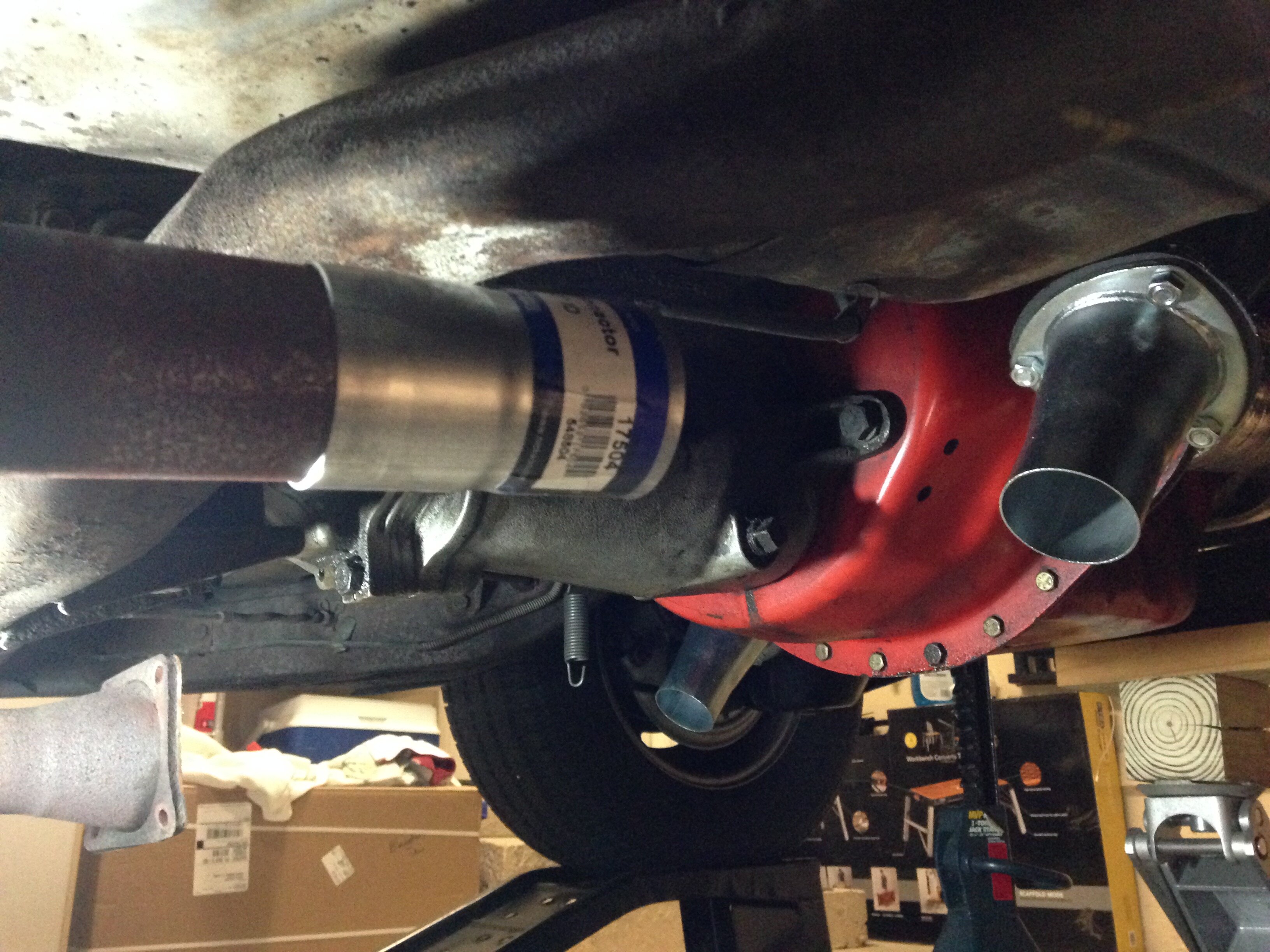

Hey Mike, I'm using two. I had tried the 1 spring method but didn't care for the feel plus I wanted to insure the adjustment rod from the fork was always snug. Here's a photo I have of current setup before the headers went on, the 2nd spring (not shown) went from Z-bar to the frame as shown in the photo from the manual. Good Luck!

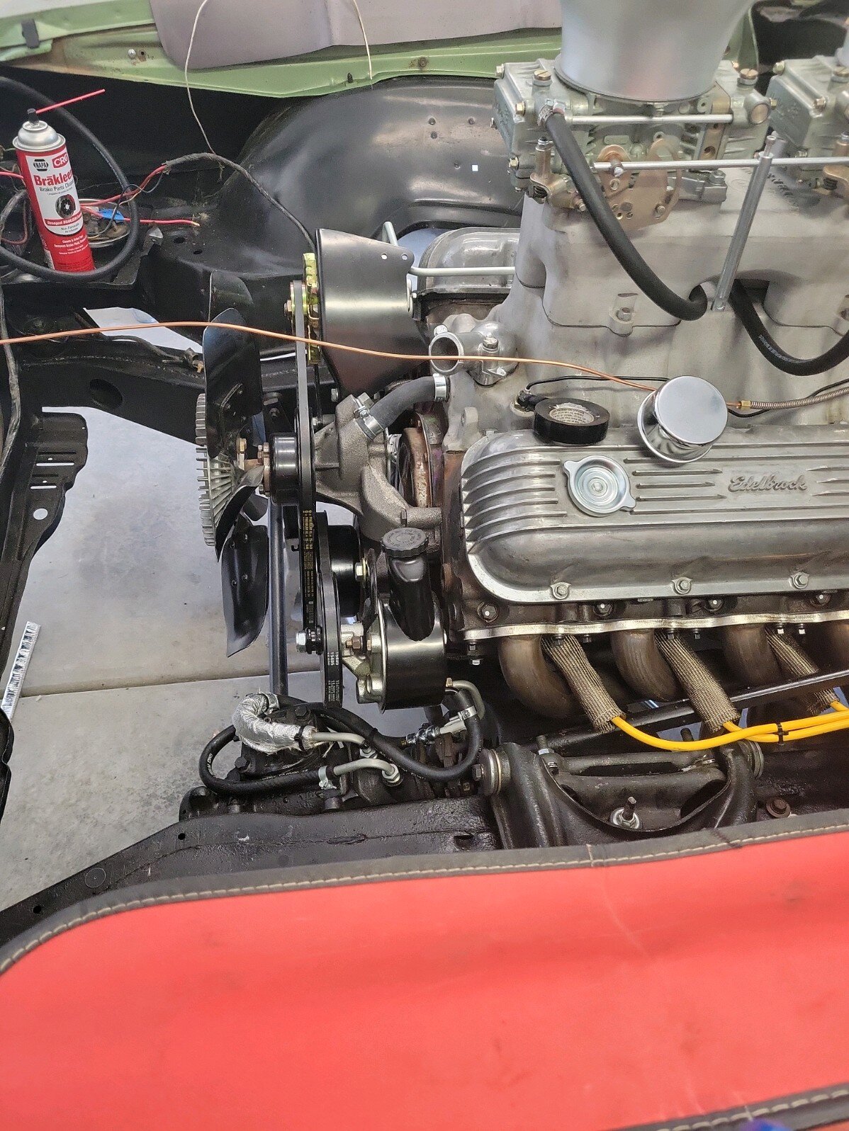

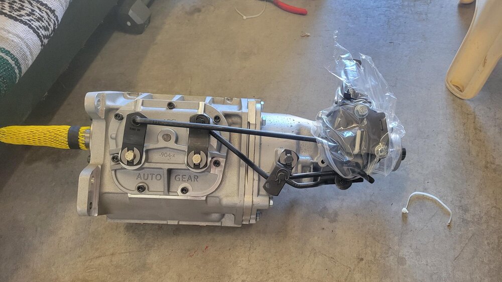

Good morning,  does the spring ride against the headers with the bracket in place? Do you have a picture of yours?  I just got my M23 installed, and ordered the return spring bracket, adjuster, and spring from the parts place.   The conversion kit I received was for a chevelle and a few of the parts did not work. I have the Americans bolted to my LS-7, but am not seeing a unimpeded line to the frame for the spring.

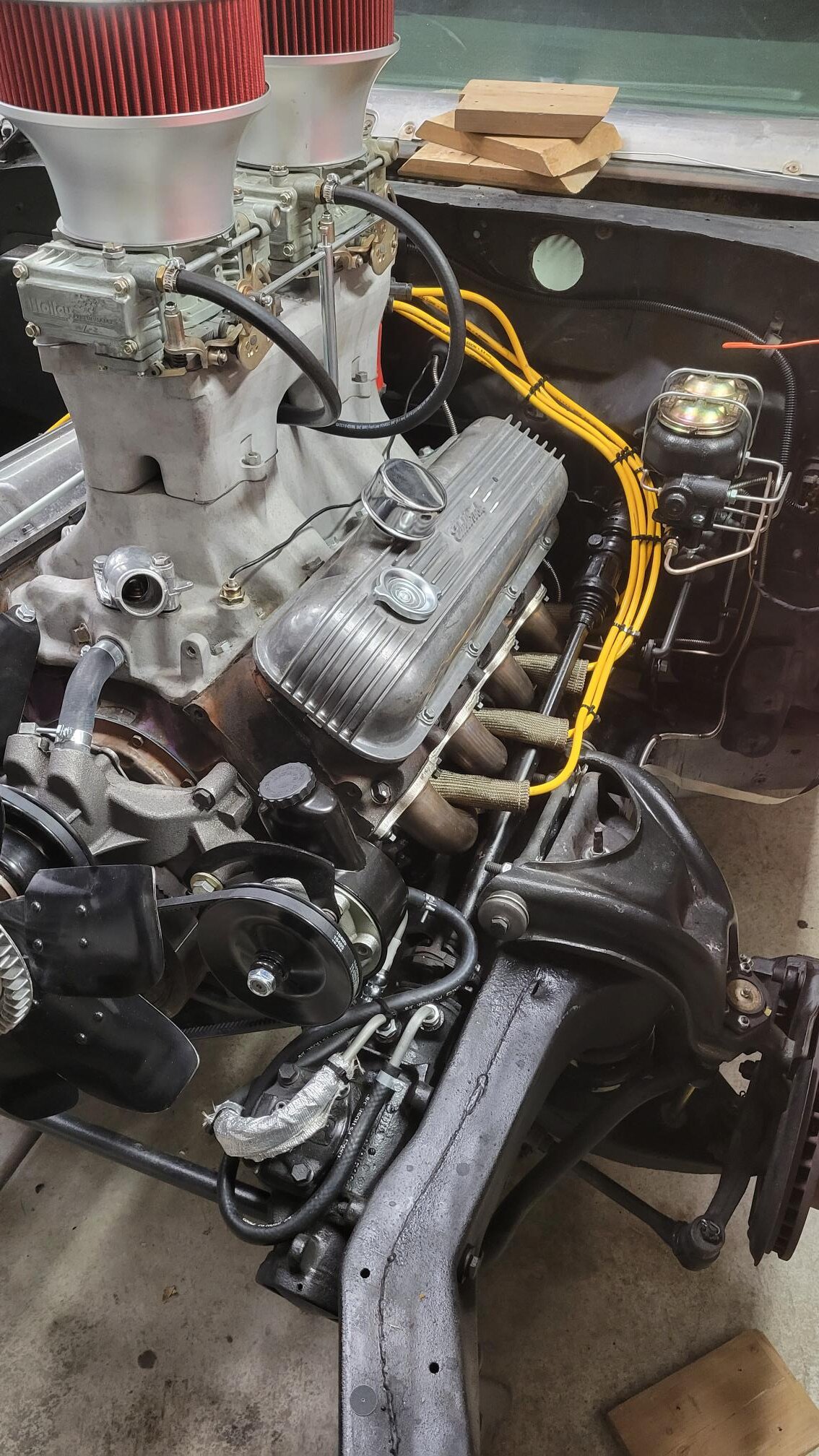

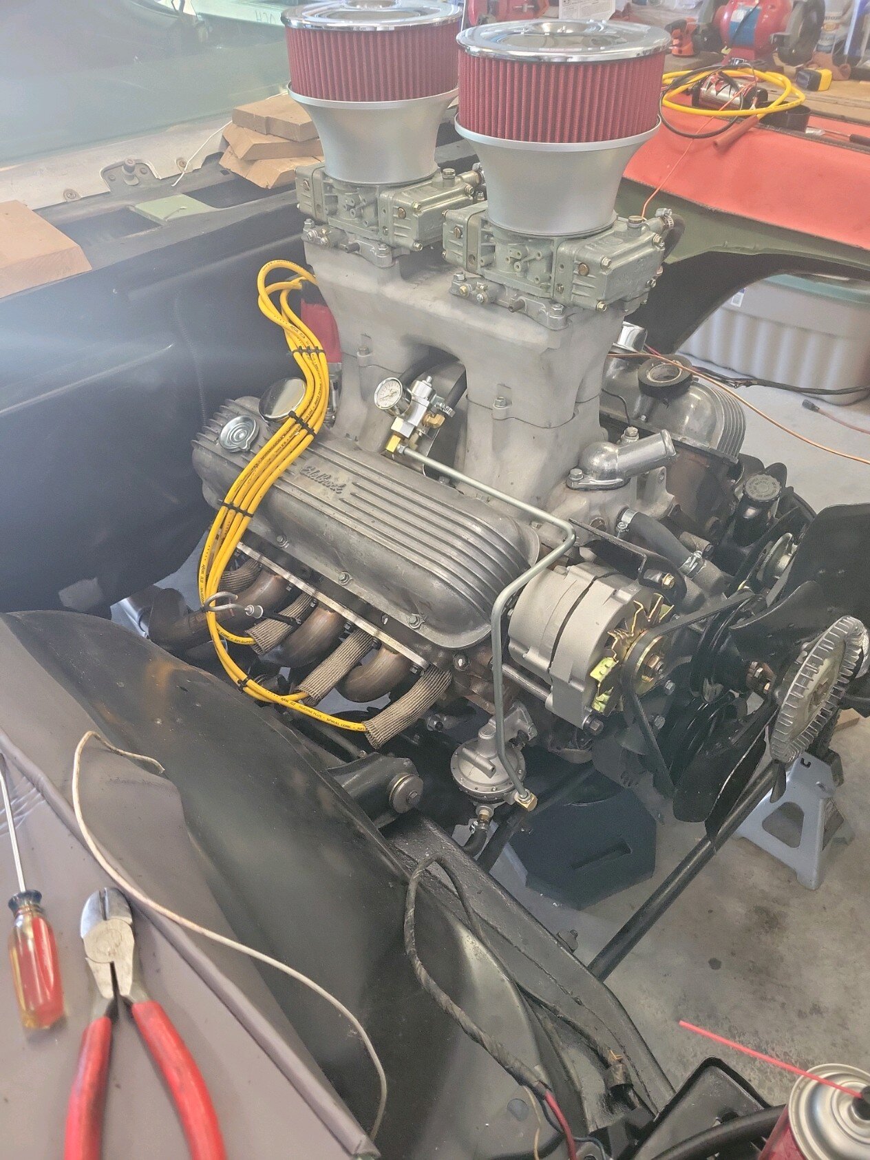

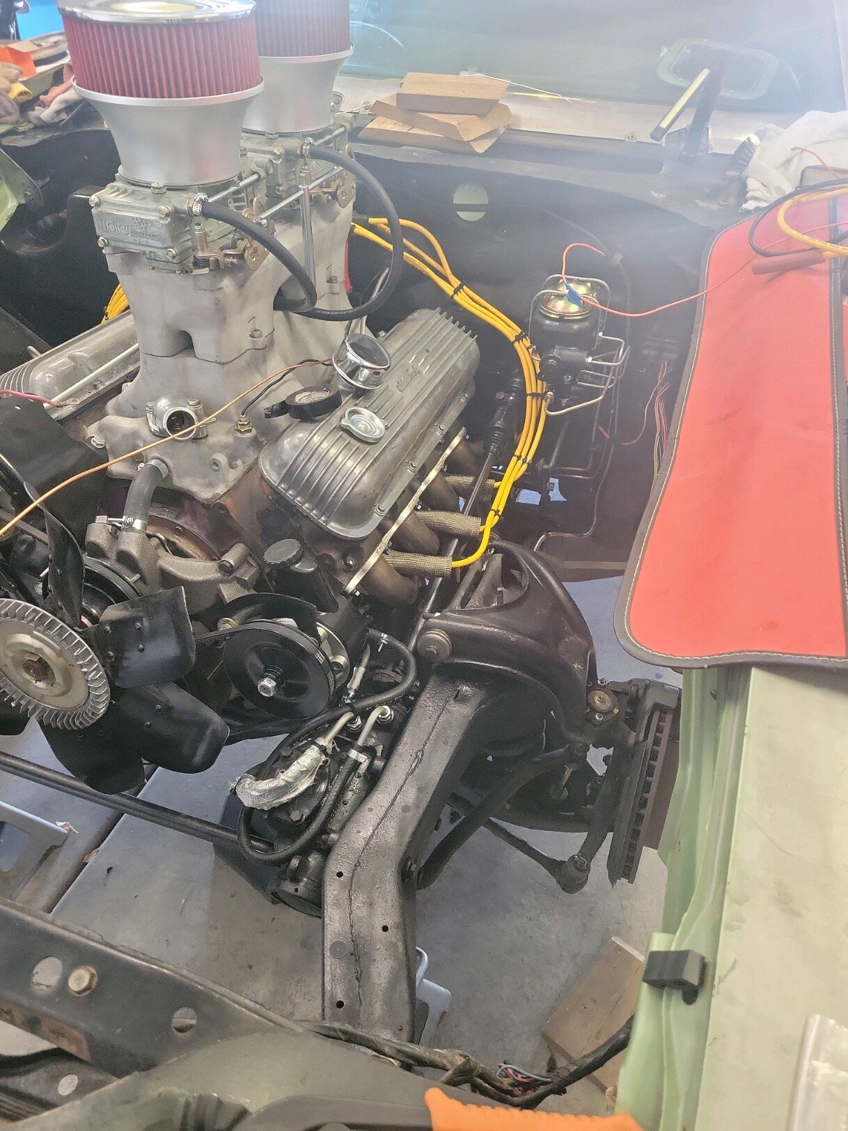

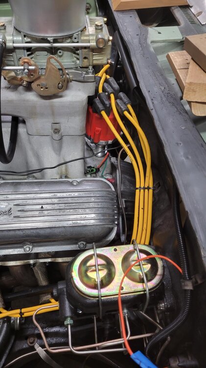

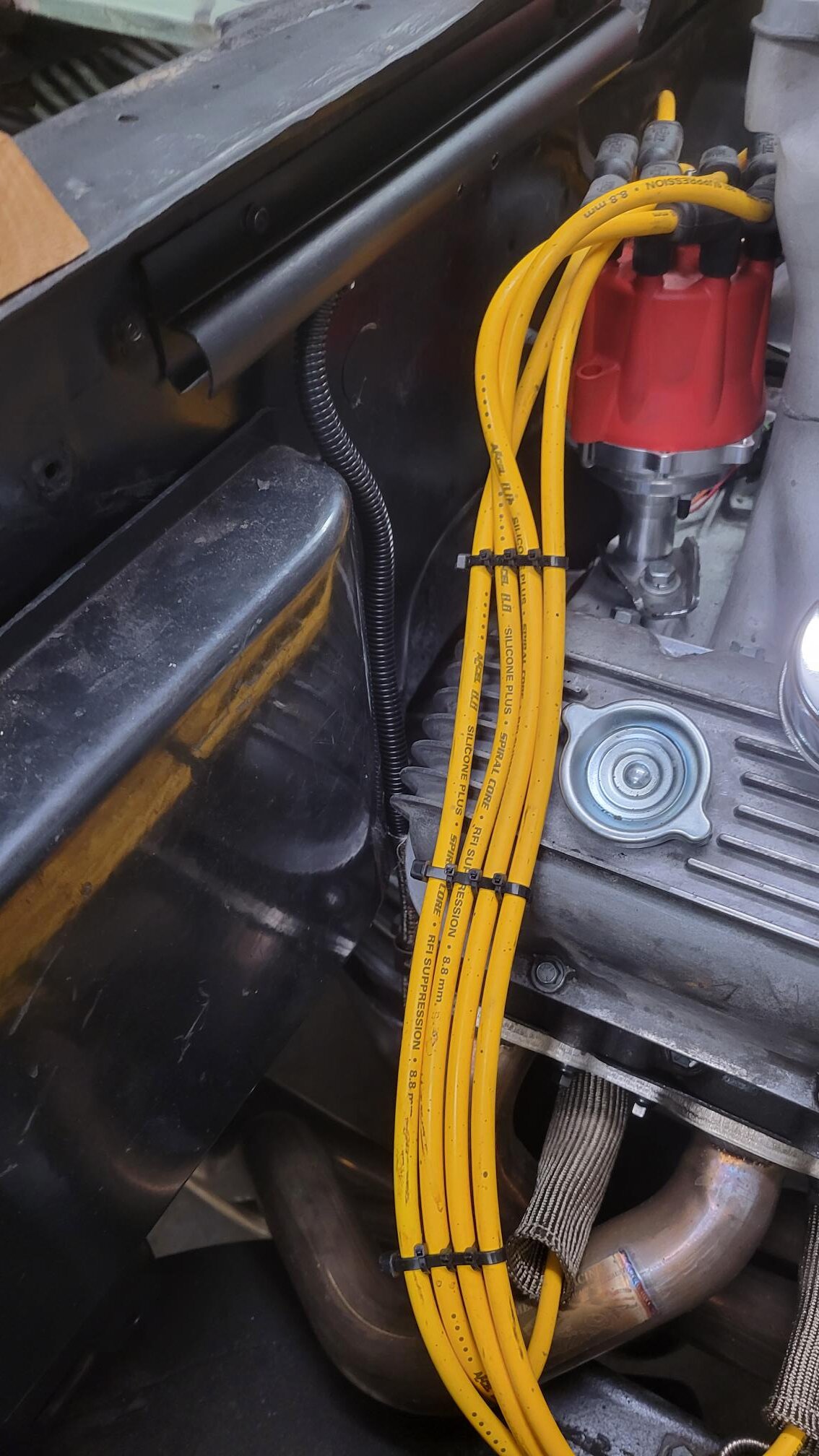

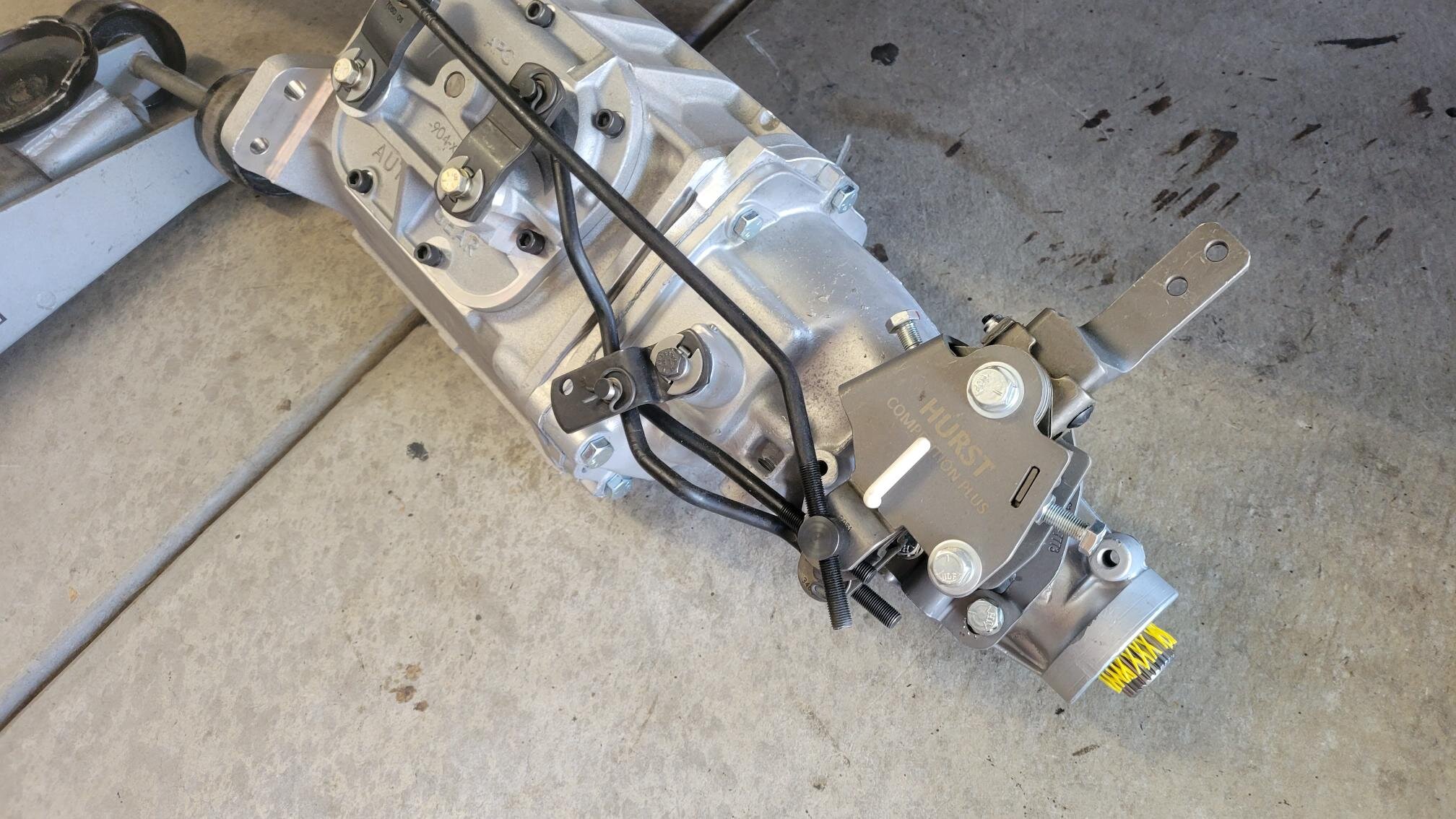

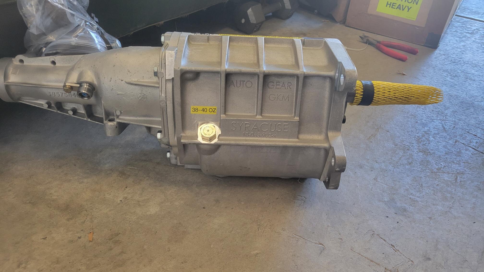

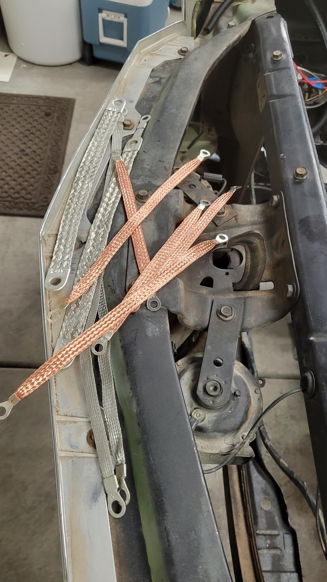

A few pictures of the 4 speed conversion - really more of a before and after and a few of some progress as it seems I'm doing noting but little projects within the larger ones ha.   Oil pressure sending unit plumbed, starter solenoid wire routed, clamped and heat shielded, Zbar in place, trans crossmember installed. Need to finish up with the correct return spring and linkage, Acquire and run the battery cables, decide where to mount the coil, decide which ground straps and where it install,  then reinstall the wheel liner, and shroud/rad etc.   Its a lot more fun when you dont have to drive it to work on monday ha

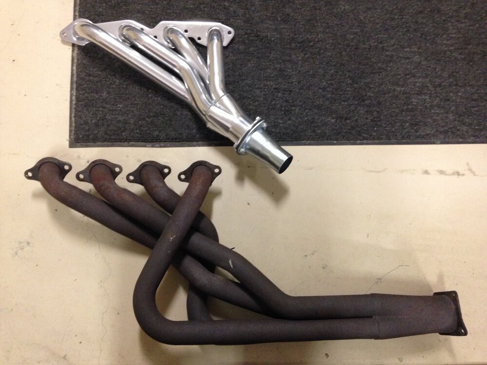

Hey, Mike,
When I replaced my old rusty full-length headers (that had been severely massaged to fit years ago) I was unable to find any direct replacement for a big block first gen Monte with a manual transmission.  There are numerous full-length headers for big block Montes with automatics but their #7 tube sweeps back into the space where the clutch Z bar operates.  Consequently, I chose to go with the Patriot "shorty" header that comes down and exits at a 45 degree angle.
I am not where I can look at my car right now but I am certain there was no interference with the new headers and the clutch arm return spring.  I checked my project photos and only show that spring hanging down during the installation of the new headers (see below).
Since that spring was formerly connected to a washer welded to the old full-length headers (rather than the hole in the frame), I am wondering if you might have to do something similar with your new headers? You may even have to substitute a completely different length and power of spring in order to connect it to an alternate location that will work.  Good luck.

Hi Dennis, thanks for the reply. I have the american racing headers, and do not as of yet have the proper spring and bracket. The clutch itself does most of the return pressure, and I guess I just need a decent spring for the fork/linkage to stay in contact.  The springs that I have I believe are Chevelle springs and way too long. Will see what the parts place delivers and how they differ - will provide pics if they are.
3 hours ago, Montemedic said:
Old school tunnel ram. I love it !!!
Yup, its an Offenhauser from back in the day ( I actually have 2 of them), and a couple of NOS 660 center squirters I found. Both the engine builder, and Steve Brule were impressed with the throttle response.

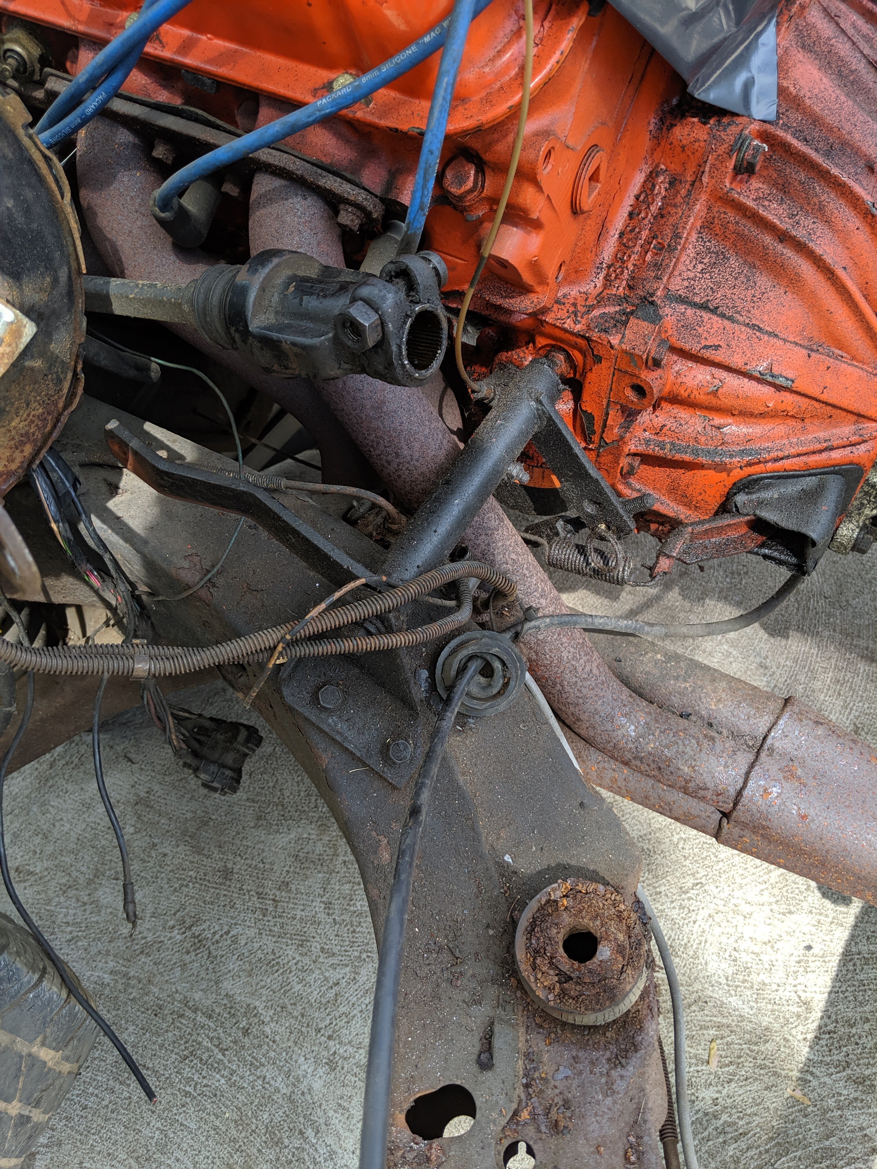

Here is a pic of when we removed the body from our 71 402 4speed with hooker comp headers. No massaging on these.
That pic helps a lot. It looks like the frame end of the spring is really long.
