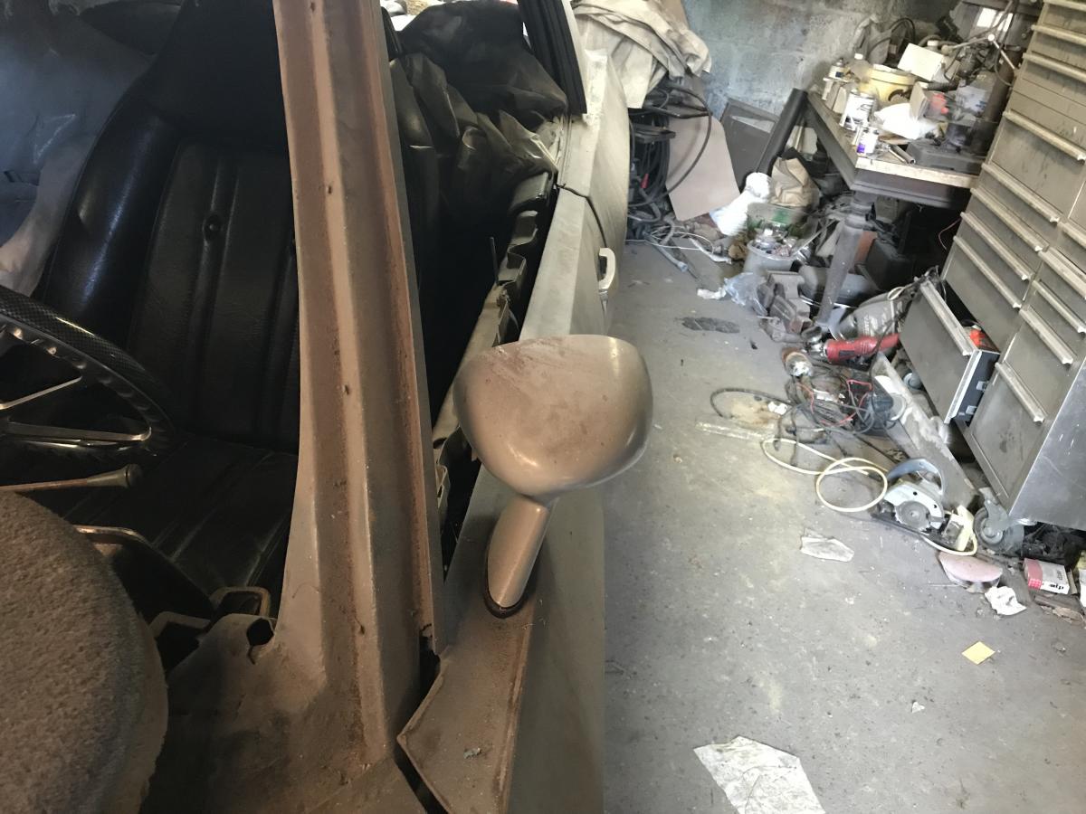

monte70car Posted November 11, 2017 Share Posted November 11, 2017 Jeffery the difference is in the gasket. I have the Year one mounted on the door. The Monte gasket is a little thicker on one side then then the other where the Chevelle gasket is the same thickness. Most Chevelle parts will work on our Monte's as its the same design just a little tweak. Next time I'm out in the shop I'll grab a couple of pictures of the mirror. I know a few years back OPGI had the same mirror kit, but now they only have the left side which makes me think the right side couldn't be made https://www.opgi.com/monte-carlo/1971/mirrors-hardware/outside-mirrors/CH27054/ If you compare the OPGI and the Year One mirror you'll see they are the same. Link to comment Share on other sites More sharing options...
monte70car Posted November 11, 2017 Share Posted November 11, 2017 Here are the pictures for the Year One mirror. Link to comment Share on other sites More sharing options...
