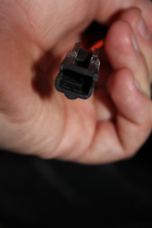

I have a really nice colored wiring diagram that shows my monte carlo is "possibly" equipped with a trunk light. I opened my trunk up and looked inside and traced out all of the wiring. No light bulb or light housing exists that I can see. I did find an orange wire leading to a female connector. The connector is currently connected to nothing. I hooked up a test light to it and it illuminated, so it has 12v at all times. Perhaps this used to plug into the trunk light circuit? I have no idea if all monte carlos came standard with trunk lights or if it was an option? Does anyone have a factory installed one I can see for reference? If my car is supposed to have one, where can I buy one? Thank!

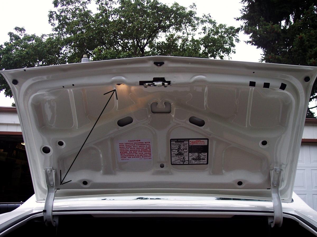

The Trunk Light was an option you could add or was a part of the 72 Custom Package.  The pic shows location of bulb & wiring running from L.H Trunk Lid support.  You can see the wire where it comes off the L/H Trunk Hinge arm into the Trunk Lid.  I can't say if a new one (Kit) is purchable but should be able to locate what you may need without a whole lot of searching.  The build sheet would say if was included.

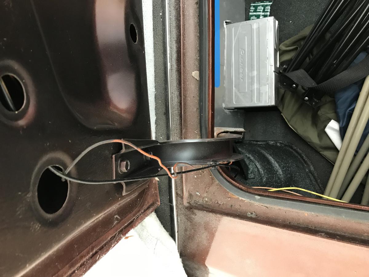

Only picture I have of my 71 trunk light that I added, from the Chevy dealership, soon after I bought the car.

What OPG offers seems to be similar to the first one I linked to above.
I think the two very different units is because one is factory installed and the other is dealer installed and available at the parts counter.

So it's the simpler of the two claimed to be for our cars.
Thanks for the pic Robert. Looks like a ground wire was added?
