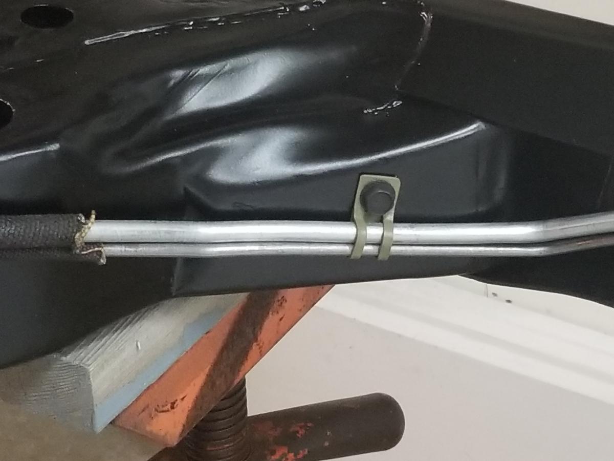

LS5 Posted February 18, 2018 Share Posted February 18, 2018 Looks Great Joe, Right where I was 2 years ago...!!! I did the same thing with the fuel and return line clamps. New bolts but blasted the clamps and repainted. I also have the resonators but didnt install them as of yet, ran the exhaust full through for now. Resonators were on the 70 chevelle that I had though. shoot me an email any time Joe now you have the address. I will follow this post lots........ Great stuff ... Darren Quote Link to comment Share on other sites More sharing options...

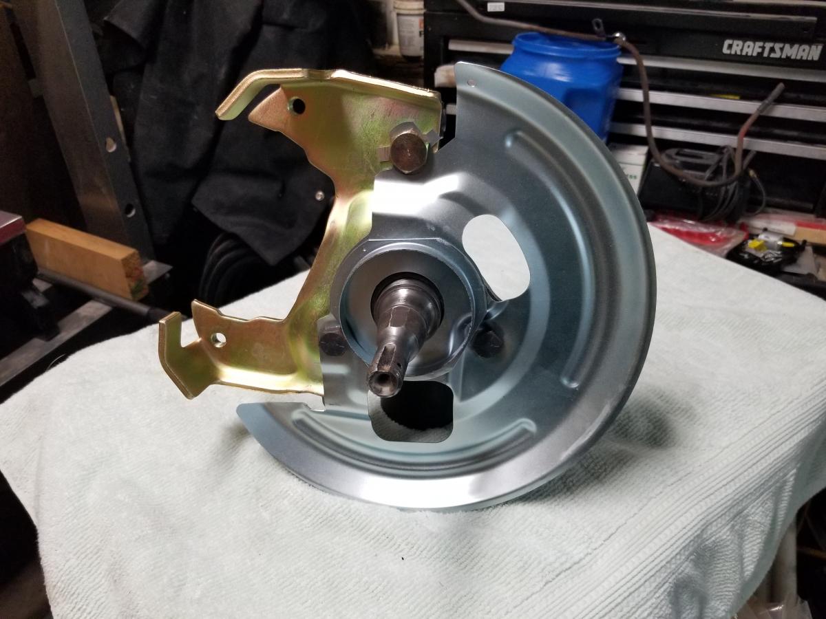

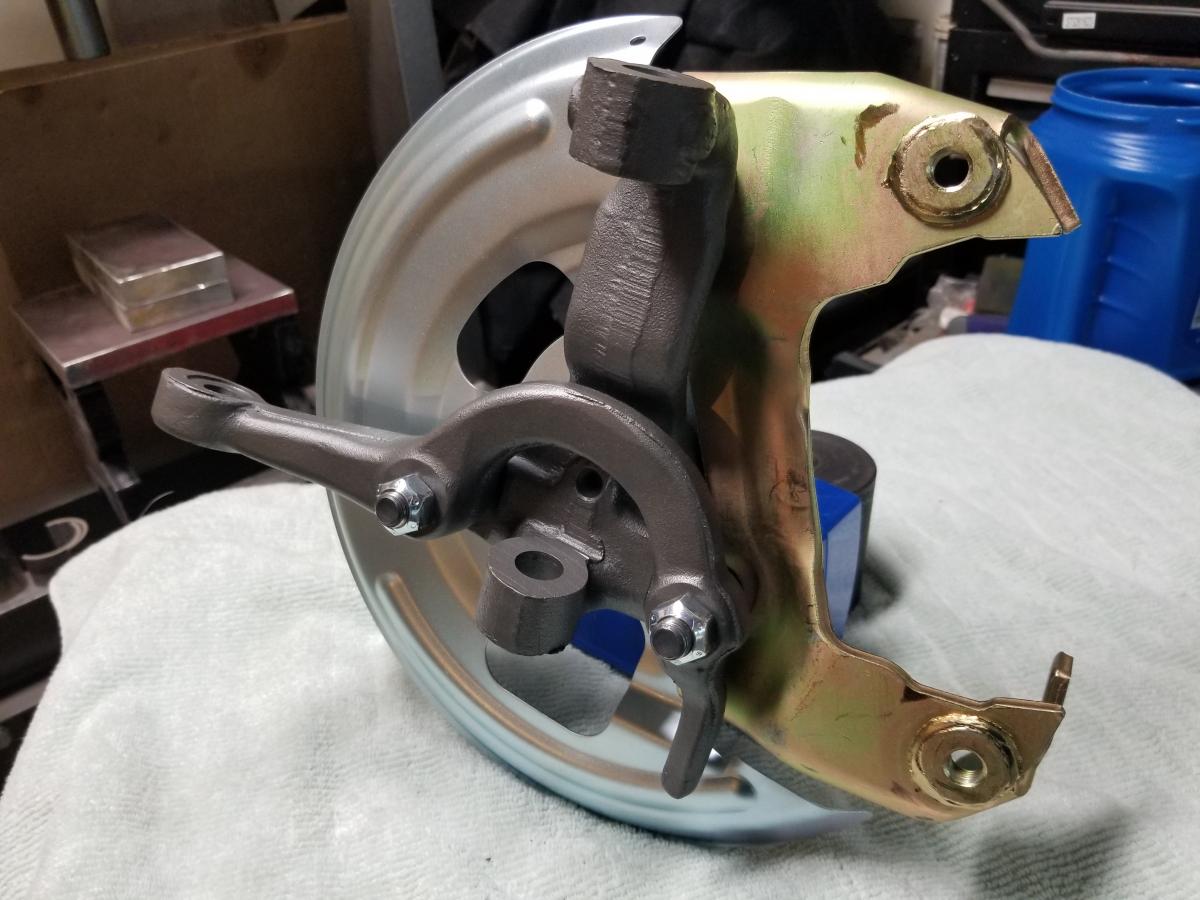

orbit Posted February 18, 2018 Author Share Posted February 18, 2018 Thanks Dan. Just cleaning up the passenger side spindle before blasting and found some paint markings. Hard to see in photo but purple in the middle and on the lower ball joint and white slash on the upper ball joint Quote Link to comment Share on other sites More sharing options...

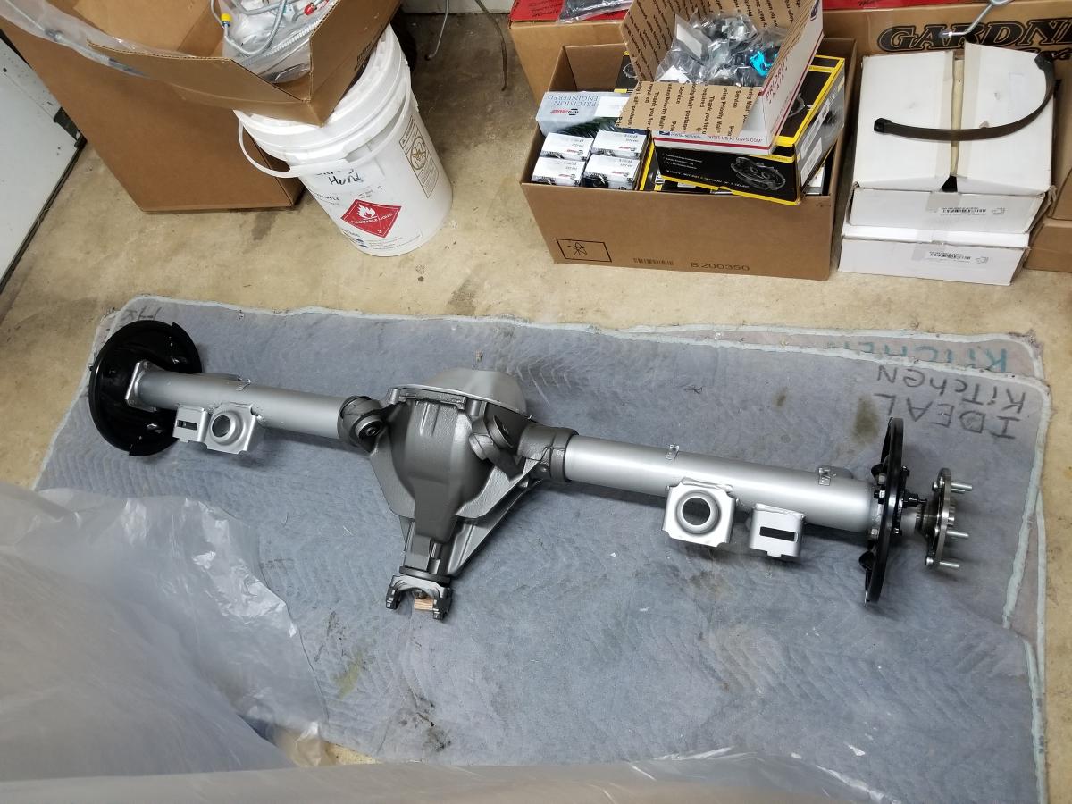

orbit Posted March 5, 2018 Author Share Posted March 5, 2018 I got the rear back today from being rebuilt and powder coated. Not sure about what color to paint the rear cover but assembly starts this week 1 Quote Link to comment Share on other sites More sharing options...

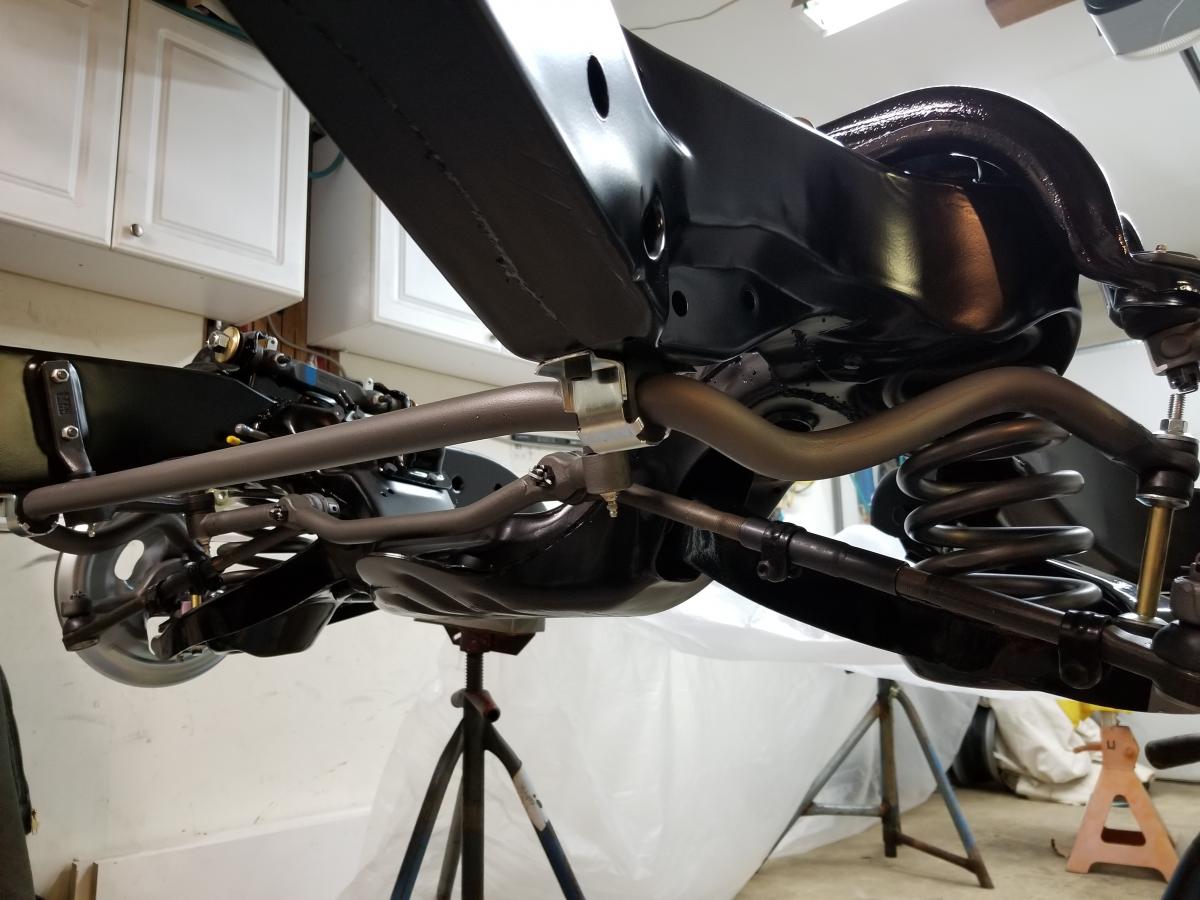

orbit Posted March 7, 2018 Author Share Posted March 7, 2018 Bruce. That is the Gardner Exhaust. Eric Gardner hooked me up. She is all stock except for the 4 speed that I'm putting in it. All GM stuff no aftermarket if I can help it. I kept all the auto stuff so when my Son inherits this car he can put it back if he wants but right now this is how I want it. Gonna get the front suspension installed this weekend. Trans should be back in two weeks and motor back from rebuilder by the end of the month. Should have the rest of the body work done by August and then out for paint. Can't wait to see it in Classis Copper. Should make next season. Thanks Joe 1 Quote Link to comment Share on other sites More sharing options...

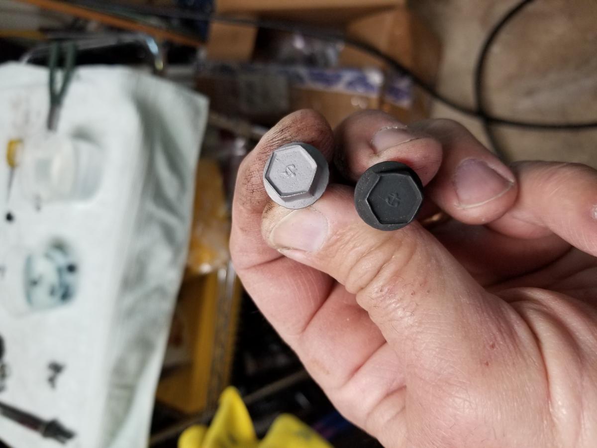

orbit Posted March 10, 2018 Author Share Posted March 10, 2018 I changed the color of the diff cover. Was not happy with the color it was. Found some great stuff for black oxideing the bolts. Stuff is great. Kept my original bump stops for the rear. Just had to clean them up and reuse them as the reproduction ones were not even close. Quote Link to comment Share on other sites More sharing options...

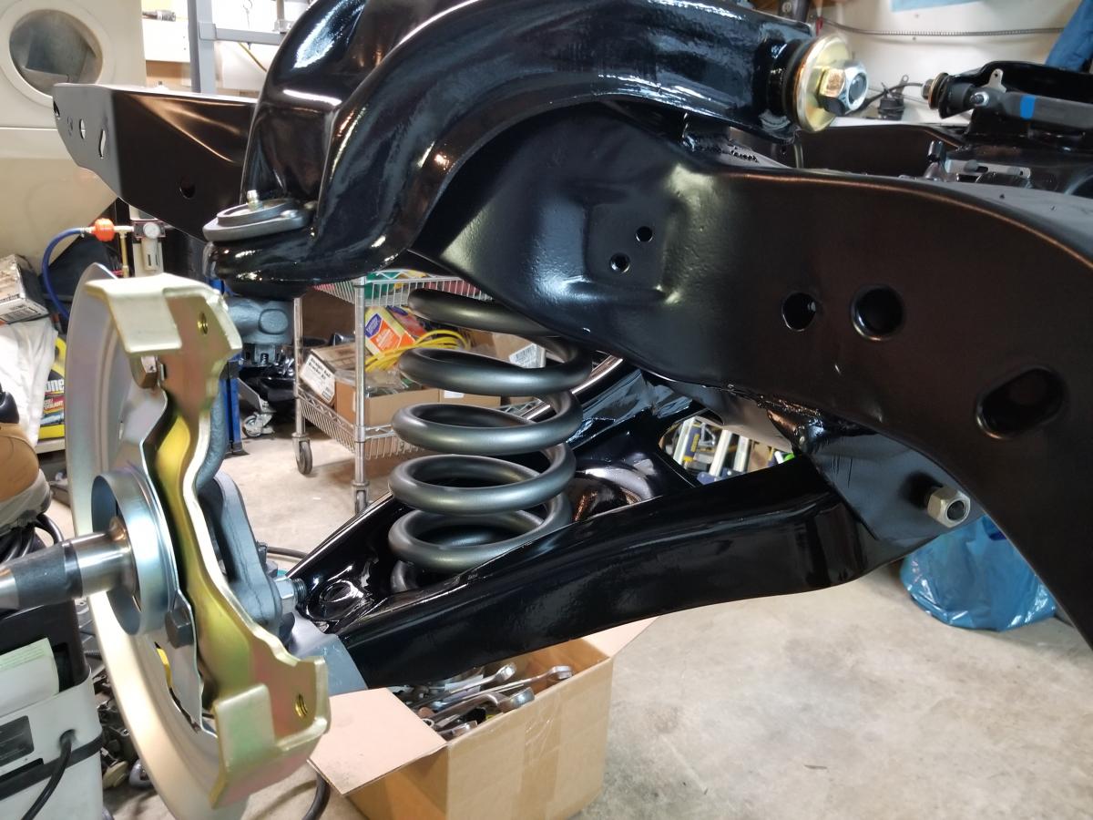

orbit Posted March 11, 2018 Author Share Posted March 11, 2018 Got the first spring installed with no paint damage. Not as easy as one would think Quote Link to comment Share on other sites More sharing options...

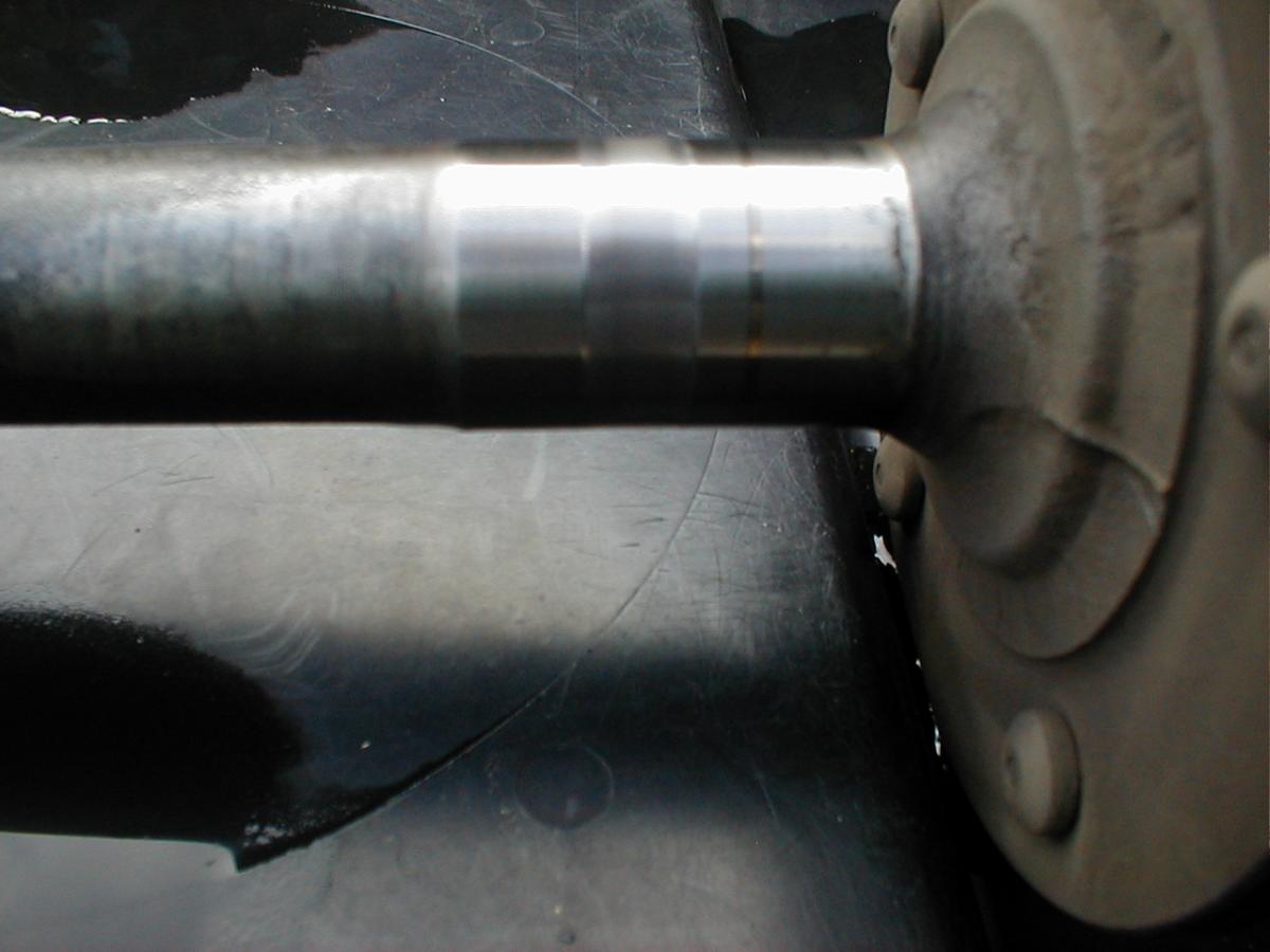

stangeba Posted March 11, 2018 Share Posted March 11, 2018 Joe, and all other members, Looking at your axle reminded me that about 10 years ago when working on a vibration issue, I ran across a fairly deep worn area (where the bearing rides) of my right (passenger side) axle shaft on my 71. (see Picture) I was told to purchase an "off set" axle brg. I did and it took car of this problem. The vibration turned out to be a bad U Joint but I was happy to find and fix this issue also. I was told it is a common problem, not sure if that is true but wanted to pass along this bit of information. I wish I took a pic of the new "off set" bearing, it rides on an area of the axle that isn't worn. Love your car and the quality of work it is receiving. Bruce Quote Link to comment Share on other sites More sharing options...
orbit Posted March 11, 2018 Author Share Posted March 11, 2018 Bruce That's why you see new axels in the rear end. I to had that same issue but while the rear was getting rebuilt I told him to get new axels. Thanks for all your kind words guys. I love this club. You guys are awesome. Joe 1 Quote Link to comment Share on other sites More sharing options...
overdrive Posted March 11, 2018 Share Posted March 11, 2018 Great job! There is a spring installation tool in the chassis service manual for installing the A arm and spring. The manual gives the dimensions for making one. I made one and it worked great, using a floor jack. No damage to the powder coat. Dan Quote Link to comment Share on other sites More sharing options...

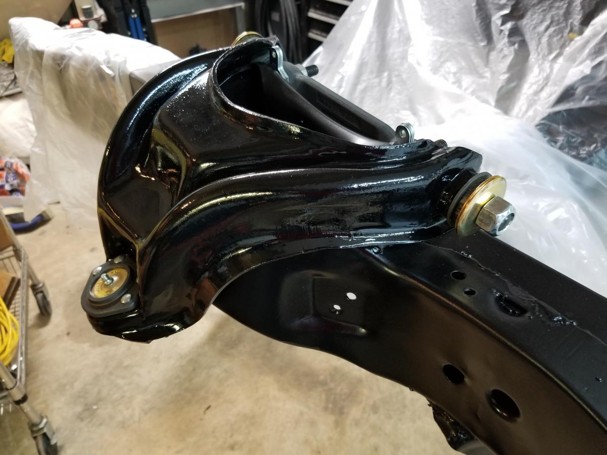

orbit Posted March 14, 2018 Author Share Posted March 14, 2018 A little more work on the front end. 1 Quote Link to comment Share on other sites More sharing options...
