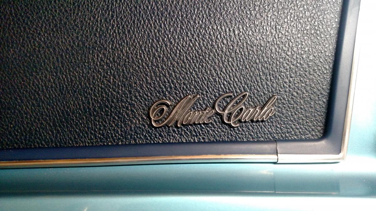

Rare Rat Posted March 24, 2018 Share Posted March 24, 2018 I know the vinyl top trim edge was painted the same color as the top. My question is the correct finish on these parts. Is it a flat or semi-gloss, or a satin finish? 1 Quote Link to comment Share on other sites More sharing options...

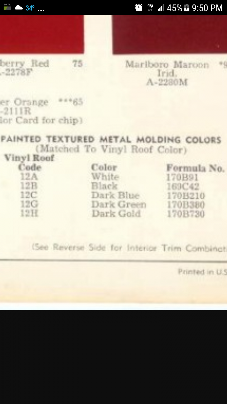

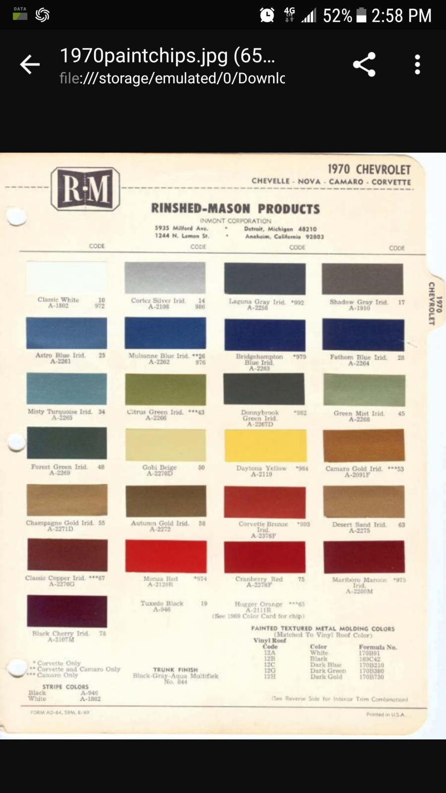

overdrive Posted March 25, 2018 Share Posted March 25, 2018 The paint codes are below. What color is your top? Satin looks good, but the codes should be exact. Dan 1 Quote Link to comment Share on other sites More sharing options...
Paul Bell Posted March 25, 2018 Share Posted March 25, 2018 Who's paint codes are those? I just went with a dark flat color. The real trick is getting it to stick. I see unpainted vinyl break moldings unpainted all the time. I dull sanded the surface, warmed it and applied self etching primer. After cured, warmed it again and applied the final paint. All rattle can. Quote Link to comment Share on other sites More sharing options...
overdrive Posted March 25, 2018 Share Posted March 25, 2018 I see them unpainted alot, but to me, they seem unfinished. It is time well spent to repaint them, in my opinion. They came from the factory painted and they look better that way, I think. The codes are in our technical section. Dan 1 Quote Link to comment Share on other sites More sharing options...
