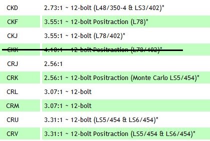

Paul Bell Posted May 24, 2018 Share Posted May 24, 2018 The casting number 3959038 says it's a 12 bolt. For a 1970 car, it can be any of these codes. If you can't find the code, going by original engine and rear ratio will give you the code. Quote Link to comment Share on other sites More sharing options...
John S Posted May 24, 2018 Share Posted May 24, 2018 The casting 3959038 is 1969-1970 Chevelle. However there is no LE code used in those years. In 1969 a two letter code was used, In 1970 a three letter code was used for that year only then it went back to the two letter code. LE simply does not exist in those years. I would try a wire wheel to clean it up and you may be able to make out the original letters. John S Quote Link to comment Share on other sites More sharing options...
