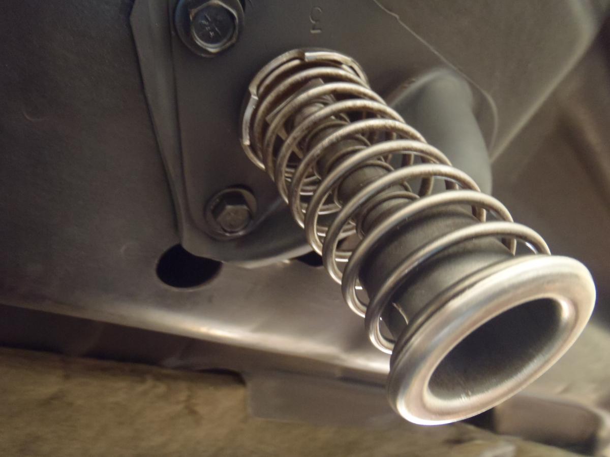

I had a similar problem on my gold/black '70 SS several years ago.  If the latch is not bound due to hood misalignment, the combination of the weight of the hood and the friction of the hood hinges in the closed position may be too great for the external coil spring on the latch plunger to overcome.  Either that or the coil spring is deformed or broken.  Since I did NOT want to lubricate the hood hinges (because the hood barely stays in the up position by itself already), I opted to increase the latch opening spring force by adding a "helper" coil spring inside the original (see photos below).
I just selected a spring from my large collection of compression springs and assembled it on the latch plunger.  It added enough upward force to allow me to get my fingers under the front edge of the hood to lift it all the way.  If your hood is rather stiff to open and stays up easily, you may want to just lubricate the hinges to see if that will allow the hood to pop open a bit when you pull the latch lever.  Good luck.

Dennis where did you get the extra spring? I think mine is getting weak so I would consider adding another one.
Steve, I was just lucky that I already had one that fit and worked well in my collection of compression springs of all sizes that I have accumulated over the years.  If you measure the  outer diameter of the plunger shaft and the inner diameter of the stock coil spring and also measure the compressed length of the spring when the hood is open, you will have everything you need to go to the hardware store and find a workable spring that fits inside the stock spring.  Actually, I wish my helper spring would have been made of a larger diameter wire so it had even more power when fully compressed in the hood closed position.  This lighter spring works fine for now so I stopped looking.  Hope you can find one that works for you.

A punch to the hood was again needed. When checking the spring it seems a bit lazy; needs a patent like Dennis did or replacement with OEM part.

I have had this issue for a long time also ,added an additional spring to the inside of the outside spring bought the springs from grainger,works great now
