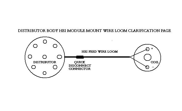

stangeba Posted July 22, 2018 Share Posted July 22, 2018 I downloaded these many years ago and don't know anything about them. Good Luck! This is something about HEI. Quote Link to comment Share on other sites More sharing options...
pinstripebob Posted July 26, 2018 Author Share Posted July 26, 2018 Awesome! Looks like that helps out with the ignition coil wire! Quote Link to comment Share on other sites More sharing options...
