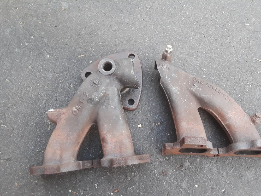

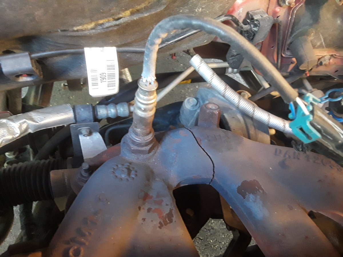

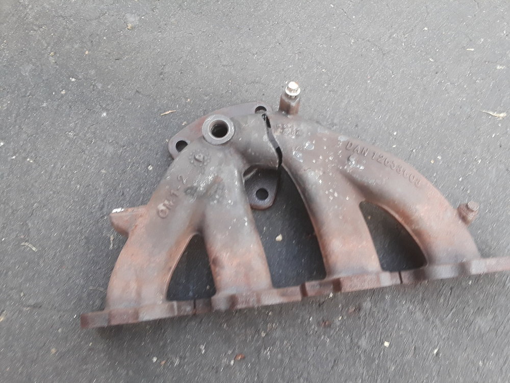

My 2013 Chevy Captiva (same thing as a Saturn Vue) started to sound like a racer stock car when first started but eod then quiet down some as it warmed up.  Today I took things apart and it was very easy to spot the problem. Broken exhaust manifold!!!
The hard part is the tear-down.  Access is limited.  The exhaust manifold is sandwiched between the engine and the firewall with very little room to work.
I got it apart and now need to order the parts and reassemble everything.

Andy, was not getting headaches but when first started we would get a whiff of exhaust fumes.  I truly feel there is a definate design flaw.  I had never  before seen an exhaust manifold split in half like this and now, since I told others about it I am hearing it is a very common problem on these ecotech engines.
