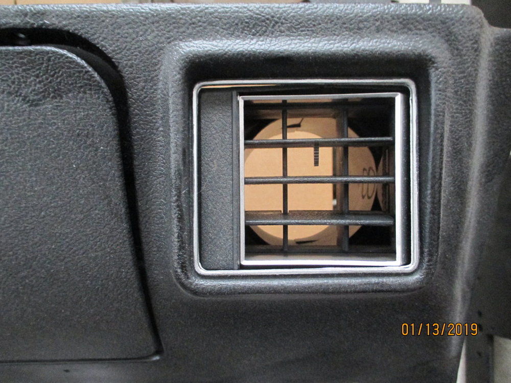

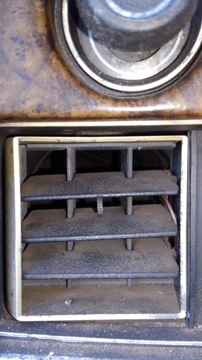

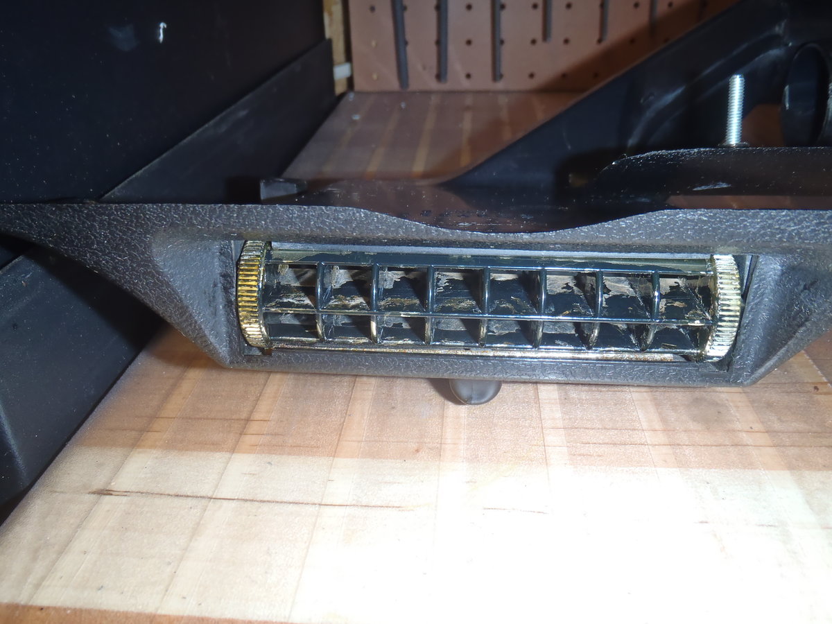

I'm replacing the deflectors in my side air vents and would like to confirm the correct orientation for those deflectors (i.e. which side is the top?).  I'll try to add a picture so you know what I am talking about.  there are three slats and one of them has the knurled vertical thing on the bottom of the slat.  Is that one the top slat or the bottom slat?  I shouldn't of taken both apart at the same time - rats.  It can go in either way.  I took a picture before removing the dash but it is not clear in this shot.

Hey Katman,
    I looked at all my Monte's in the fleet (5) and they all have the "knurled verticle thingy" at the top of the vents. Bother sides. Hope this helps.

Checked two of my Monte's . California built 72 A/c car and a Baltimore built 71 non A/c car both have the nub on top like this

I was pretty sure that they were on top but would have hated to find out later they are upside down which I've done before on other projects.  Thanks!  Tony, I wonder if yours are upside down?  Didn't see your comment initially.  It's easy to happen as they fit either way.

Just a little more reassurance.   All my dashes have them like this. If they are on the bottom slat they are wrong. This dash still needs the wood grain panel put back on.

Is it possible that everyone is saying the same thing that the vertical tab is on the bottom of the top slat?

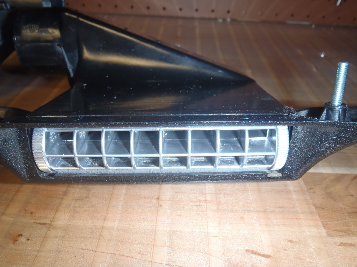

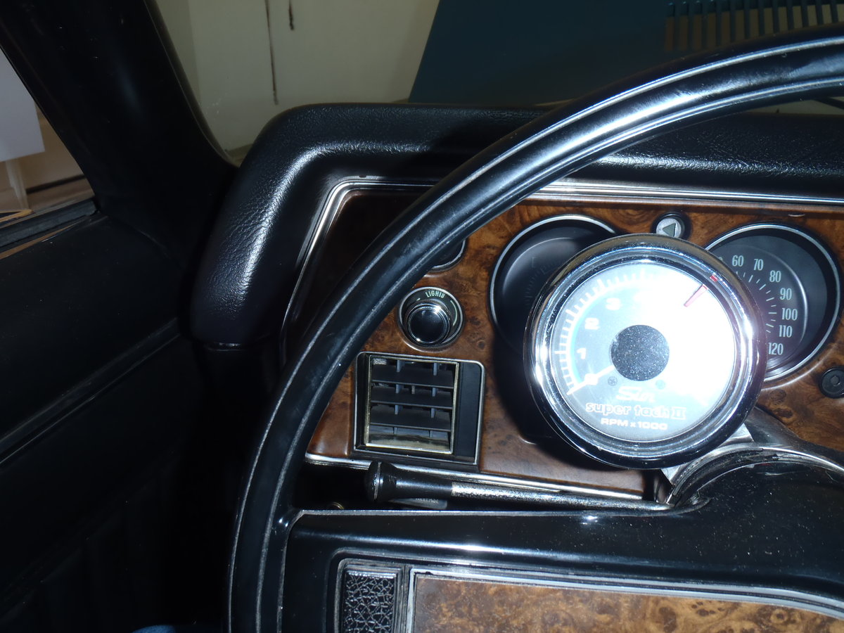

There seems to be at least two types of these air vents.  My  factory AC '70 SS has a slat housing with a flow control lever built in while my non-AC '70 has a slat housing with only a blank panel and  no flow control lever (see photos).  Was the flow control lever only available with factory AC?
Rather than replacing the lap air deflectors on my AC car, I removed the deflector, cleaned and stripped it and sprayed it with bumper chrome paint.  It doesn't shine quite like a new chromed-plastic part, but it sure looks better than the badly deteriorated original vent.

The housing for the non A/C vent is completely different than the A/C version.  Not sure if the vertical thing is on the slat of the non-A/C vent.  Thanks for all of the replies.

That’s what I meant,  they were on the bottom of the top slat.  LOL
i was wondering why people were saying mine were upside down as they looked just like the pictures!  Now that I re read the original post from Mark it’s clearer what was asked.

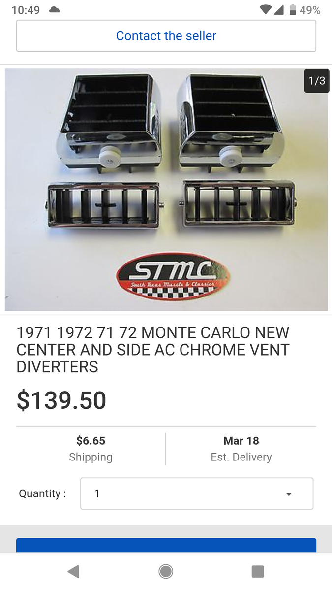

Does anyone sell the side vent assemblies for an A/C car? My 72 has a busted passenger side housing, plus the vents need replaced anyways. I figured I would just get the assemblies, but noticed on the OPGI site they mentioned non-AC. Saw them at the Parts Place as you mentioned and figured they're the same as OPGI's.
From the pictures they look similar but what are the differences?

I need these, but my car has A/C. OPG specifically says 'for non-AC cars'. Just wondering why they are saying non-AC, and what the actual differences may be. If it's just the lack of the deflector side lever as I've seen on some cars, no big deal, mine don't have them anyways. If it's going to be a square peg in a round hole though, that's another story then.
Worst case, I can repair the housing (broken mounting tabs), but the vents need replaced anyways.
https://www.thepartsplaceinc.com/product/1972/dash-side-outer-vent-deflector-assemblies-pr/55376
https://www.opgi.com/chevelle/CH26361/

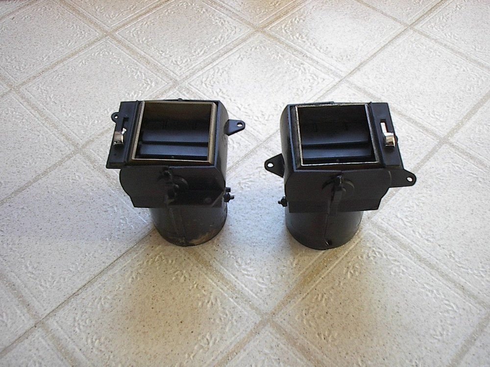

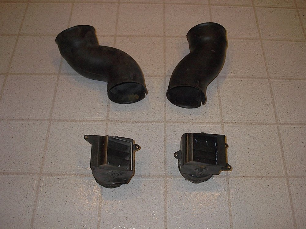

Joe's car is a 1972. This is how it goes. Most 1971 A/C equipped cars do not have the shut off levers that 1970 cars have. No 1972 A/C equipped cars have the shut off levers. All 1970- 72 cars equipped with A/C have longer vent housings than non A/C cars for 1970-72. The ducting that connects to them is different for A/C to non A/C cars. A/C cars need A/C vent housings, non A/C cars need non A/C vent housings. My first picture is the non A/C vents, my second picture is the A/C vents for a 1970. The 72 version of the A/C vents are just as long as these shown in picture two, but do not have the shut off levers. Again, most 71's do not have the levers.
Private Message me if you would like to purchase a 1972 A/C vent housing. I also have some non A/C vent housings for sale.
