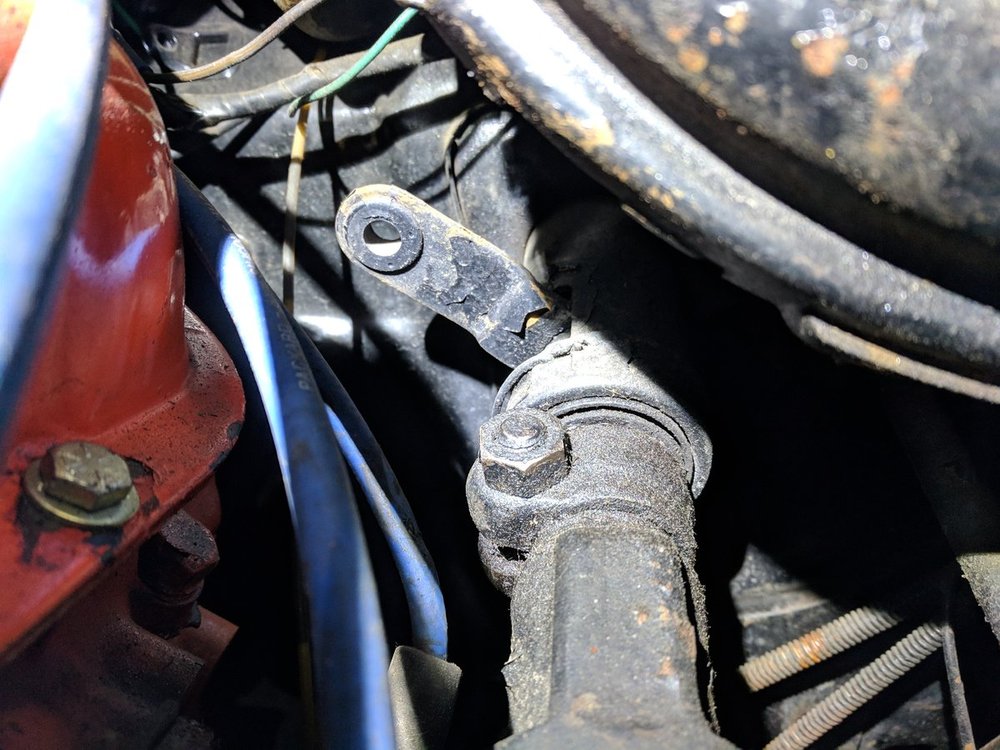

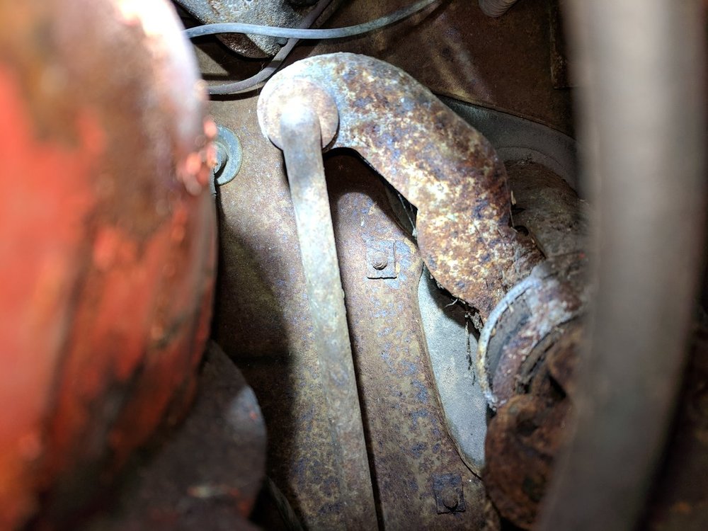

John, is this what you are talking about? The first pic is of my 71 402 4 speed and the second is of my 71 402 auto. Both tilt columns.

Thank you for the pictures you can clearly see the difference. Yes that is it. My standard column looks like your first picture. Have not bought a column yet, but there are more automatic tilt columns available than 4 speeds. It may work, I don't know for sure. If not I have a wire feed and a torch I'm confident I could make it work with some mild fabrication.
