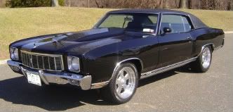

Posted 27 September 2009 - 02:18 PM
17x8 front wheels w/ 235/40/17
17x8 rear wheels w/ 275/45/17
All wheels have 5" backspacing and no trimming was needed. No rubbing issues.
