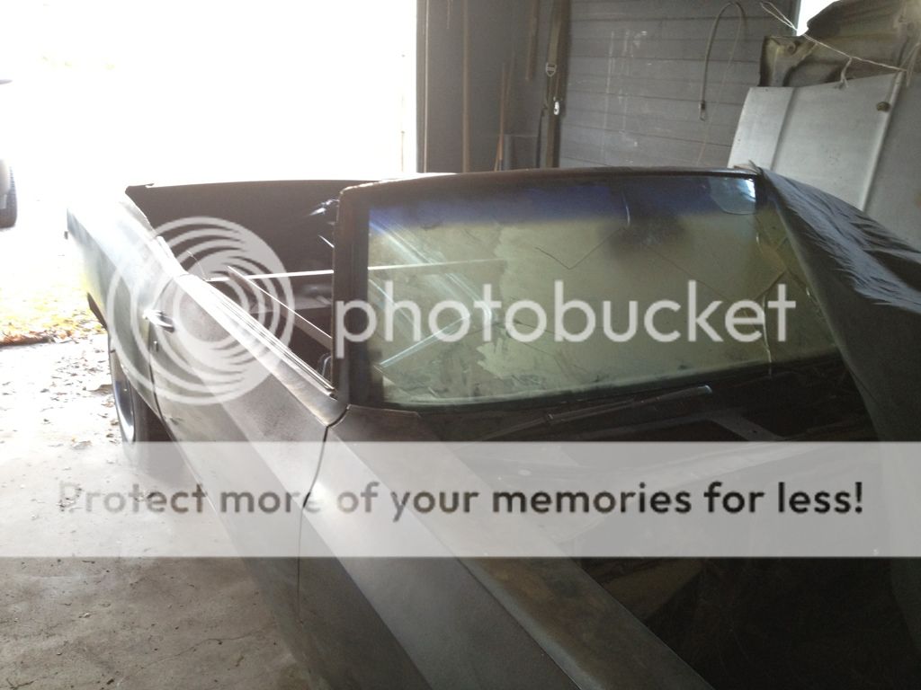

ss454-71 Posted February 25, 2012 Author Share Posted February 25, 2012 This is where it sits today! It's an 1.5 hour drive away in storage. So sad. Was going to bring it home this weekend but too much unfinished work on the K10 to bring it home just yet. Link to comment Share on other sites More sharing options...
70mcarlo Posted February 25, 2012 Share Posted February 25, 2012 Boy, the lines of the Monte Carlo sure make a covertible version look GOOD! It's a shame the brain wizards at GM decided to drop the plans for one. Link to comment Share on other sites More sharing options...

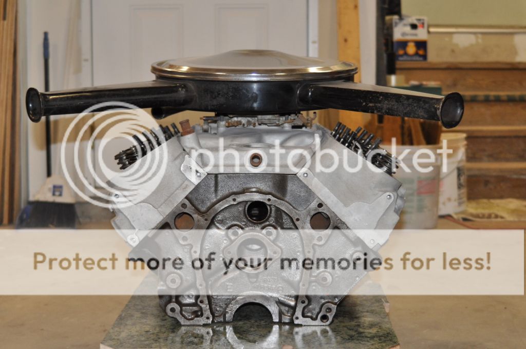

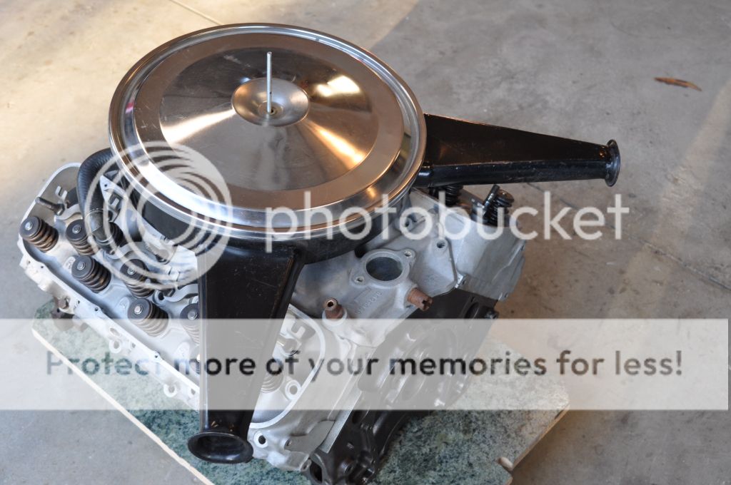

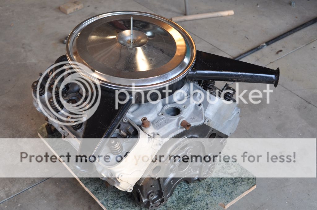

ss454-71 Posted February 25, 2012 Author Share Posted February 25, 2012 Here is a sneak peak at the engine. It's a 4 bolt 3963512 block with large oil bungs. It is stamped CE so it was a service replacement LS6 block. In 1970 they listed an aluminum head L89 ls6 (CRY suffix). This was never believed to be produced so since this is a what if build then why not run winters heads. I decided to go with an 077 head as apposed to the 074 which would have come on a 1970 L89 engine. The 077 head in stock form is a D port design which was supposed to flow better but has the same exterior appearance as the 074. The intake is a 3963569 aluminum intake correct for the 70-71 LS6 or L78. Now for the air cleaner. It is an original dual snorkel housing that is shown in the assembly manual for an LS6 chevelle (without cowl induction) and the monte Carlo. This air cleaner is extremely difficult to come by to say the least. They were also used on 1970 novas and camaros equipped with a L78 396 375hp. Link to comment Share on other sites More sharing options...

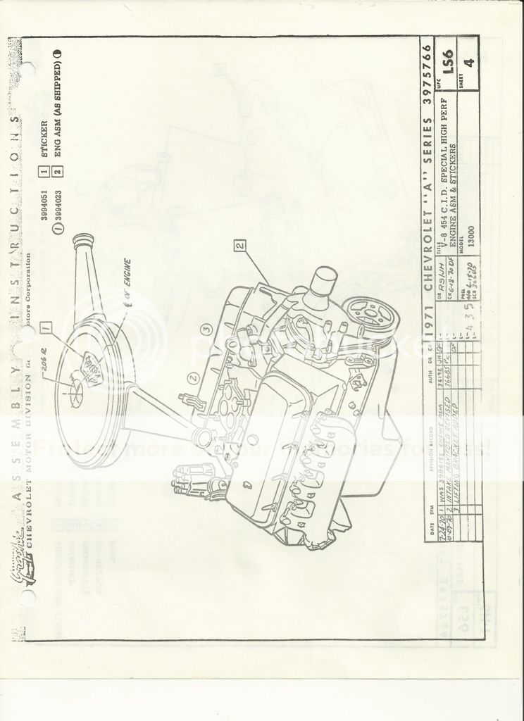

ss454-71 Posted February 25, 2012 Author Share Posted February 25, 2012 Ok here is a little bit more on the air cleaner housing. It's part # is 6485257 and is shown in the assembly manual as being correct for an Ls6 chevelle and monte. Below is a copy of the assembly manual for 1971 showing it. They were used in 1970 too. Sorry about the photo orientation. Link to comment Share on other sites More sharing options...

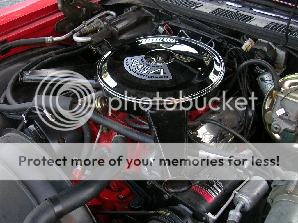

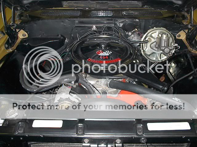

ss454-71 Posted February 25, 2012 Author Share Posted February 25, 2012 Here are some photos of originaly equiped cars with the dual snorkel air cleaner. Notice that none of the high HP cars came with A/C. 1970 L78/L89 nova 1970 L78 camaro 1970 LS6 chevelle Link to comment Share on other sites More sharing options...
LS5 Posted February 25, 2012 Share Posted February 25, 2012 Hey Jeff, Time for the Chevelle guy to chime in with some numbers to help as well here... From my days at GM there was supposedly only 9 pairs or 18 single Alluminum heads made and actually sold by GM back in the day but no documention has been recorded by them BUT and this is a big but I have seen personally a Yellow COPO 1970 Chevelle SS LS-6 car with them on and completely done and resold at Barrett Jackson with a build sheet showing the heads on it but not info retained by GM go through and sold the car 2 years ago for a whopping $203,000USD the owners name was John Hill of Calgary Alberta Canada who now resides in Pheonix AZ. VERY rare and you are right there were NO LS-6 cars sold with A/C it didnt happen just like a 454 4spd Monte Carlo, never happened. That Air Cleaner is ULTRA rare once again the last one sold in that shape with the obvious hidden marks so you knew it was real or not sold for $3128.00USD on Ebaymotors about 4 years ago and only came on NON functional Cowl Induction Hooded cars, they had the Cowl Dome hood but called them Fresh Air hoods only. So the % rate is ridiculous on those heads seeing how 18 were made and in 1970 they made 311,553 chevelle units made altogether. I know take a breathe..... I got myself all worked up. Basically saying your right so far and keep going with the Monte it is going to be Awesome when she is done... Darren. Link to comment Share on other sites More sharing options...

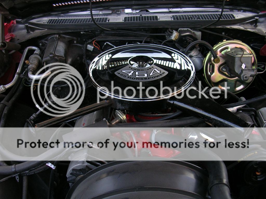

ss454-71 Posted February 25, 2012 Author Share Posted February 25, 2012 Here is what the LS6/L78 dual snorkel air cleaner looks like on a monte Carlo. Man I wish they released the monte ls6! I put it on my 71 LS5 ss454. Keep in mind the LS6 would not have had air conditioning so I had to use a spacer. Link to comment Share on other sites More sharing options...

ss454-71 Posted February 25, 2012 Author Share Posted February 25, 2012 Hey Jeff, Time for the Chevelle guy to chime in with some numbers to help as well here... From my days at GM there was supposedly only 9 pairs or 18 single Alluminum heads made and actually sold by GM back in the day but no documention has been recorded by them BUT and this is a big but I have seen personally a Yellow COPO 1970 Chevelle SS LS-6 car with them on and completely done and resold at Barrett Jackson with a build sheet showing the heads on it but not info retained by GM go through and sold the car 2 years ago for a whopping $203,000USD the owners name was John Hill of Calgary Alberta Canada who now resides in Pheonix AZ. VERY rare and you are right there were NO LS-6 cars sold with A/C it didnt happen just like a 454 4spd Monte Carlo, never happened. That Air Cleaner is ULTRA rare once again the last one sold in that shape with the obvious hidden marks so you knew it was real or not sold for $3128.00USD on Ebaymotors about 4 years ago and only came on NON functional Cowl Induction Hooded cars, they had the Cowl Dome hood but called them Fresh Air hoods only. So the % rate is ridiculous on those heads seeing how 18 were made and in 1970 they made 311,553 chevelle units made altogether. I know take a breathe..... I got myself all worked up. Basically saying your right so far and keep going with the Monte it is going to be Awesome when she is done... Darren. Darren, Thanks for the additional information. By no means do I profess to be an expert or authority on any car so I welcome everyone's input. Although i have obsessed over 70 & 71 monte ss454 cars way too much! I have just collected as much information as I could over the past couple of decades to come up with this "what if" project. A 1st gen Monte convertible, LS6/L89, M22 car could have easily been produced if GM wanted too with little effort on their part. I assume all the tooling was in place outside of the convertible quarter panel for GM to produce such a car. Thanks again for all the encouragement! Jeff PS: I sent you a pm too. Link to comment Share on other sites More sharing options...

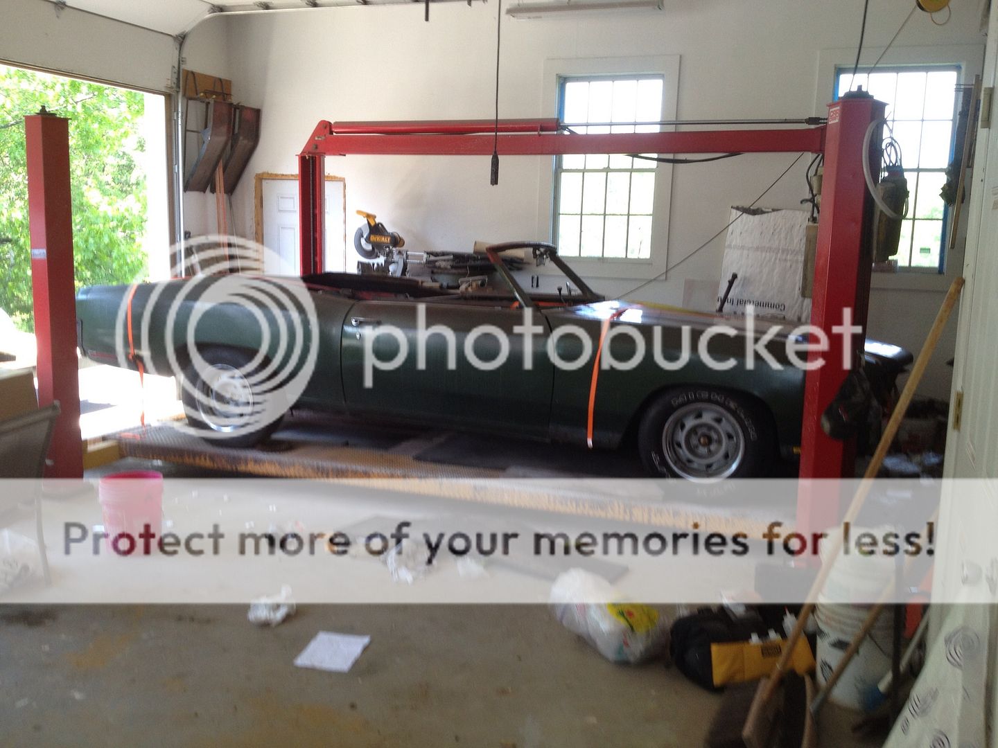

ss454-71 Posted May 22, 2012 Author Share Posted May 22, 2012 Well I finally got the car out of storage! I'm still working on the k10 project but at least this one is back on deck and on the rack. Got to clean up the garage too! Link to comment Share on other sites More sharing options...
LS5 Posted May 22, 2012 Share Posted May 22, 2012 Hey Jeff, while the chevelle is up in the air literally I will get you my measurements for those 2 areas you marked with question marks if that helps.?? Darren. Link to comment Share on other sites More sharing options...
