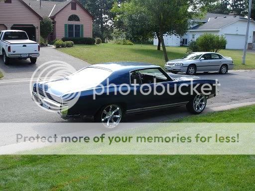

Just saw this post. Great idea Bill.
17x 9-1/2 with 5-1/2 BS on rear. Coddington's
17x 8 with 4-1/2 BS on front. Coddington's
Nitto rubber.
245-45-17
255-50-17
Stock big block springs and suspension. No rubbing issues at all after I trimmed the rear wheel wells. I think that with another 1/4" BS on the rims you would not have to trim the wheel well. I had the rims custom cut so I could not return them and change the BS.

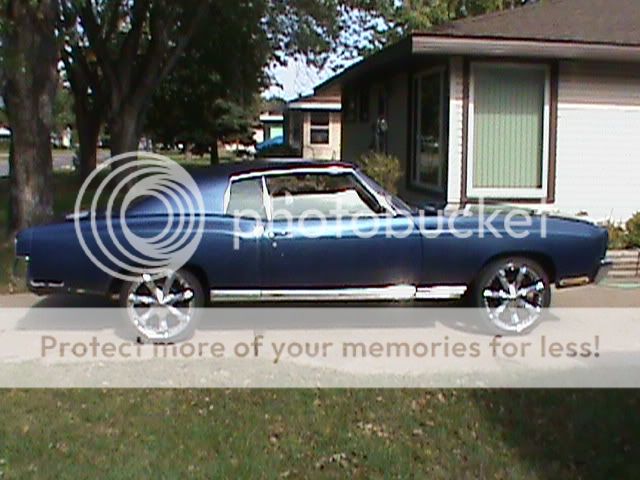

20x9" front, 6.5 backspacing w/ 1 inch spacer
20x10.5" rear, 7.5 backspacing w/ 1.5 inch spacer
245/35/20 front
275/35/20 rear, will go to a 295 or 305 when i need new rears
Greg Weld Racelite Wheels with Kumho Ecsta SPT fronts
Michelin Pilot Primacy rears
hotchkis 1 inch drop springs all the way around, 2 inch drop spindles
Had to trim rear wheel lips, but when i get wider rear tires I will get the rear spacers machined down a bit, have about a inch and a half of room on the inside, half an inch at the closest point on the outside.
Thinking about dropping the saggy old springs in the back...
One day I will get the OPG 3" drop rears and cut a half coil or so on my fronts.

I just sold the rims but i thought i would put the info on here any ways.
Mazzi #725 rims
20x8.5
Not sure on the back spacing
255/35ZR 20 tires
I dont think any mods were done to get them to fit because they were on the car when i got it, anyways the dont rub at all.
Edited by BAMC1369 (05/07/10 05:24 PM)

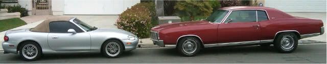

#357294 - 02/10/12 12:49 AM Re: Wheel and Tire data base. [Re: Mom's Car]
mnte496 Offline
Junior Member
Registered: 01/07/12
Posts: 21
Loc: lincoln nebraska
Have any pics of the car? kind of wanting to do the same on mine thinking about the 295 65 15
Top

#357497 - 02/11/12 01:00 PM Re: Wheel and Tire data base. [Re: mnte496]
Mom's Car Offline
Bronze Member
Registered: 03/18/10
Posts: 759
Loc: Long Island
http://www.flickr.com/photos/29996868@N07/6856460929/in/photostream

#413547 - 08/16/13 02:46 AM Re: Wheel and Tire data base. [Re: Malyc]
CKZ03 Offline
72 CUSTOM
Silver Member
Registered: 09/26/12
Posts: 1277
Loc: Prison City, Michigan
Yaaa, I said I would post my opinions & results here with my set up after putting some miles on her, thanks for bringing this post up Malyc.
Im running 17 x 8 Rocket Racing Booster's with 4.5" backspacing, mounted with 255/50 17 Nitto 555's at all four corners. No rubbing at all, very nice smooth ride, exceptional handling and my WEAK A$$ 350 can barely turn over these sticky monsters. Well, maybe not that bad, but theres no way Im going to dig a hole to china with this rubber...
Completely stock worn out all original springs with booo cooo miles on them, 1 inch spacer (beneath coil) in rear

#413551 - 08/16/13 02:58 AM Re: Wheel and Tire data base. [Re: 502ci]
Malyc Offline
White Knight
Brass Member
Registered: 08/14/13
Posts: 250
Loc: Circle Pines, Minnesota
Nice setup there... After I get all the suspension work done (QA1 coil overs on all four corners, sway bars and whatever else I need...) I'm probably gonna go with a set of 17x8s with Michelin AS3s, though I think I'm going to go a bit shorter than what's on there now... 275/40s out back and 255/40s up front.
