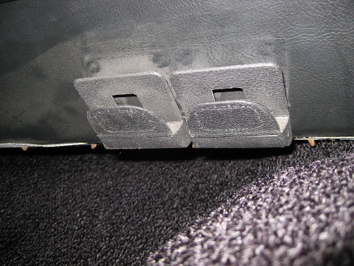

Wallaby,
My 71 "Bench Seat" had DELUXE seat belts as mentioned above have smaller brushed metal lap belt buckles and larger brushed shoulder belt buckles WITH a convenient storage holder three for the ft and three for the rear seat. In addition the "lap belt" was a "SELF TIGHTENING" modern style not the pull em tight style. My shoulder belts were "tighten em up" style and cut my neck. 72 may have been different or after all these years, someone changes something!
I now have three point MORRIS system and I like it.
Bruce
Added some pictures of the Deluxe seat belt holders for 1971,
1971 Deluxe Seat Belt holders
Edited by stangeba (07/28/10 05:05 PM)

#274407 - 07/28/10 09:30 PM Re: SEAT BELTS [Re: stangeba]
ThirdMC Online   content
Member
Registered: 07/16/10
Posts: 111
Loc: MS, USA
Mine has the same thing...gotta love those 'Deluxe' seat belt holders.

#274409 - 07/28/10 09:40 PM Re: SEAT BELTS [Re: ThirdMC]
502ci Offline
MODERATOR in the 11's
Chrome Member
Registered: 12/26/05
Posts: 9669
Loc: Broadview Hts. Oh.
Learn something every day, I never heard of seat belt holders like these.

#274584 - 07/29/10 02:52 PM Re: SEAT BELTS [Re: 502ci]
wallaby Offline
Mechanical Visionary
Diamond Member
Registered: 02/28/02
Posts: 5005
Loc: Sacramento, CA
I have those things in the back seat, but don't remember if the front bench had them. They sound like a good idea, but you have to adjust the belt length to get them to fit into the holders (always some loose strap left over)..then re-adjust them again if you want to wear them. It's a pretty good solution if you intend to just sit on top of the belts and not wear them. It eliminates the big tangled pile of belts/buckles under your keester.

#274611 - 07/29/10 05:19 PM Re: SEAT BELTS [Re: wallaby]
monte70car Online   content
peace maker
Chrome Member
Registered: 10/19/00
Posts: 5750
Loc: alexandria,va
Heck our El Camino has that for the shoulder belts.
