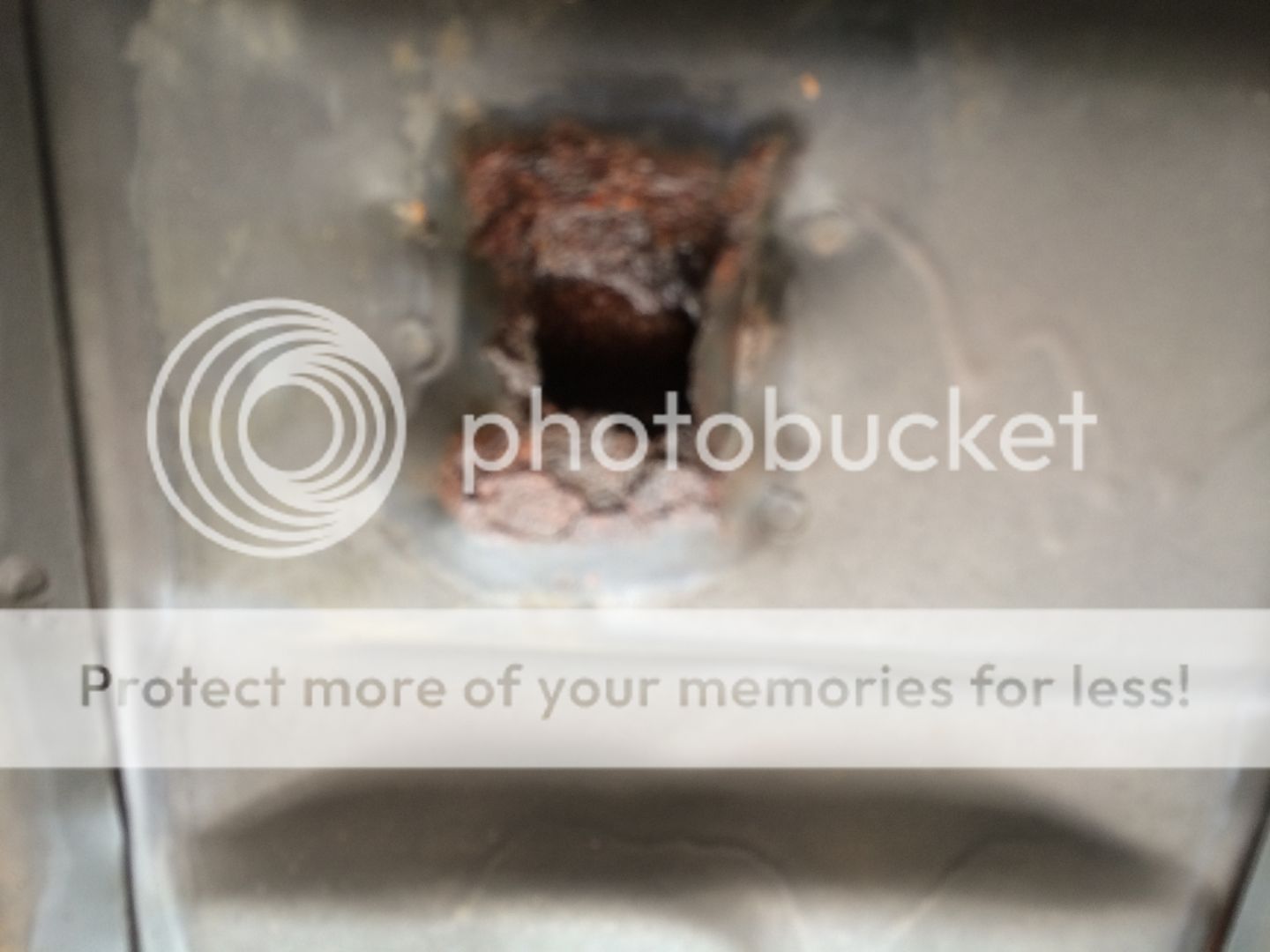

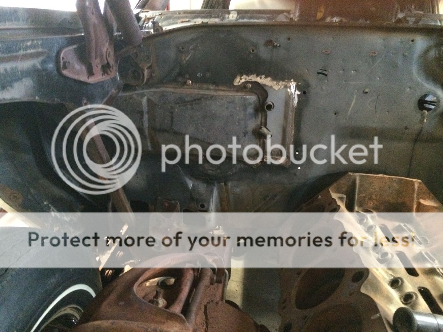

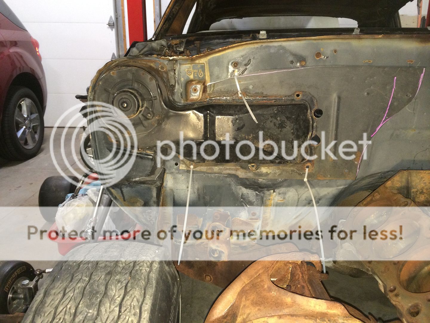

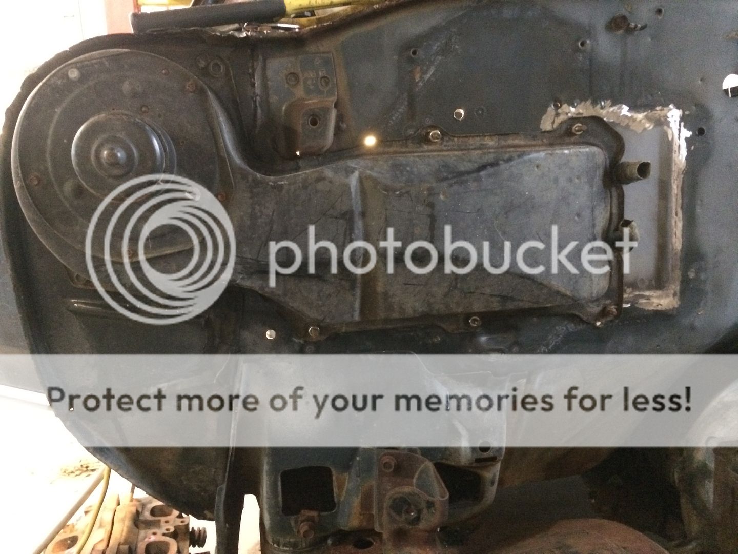

I hope I don't lose some of you with this but I'm not a huge fan of A/C cars with the large factory firewall box, hoses, compressor and condenser. So I'm going to go with the factory heat only setup. I will keep all the factory a/c stuff so it could go back on one day if someone desired. It will knock a bunch of weight off the front of the car too.
The conversion will look totally factory in the end. I have the firewall section and all the needed air boxes (inside & out) from a non-air car and I will graft in the needed section. The vin stampings will be unaltered and if put back to an a/c car in the future it wouldn't be difficult and nobody would be able to tell. No harm no foul. Here are some shots of what I'm up to.

I'm with you on that one. I find the engine compartment look so much cleaner, easier access to the sides of the engine without all that stuff and as you mention, lighter. I weighed the items and the difference was 72 lbs less. Good on you for going through the process of making the modification stock like. Good luck with your project. Pls keep the pics coming.

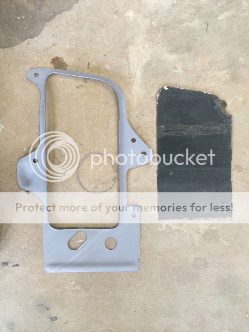

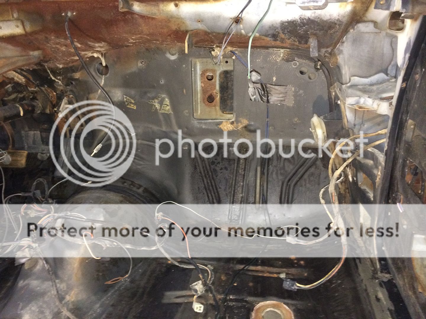

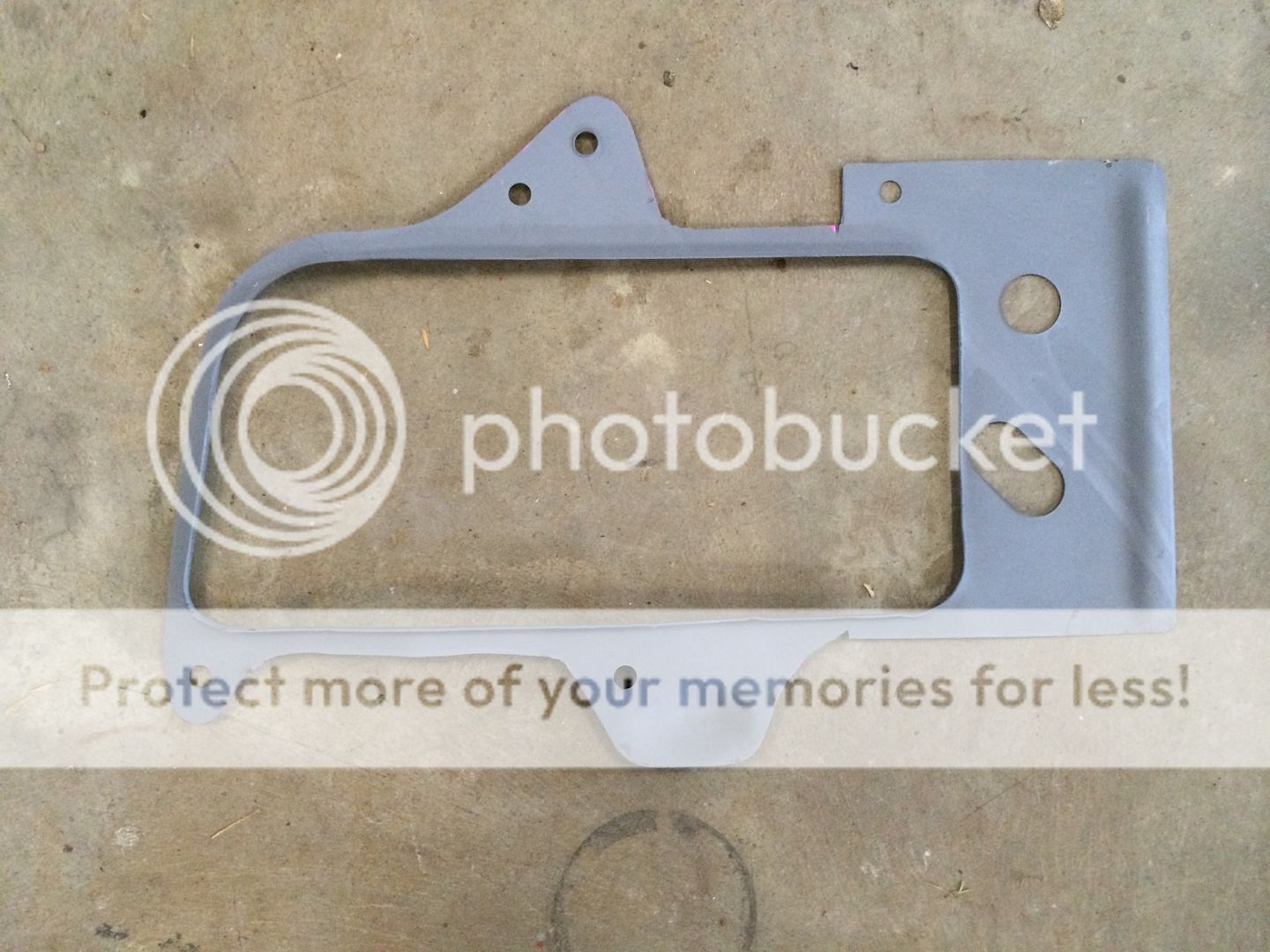

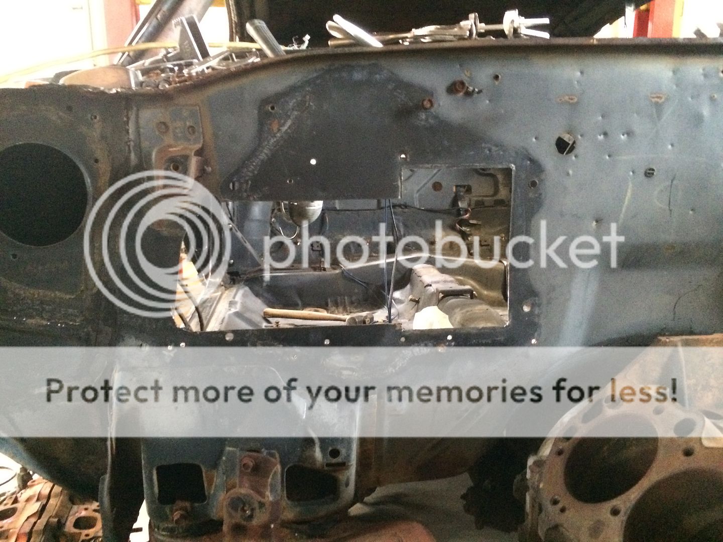

I had an opportunity to work on the firewall today. It is coming out decent. Still need to plug a few more small A/C specific holes and then a little filler any it will look factory. Also going to install the cowl vent tubes so the manual kick panel vents work as they should in a non-air car. I will keep the firewall section with all the A/C accessories so if it was converted back everything is there.

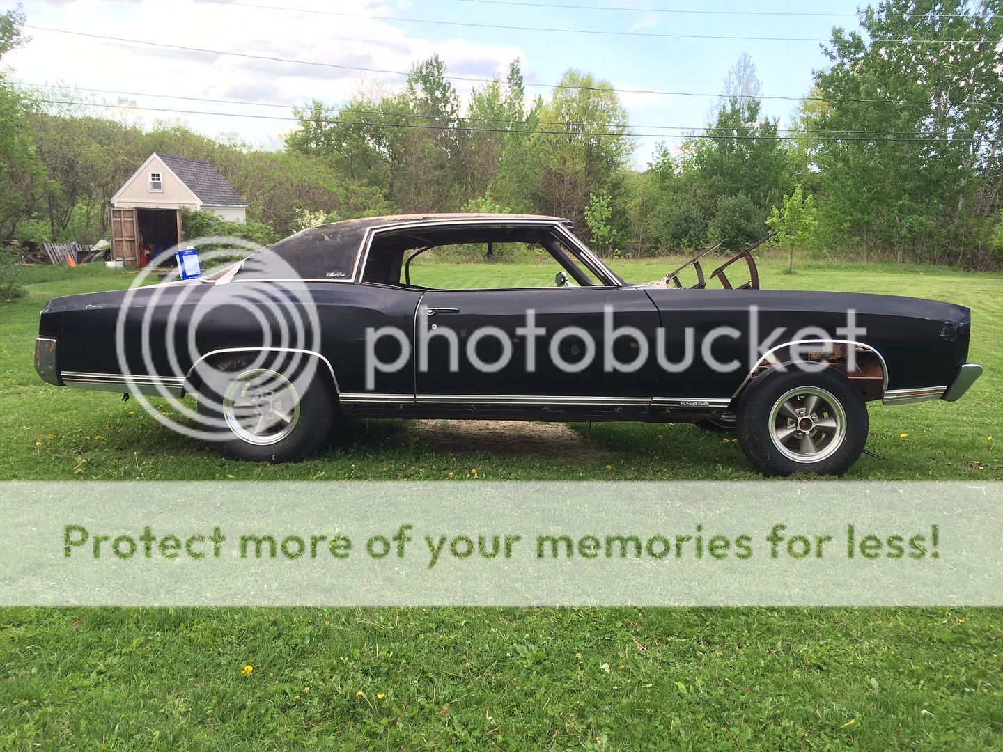

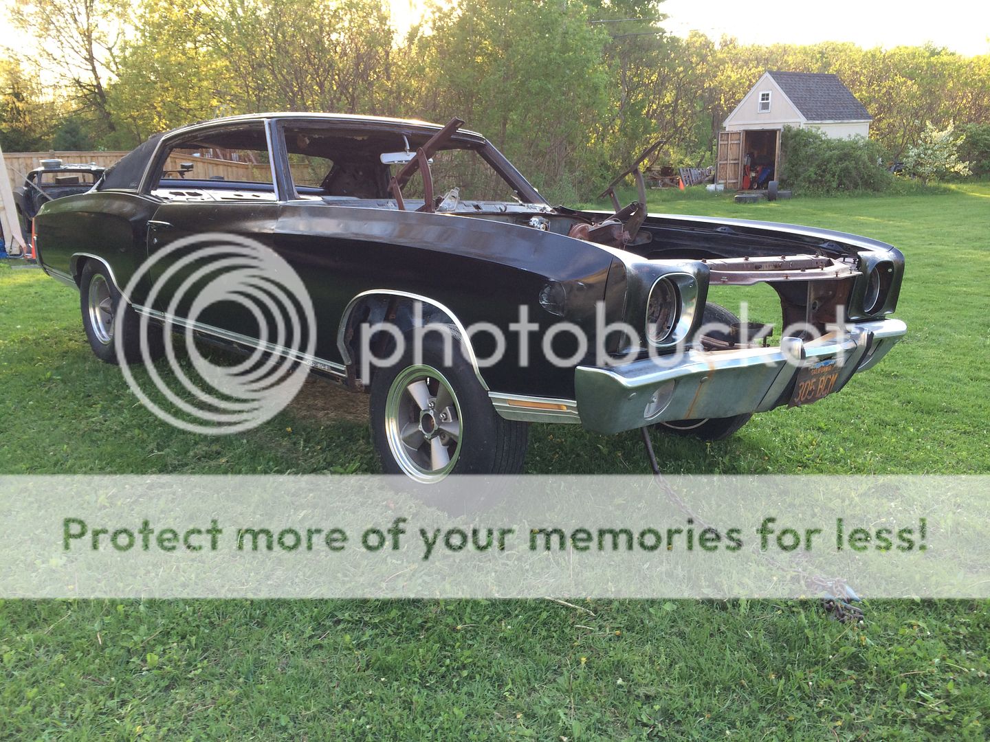

Been thinking of ways to preserve the patina. I see lots of guys clear coat rat rods but seems like a lot of effort and materials. I decided to try out linseed oil. It's super cheap ($7 a can), makes the finish (if you can call it that) a bit more uniform and has a low luster that will slowly fade to flat over time. This look will bridge the gap until it gets a full paint job down the road. Way down the road.
Before
After
Looking good. Every car don't have to be a show car, you'll enjoy it a lot more and get a bunch more attention with a rough looking car.

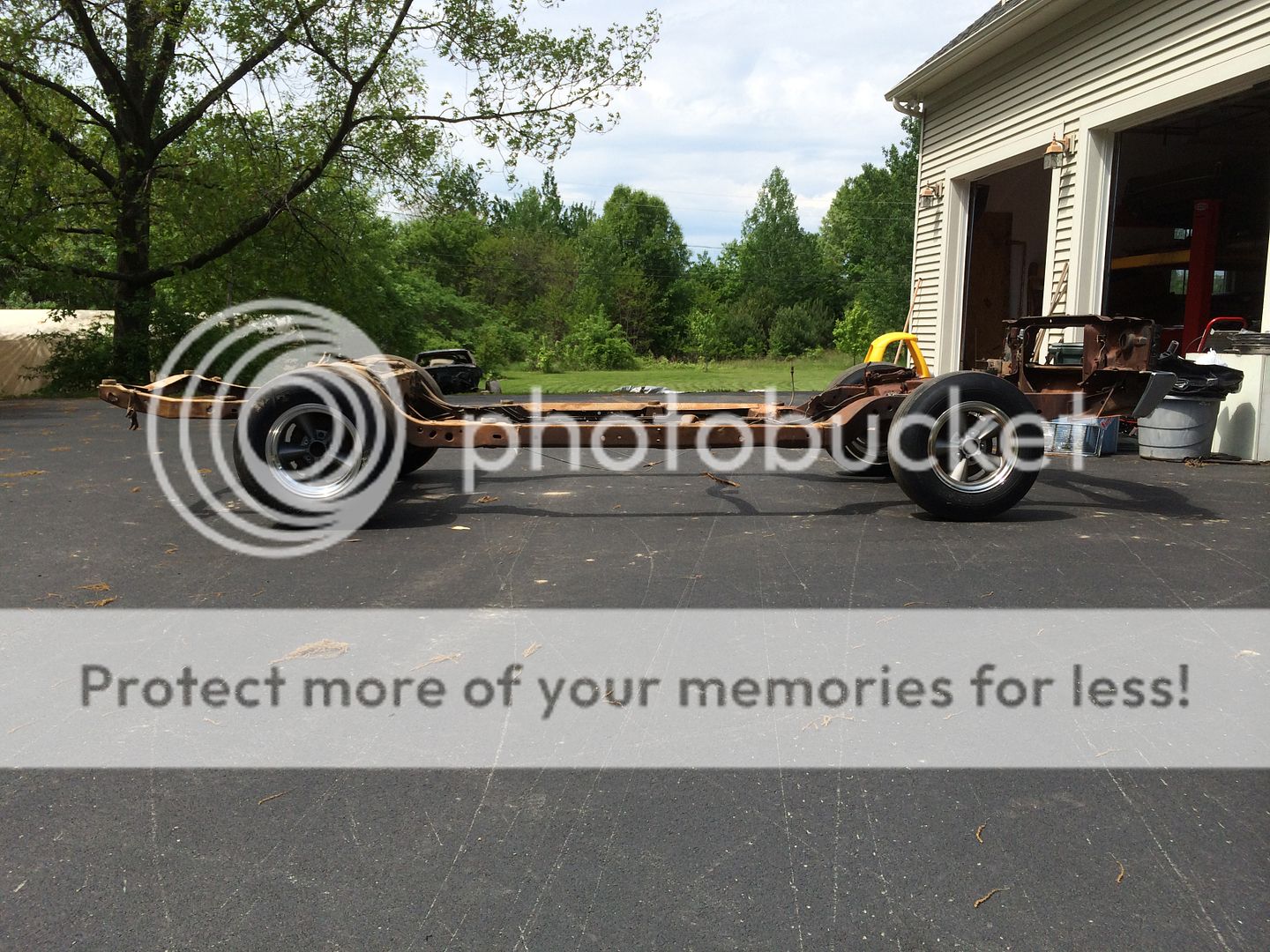

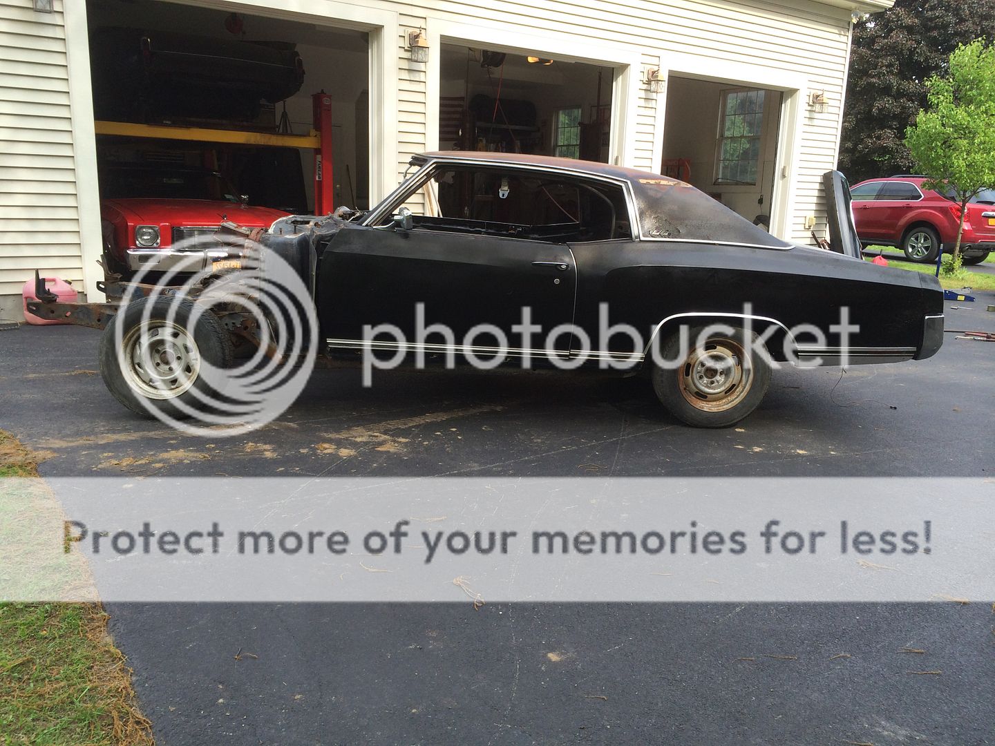

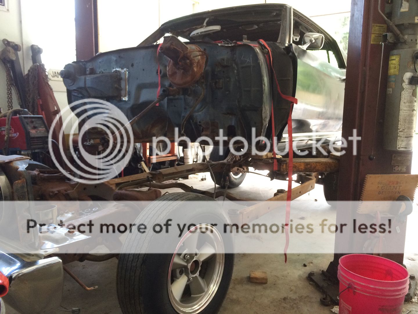

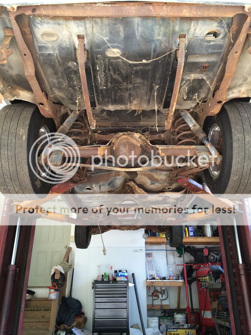

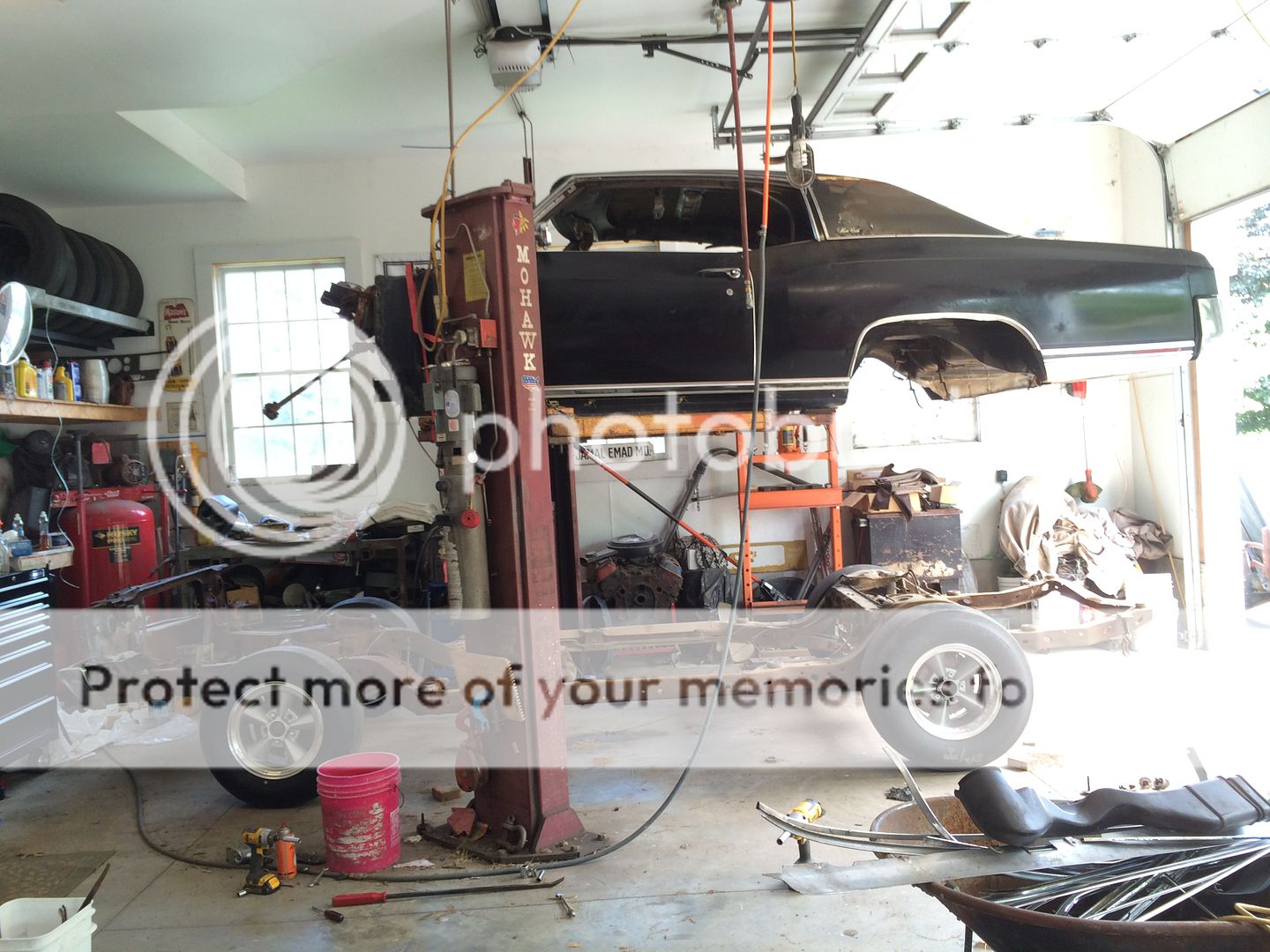

Continued working on the tear down last weekend. Got it up on the lift to access the frame bolts to lift the body off the frame.
The body was set on an old parts car chassis for now while I restore the chassis.
EFF2EFD5-8718-435B-970A-5C5846064F71_1.j

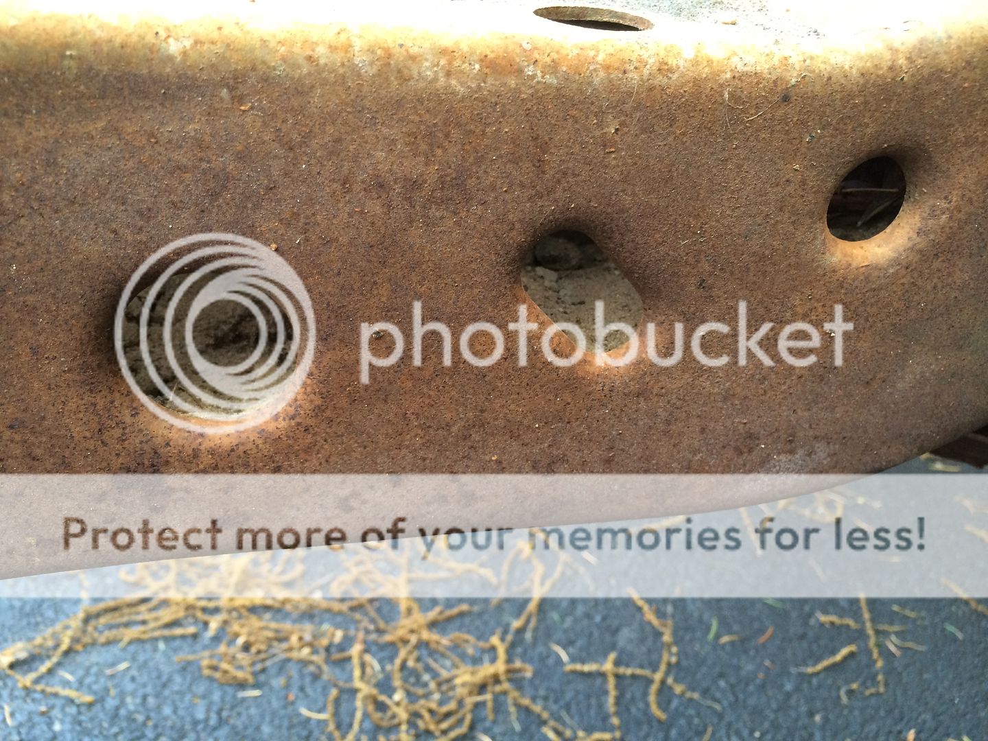

Check out how clean the body mounts are. That's why it's worth paying shipping to get a car from the south west.
539D3C76-7844-4655-989E-D6291AE024FF_1.j
4414904E-28C5-46A0-884F-EE058F022AFF_1.j
Paint dabs are the still visible.

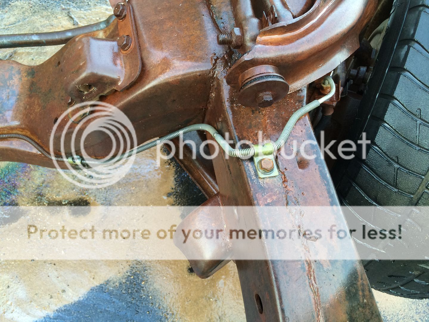

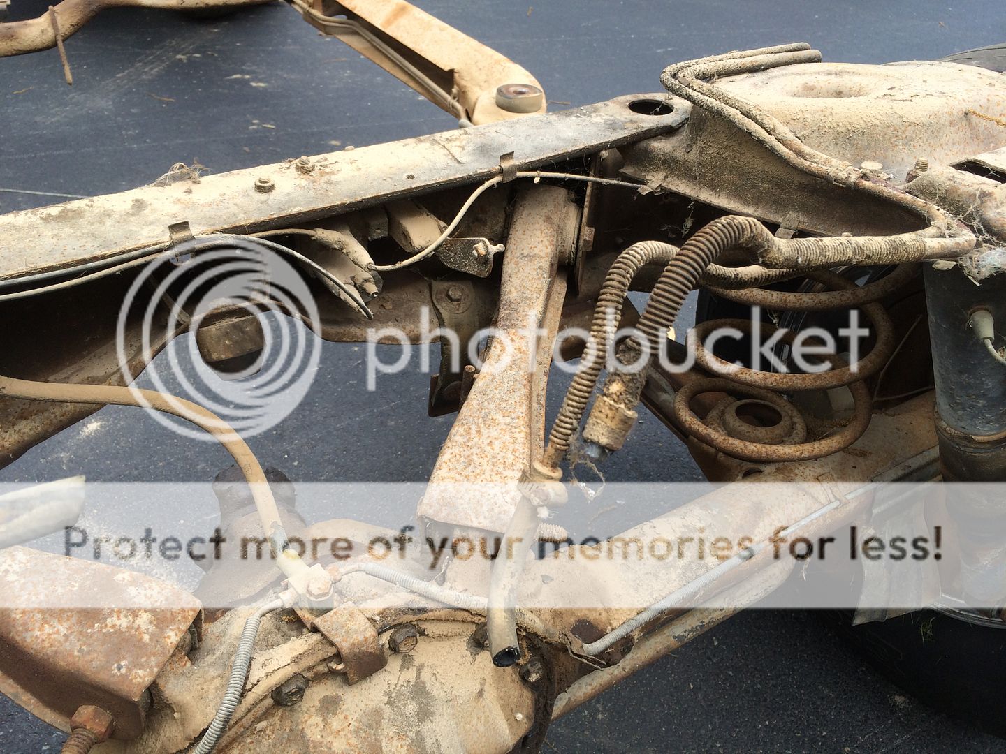

She has about 20 lbs of sand and dust in and on the frame.

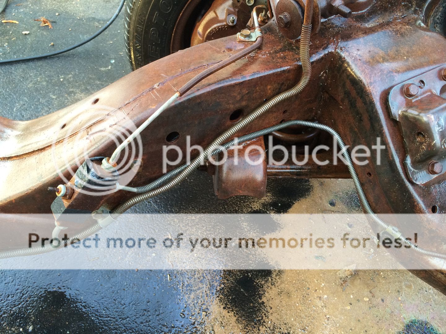

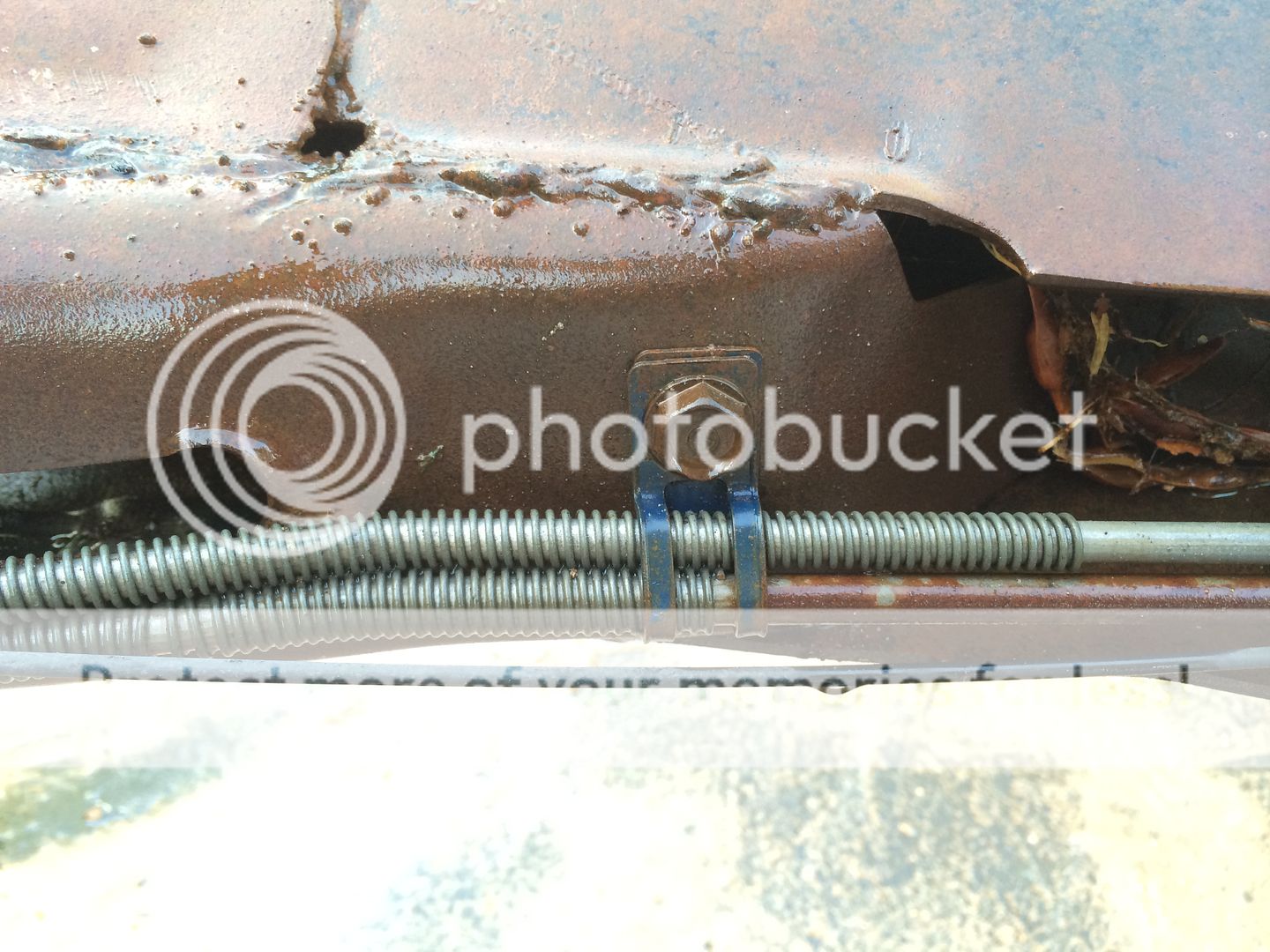

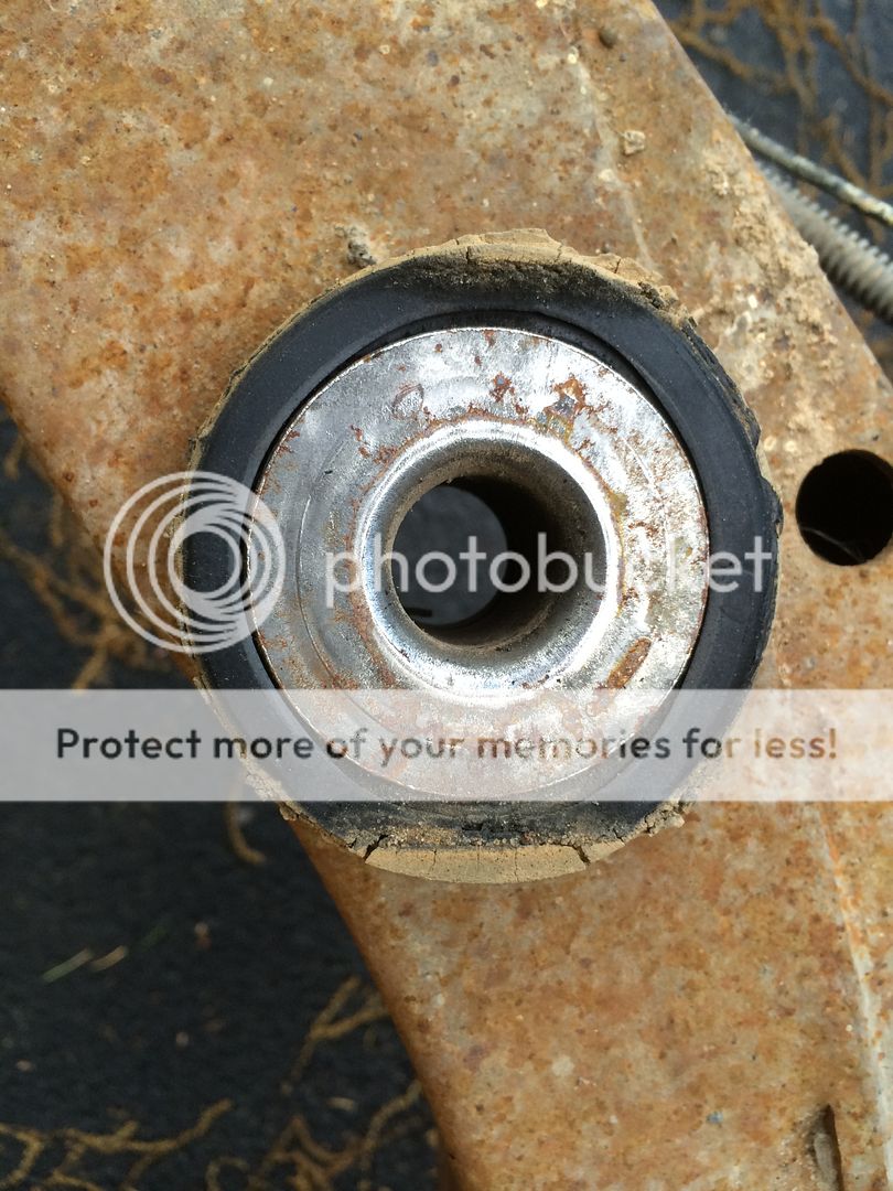

Pressure washing really shows how well preserved the chassis is. The brake and fuel lines are is great shape. Lots of black frame paint is still there.

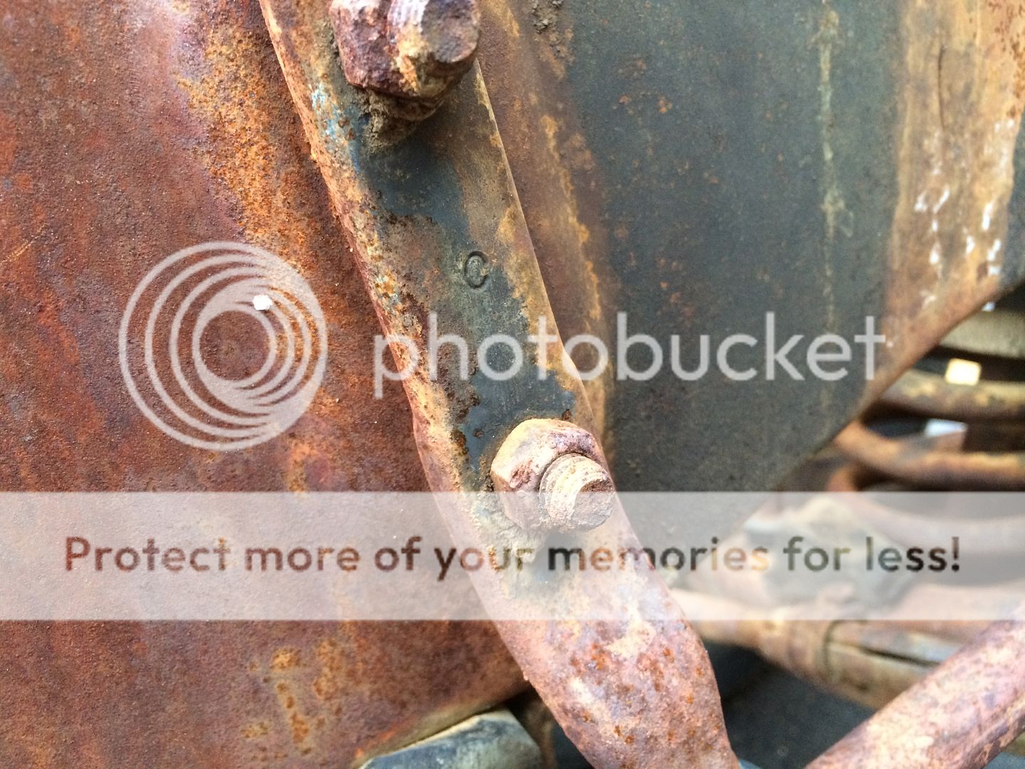

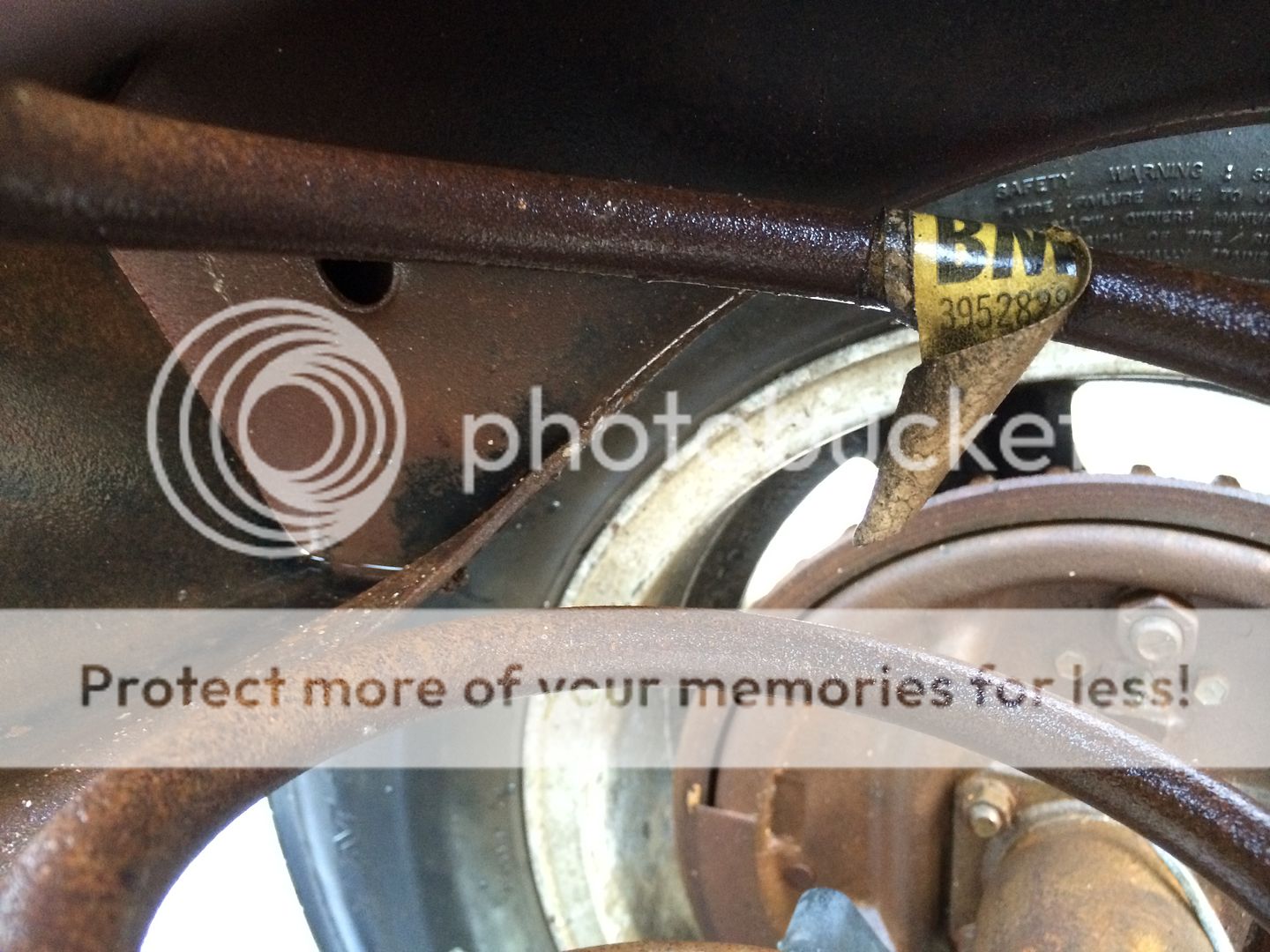

The spring tags are very readable too.
This is where the frame sticker must have been.
Lots of paint tabs are there too.
Those are some amazing pictures. Certainly makes for an easier restoration. Those brake lines and even all of the rubber bushings look fantastic.
