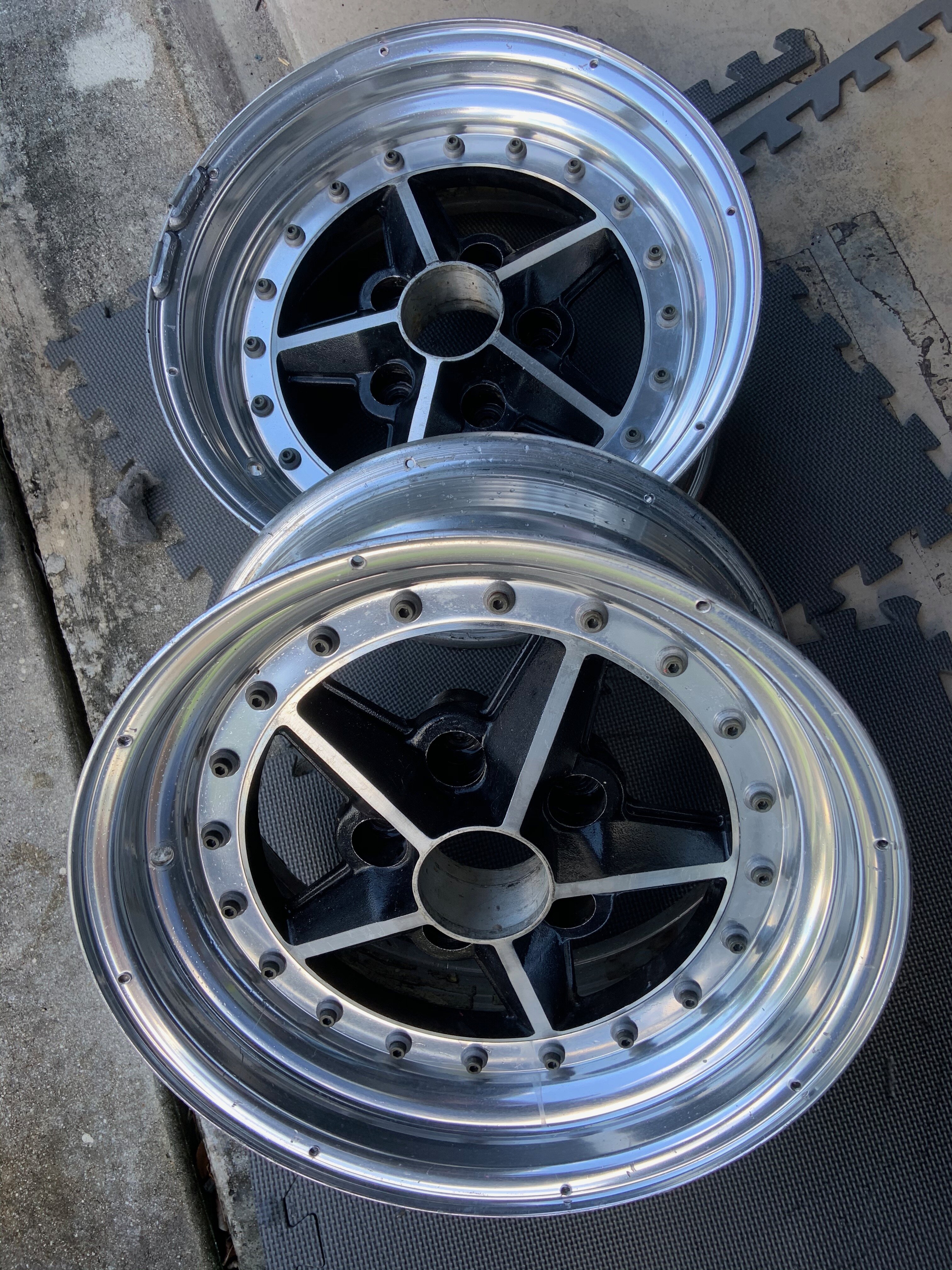

Had to laugh, not trying to jump on the new wheels bandwagon in Tom's thread. My buddy dropped of a set of "lite" wheels yesterday, 15 X 8 , 4.5 BS that he's had "in stock" for awhile. They might not be the prettiest but they will do the job. Took a brillo pad to them, look better than when he dropped them off lol

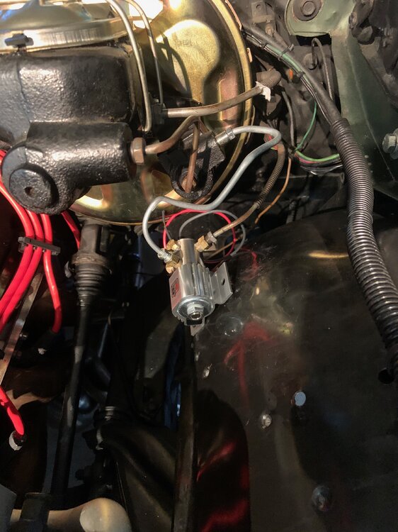

Plumbed the Roll Control (line loc) yesterday, now just have to connect the wires for the switch and light. Hope to get that done today if it doesn't rain, wish it wasn't so bloody hot out though lol. Learned something else, you can't just order any 1350 u-joint for the drive shaft at the rear, apparently with the TH400 the caps aren't all the same size so i'll be returning my mistake to summit lol. Luckily the local NAPA had one in stock so only a small set back.

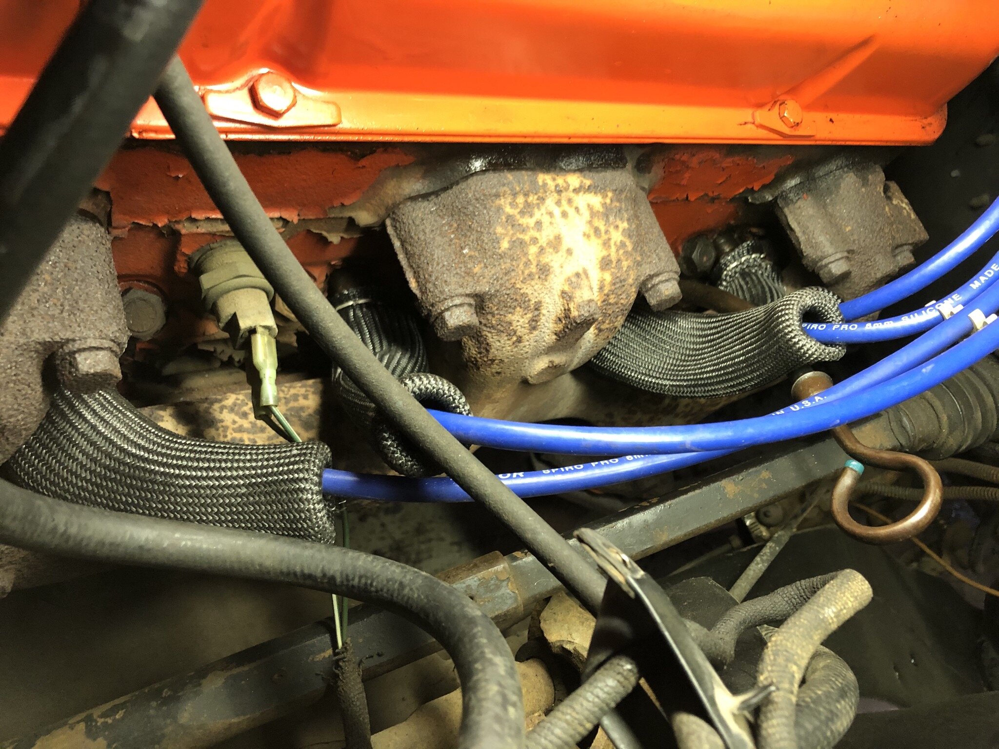

Inserted spark plug wire heat shield sleeves
Hey Rick, did you make your spark plug wires or were they pre-made? I was looking at heat shields but a lot of comments were made that they wouldn't fit over the boots.
Link to post
Share on other sites
Mark, no I didn’t make my own wires as I used other end on the wire where it goes to distributor then push it through the sleeve down.  I had to tape up the rubber boot on each to get it through the sleeves “O” ring.
