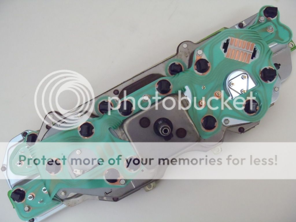

You will probably need to remove the large plug from the back of the instrument cluster to check continuity so I suggest you also remove and re-seat the small connector on the other end of the brown wire which should be in position 9 of the big plug (see photo). Be sure the small connector is correctly oriented in the big plug and fully seated so it makes good contact with the circuit panel when you plug it back in. Also, check the two fold-in tabs on your circuit panel that connect to the plug to be sure they are clean and correctly aligned. You will obviously need to re-install that big plug to do another test and that act alone might complete the signal circuit.
If not, the circuit path in your circuit panel leading away from the number 9 position may be damaged or broken. I would carefully inspect the relatively short circuit path from the #9 plug position (third up from the bottom left when looking at the circuit panel plug area) to the left hand connection post (see photos). Be sure the small nuts on both posts are snugged down.
Hopefully, one of the above steps will restore the signal circuit and your new tach will work. If not, I would contact sonnie24 to see what he suggests and if there is some simple test you can do to verify the new tach is working properly. Good luck!

If you have no power to the tach but the other gauges work, it almost has to be the nut on the right hand connection post is not tight enough to make a good contact. Power for the tach, water temp, brake warning light and oil pressure light all comes off of the same circuit in your panel connected to port #7 on the big plug. Since your tach power connector is upstream of the others, it must be the panel is not making good contact on the right hand tach post. I would either snug down those two nuts or add a washer under them like Rock suggested to be sure the panel is making good contact.
