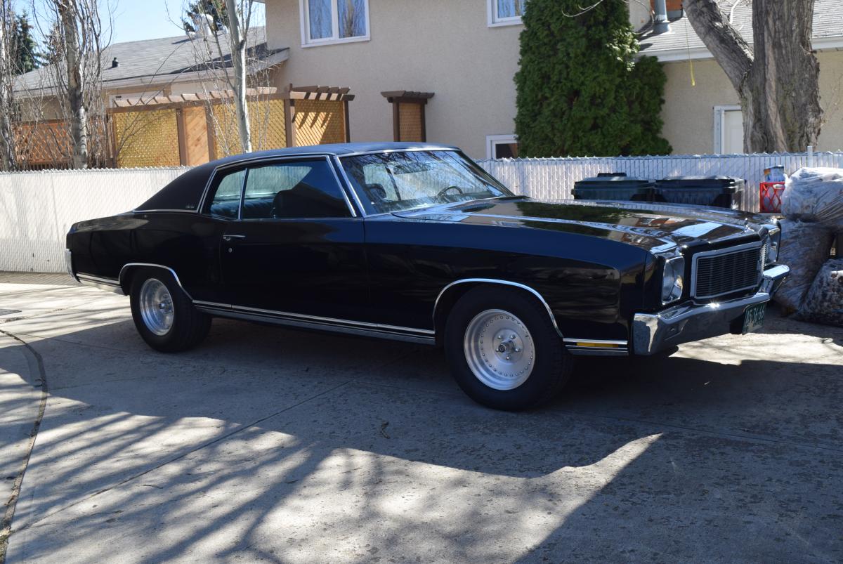

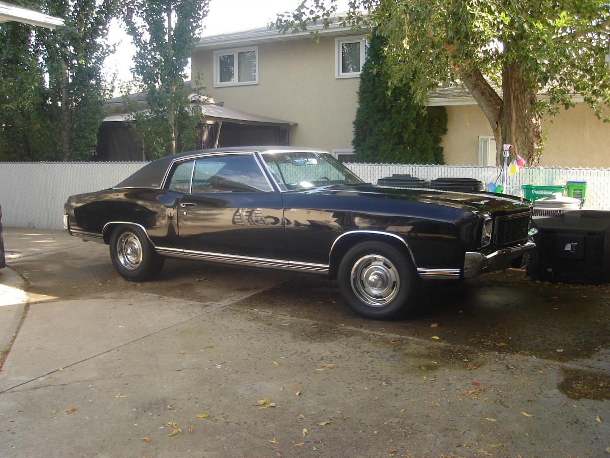

ripleydale Posted April 15, 2016 Author Share Posted April 15, 2016 Here you go Tony. I don't really have a great side shot of before since I really didn't like looking at that angle. The rims are different but the tire sizes are the same, 275/60/15 on the back and 255/60/15 on the front. I wouldn't mind the front end lower, and if I change tires I might think of chopping more off. Quote Link to comment Share on other sites More sharing options...
