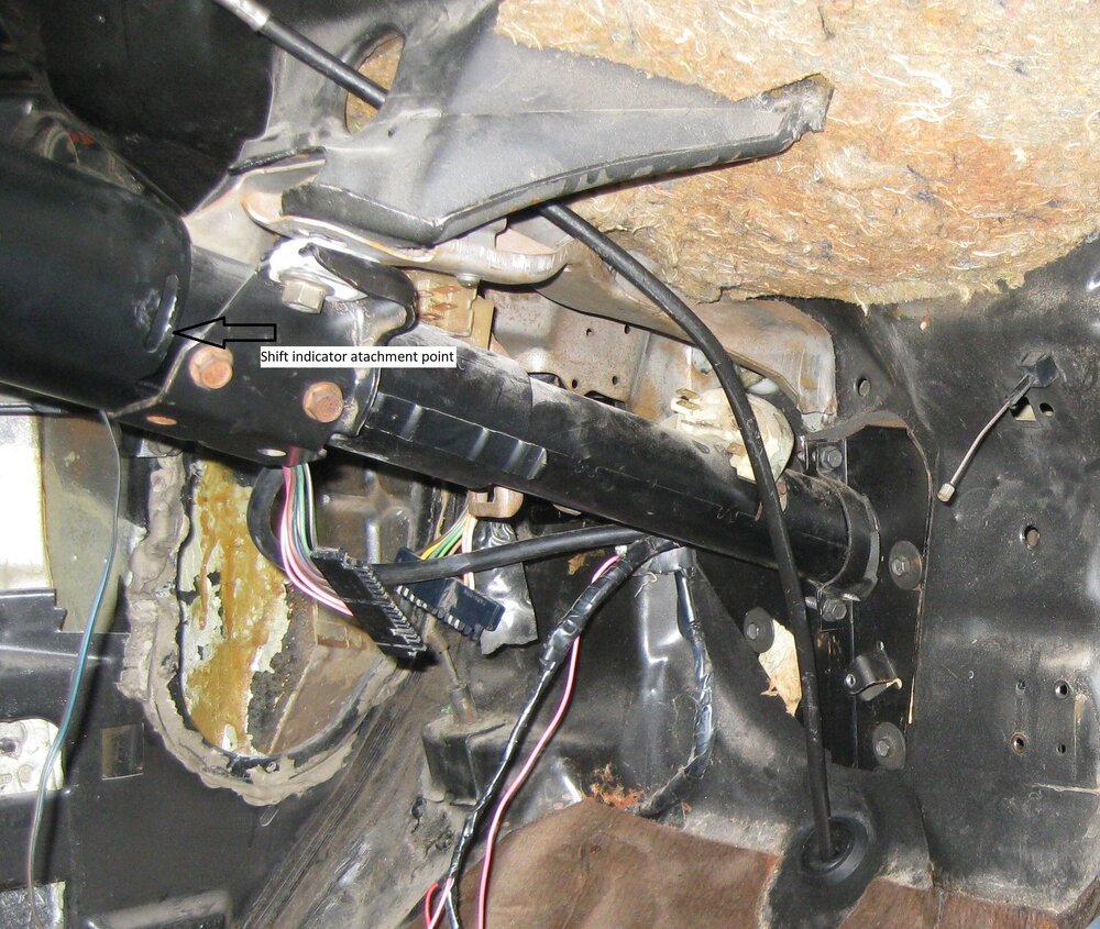

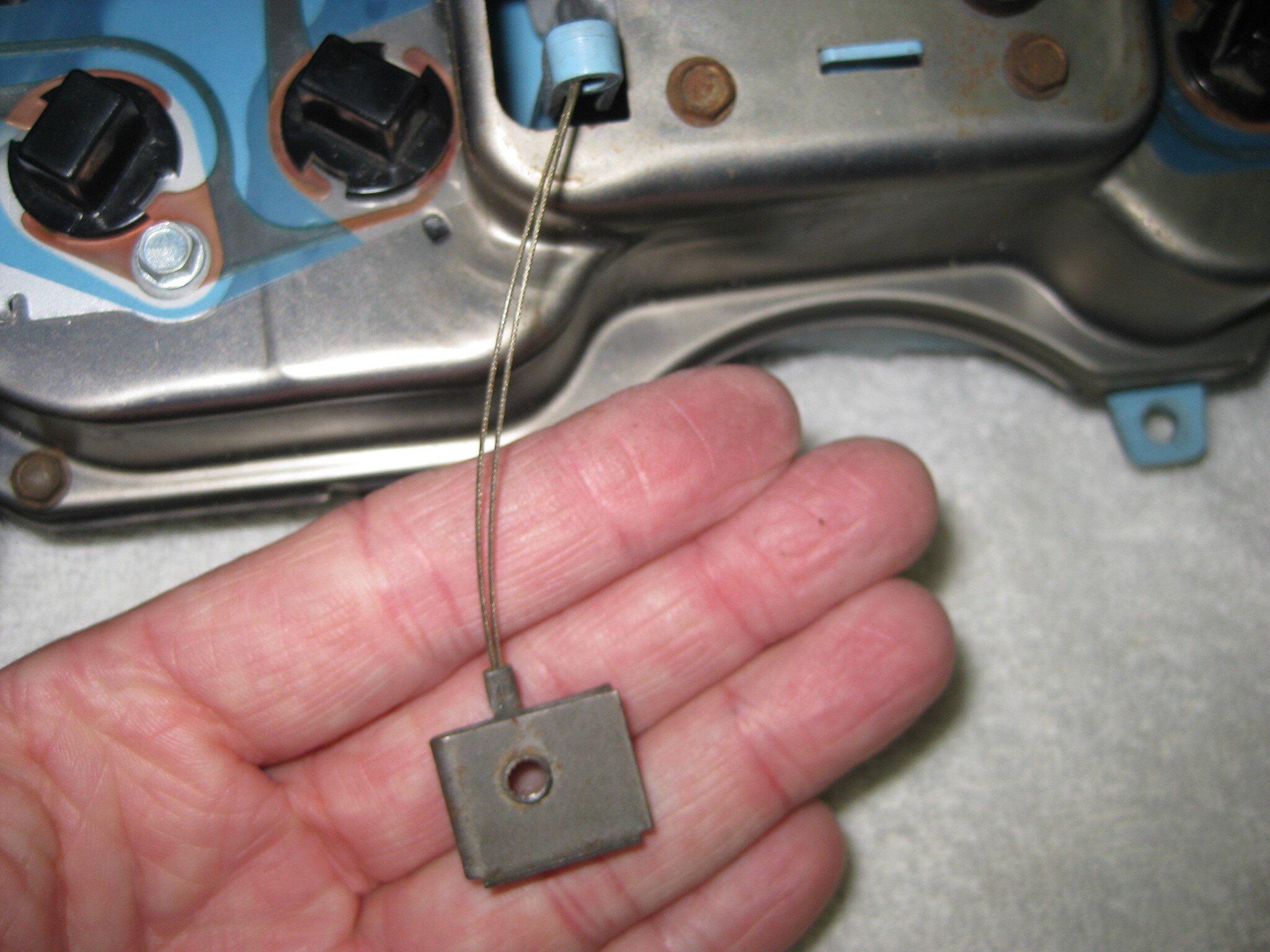

stangeba Posted April 29, 2016 Share Posted April 29, 2016 Someone here has that procedure written down very nicely. I have removed my 71 entire dash 3 times over the years but never just "leaned" it back to remove the cluster. Be careful, the plastic is brittle. I have a shifter on the column so the little wire that makes the PRND12 move is of high priority. Looks like you have a floor shifter so that may not be an issue. Here are some pictures that may help. I have a 71 with factory gauges, NO A/C, Stereo two speaker dash pad. Bruce 1 Quote Link to comment Share on other sites More sharing options...
