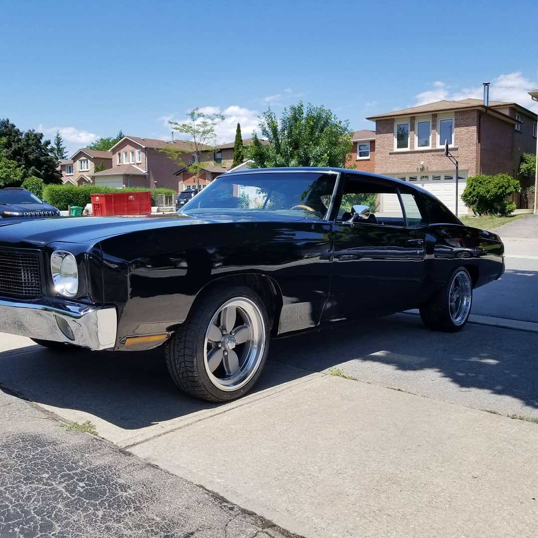

ChrisM Posted July 21, 2018 Author Share Posted July 21, 2018 Hey guys, so these are the wheels I went with, us mags. 18x8 in the front 235/40 rears are 18x9.5 275/45. No trimming required and looks like a great fit! Thanks for all the advice!!! Quote Link to comment Share on other sites More sharing options...
MC1of80 Posted July 21, 2018 Share Posted July 21, 2018 Congrats!!! Looks good! Reminds me of the old school "Daisy" style rims. Quote Link to comment Share on other sites More sharing options...
72-CLASSIC_RIDE Posted July 21, 2018 Share Posted July 21, 2018 Those look awesome! Doug Quote Link to comment Share on other sites More sharing options...
