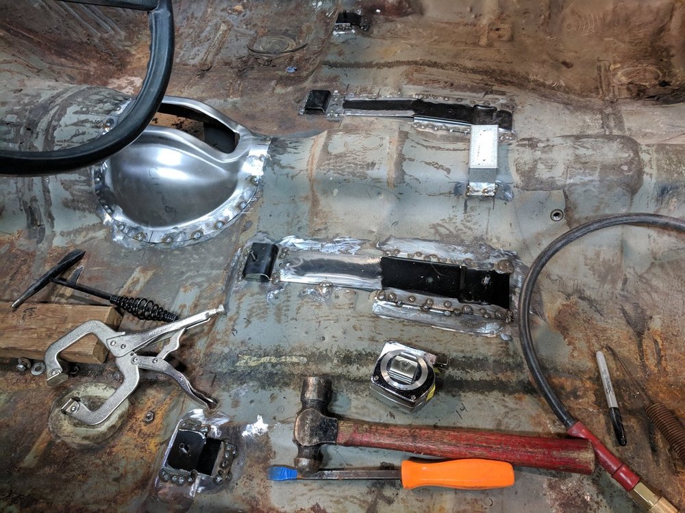

Like said, new seats are available but are expensive. Expect to pay $300~$600 for a used pair plus shipping and you’ll need to have them upholstered to match the Monte interior. All the plastics, seat sides & backs, console and console lid are offered as reproduction parts as are door & side panels. Black is easiest and the aftermarket only offers headrests in black. Also mentioned above, weld in brackets for bucket seats and floor console are available. I suggest you use the seats to locate the brackets for welding, don’t do these by measuring.
I have a PDF that shows where all the brackets for the console goes. If you’re like me and you can’t weld to save your life, the brackets can be bolted in with extra flat head bolts poked up from the bottom, undercoating covers them nicely.

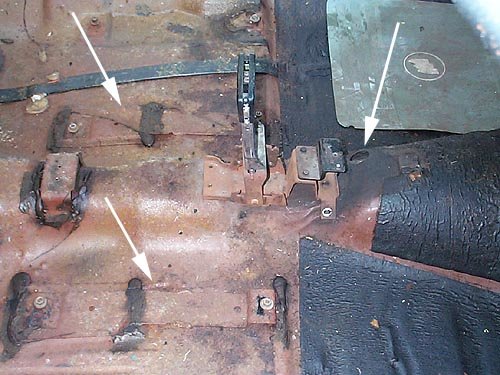

If okay to ask, what about just bucket conversion. I will be using a hurst floor shifter no center console. I want to use some buckets from a 70s olds/Pontiac.  Do I sit them in and Mark them them weld in supports for holes?
Share this post
Link to post
Share on other sites

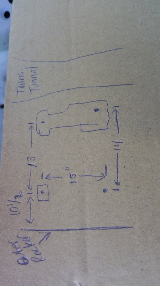

Here are some measurements my brother and I took from an original bucket seat car. The only original seat mount hole you will use is driver's side rear so use that as a measurement point. Good luck

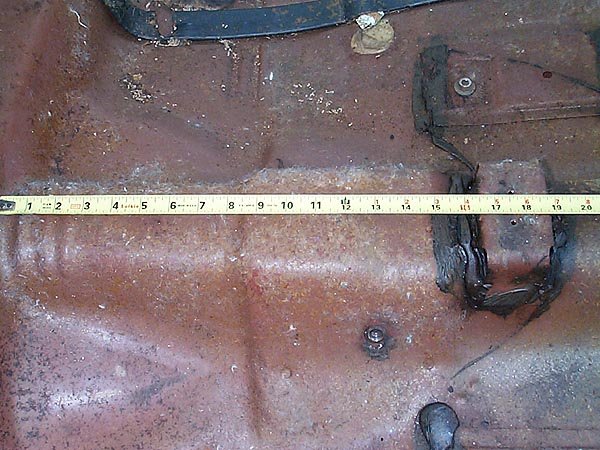

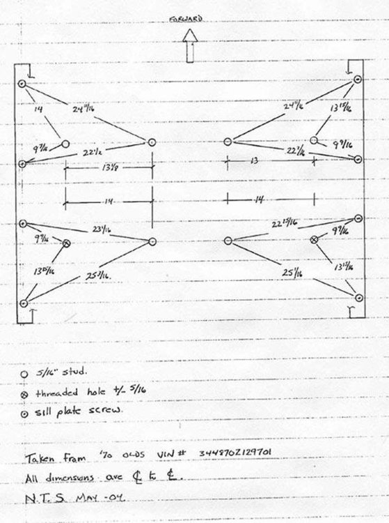

I found this years ago when I thought of doing it, never did.
The buckets I bought were from a 72 that did NOT have a center counsel, so that is easier to do.
