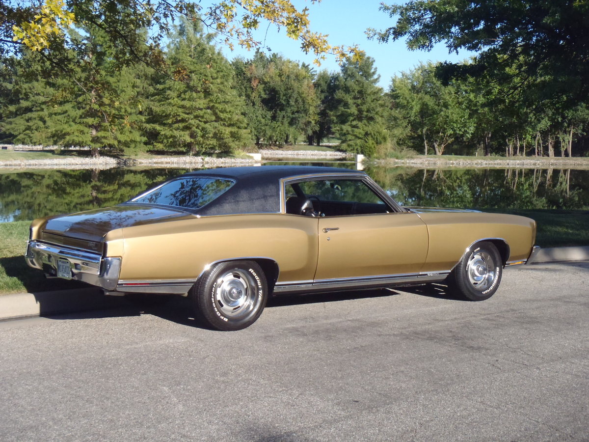

1970 Monte Carlo
Front: 15x7" rally wheel; 4.5' back space; 255x60-15 BFG (1" spacer in front coil prevents rubbing)
Rear: 15x8" rally wheel; 5" back space; 275x60-15 BFG (3/4" sidewall clearance with fender well - no trimming or rubbing)

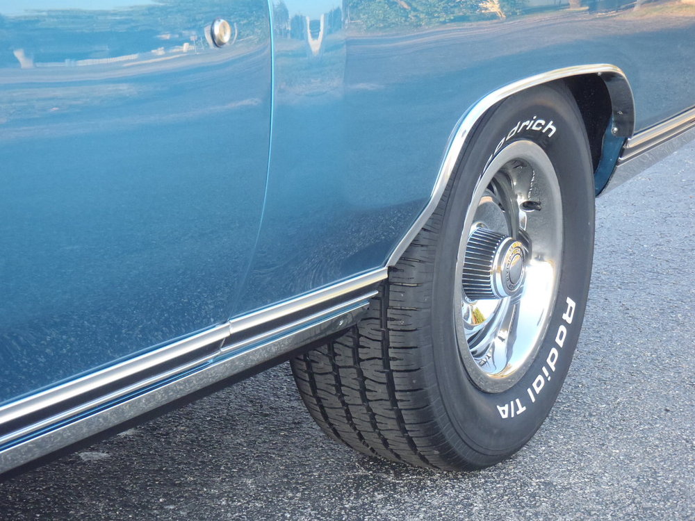

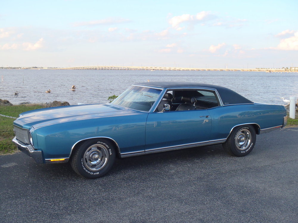

1970 Monte Carlo SS454
Front: Stock15x7" rally wheel; 245x60-15 BFG
Rear: Stock 15X7" rally wheel; 245x60-15 BFG

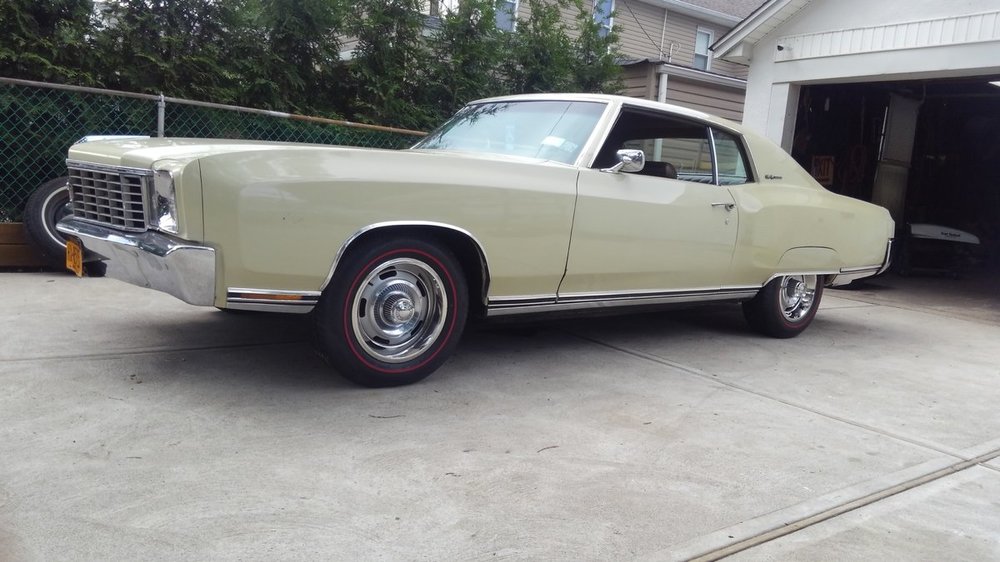

1986, My 71 stock rally wheels fresh from painting and new (now replaced) GR70x15 UNI-ROYAL SWS tires.

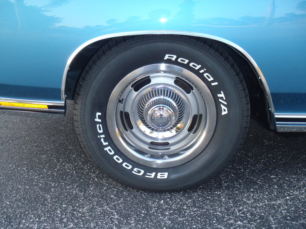

Wheels are a tricky thing.
The rally's with 4 inch  backspace were outward
The American Legend 4.5 backspace were inward
Wheels & Tires
15 X 8  4 Inch Backspace Corvette Rally wheels. (All 4 Wheels)
245-60-15 (All 4 Wheels) BF-Goodrich
17 x 8  4.5 Inch Backspace American Legend Racer (All 4 Wheels) (Custom Powder coated)
Fronts 245/45/17  BF-Goodrich
Backs  255/45/17  BF-Goodrich
