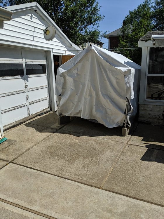

As most of you know, I purchased a 71 402 auto Monte Carlo in October of last year. Upon getting it home my brother and I promptly tucked it away for a LONG winter's nap.
We have alot of "stuff" going on and this Monte had to wait. Well guess what!? The wait is over! Lol we got her out of her cocoon and got the ole girl running!

Nice going Tom, she looks to be in great shape. Good Luck with her.
