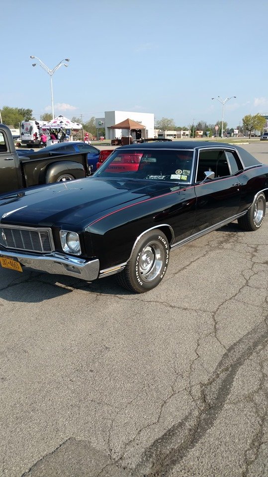

Hi guys, thanks for accepting me on the board.  I have 71 Monte i purchased in September 18, and I've been enjoying it since.  it has a 350/350 in it, and 10 bolt rear.  I just had the trans gone through and an Eaton Posi and 3.73 gears put in the rear.

Thank you all in advance picture below is Big Rhonda

Hi Patrick. Nice ride.
