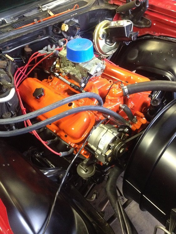

I've thought of changing my 355 to a 383 stroker, since I have a given 427BBC to me,(was a blower motor) that's what is going in mine. keeping it old school (.550" lift cam) and adding EFI with a built turbo 350 and 3:73 gears( bolt -in ford 9"). Had this set-up in a '72 Nova way back in '84 ,and just had a great time in that car for some time. Of coarse it had 4:10 gears with 12" wide,(tubbed)31" tall treaded dirt car tires on it for traction. back then N.C. was pretty lenient on tires. I believe the 3:73 gear will give me a little better street manners. 383's are quite the torque motor and are a good fit for our "big" cars. remember you also have to not the bottom of the cylinders for the rods to clear. You can go different on the heads too.AFR are expensive. just go with 64cc chamber with 2.020" /1.600" valves. make sure they are stainless valve and have hardened exhaust seats for unleaded fuel. Performer RPM intake and 750 will work well.post-259-0-61935100-1474727657_thumb.jpg
