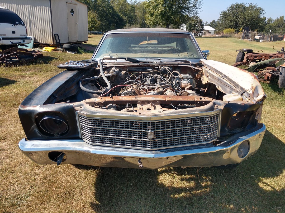

Went and picked up an SS 454 in Paint Rock AL. Kansas car, very little rust if any. Factory no vinyl car. Black on black.
Plan to get it up and running. Possibly restore then sell. Of course it will be available at any time if someone wants a project.

Looks like a spare grill in the interior.  Is the one that is mounted on the car trashed from the front drivers side accident?  You didn't say so are we supposed to assume it is all numbers matching?

It's a Flint built car. Kansas it's whole life
I bought it from paint Rock AL, guy bailed on building a 70 SS Fake shovel. He had it shipped from Kansas.
The engine is a 73, but all the brackets are correct and nothing missing. All the air ride stuff is here. Pictures from this stage of condition will help document it's authenticity.
I'm hoping the transmission is original with the code. Where was it I look for that?

The VIN should be stamped in the side of the case on a pad just above pan on driver's side near shifter selector. Good luck with it.

Engine is 1973 as told
Transmission is 1968
So it's a real SS with without original drivetrain.
The 12 bolt rear has the limited-slip tag on it so that was a pleasant surprise.. also the leveling valve is mounted above the rear end as it should be.
