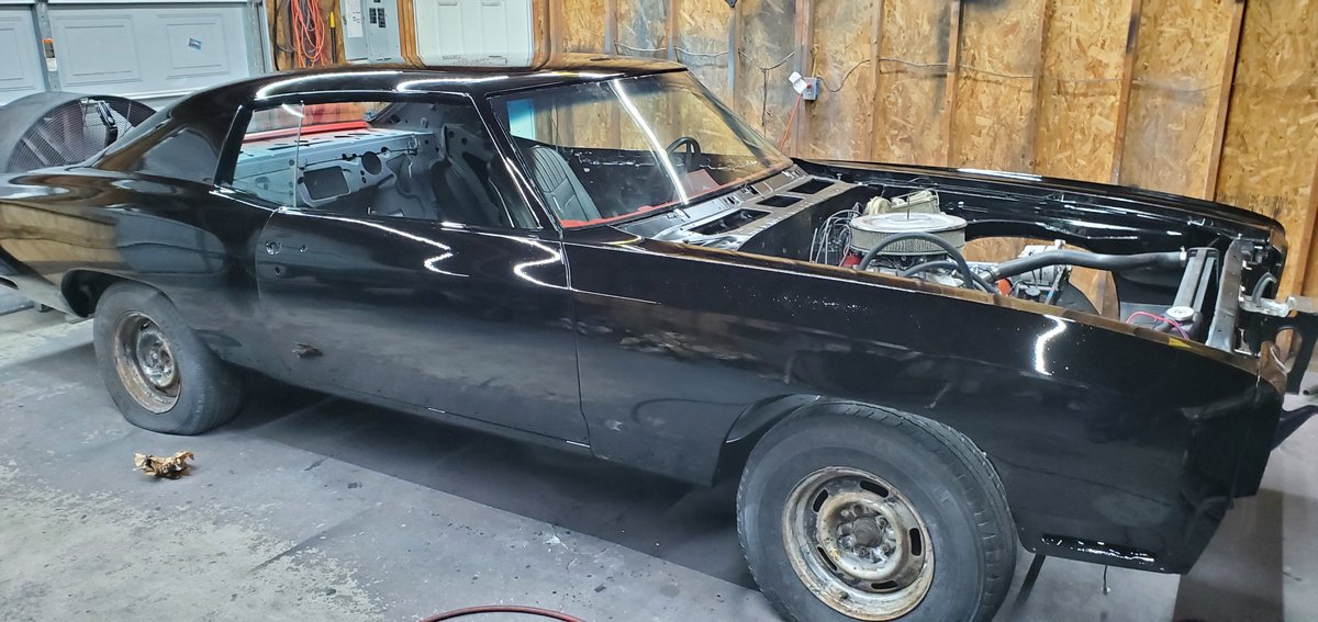

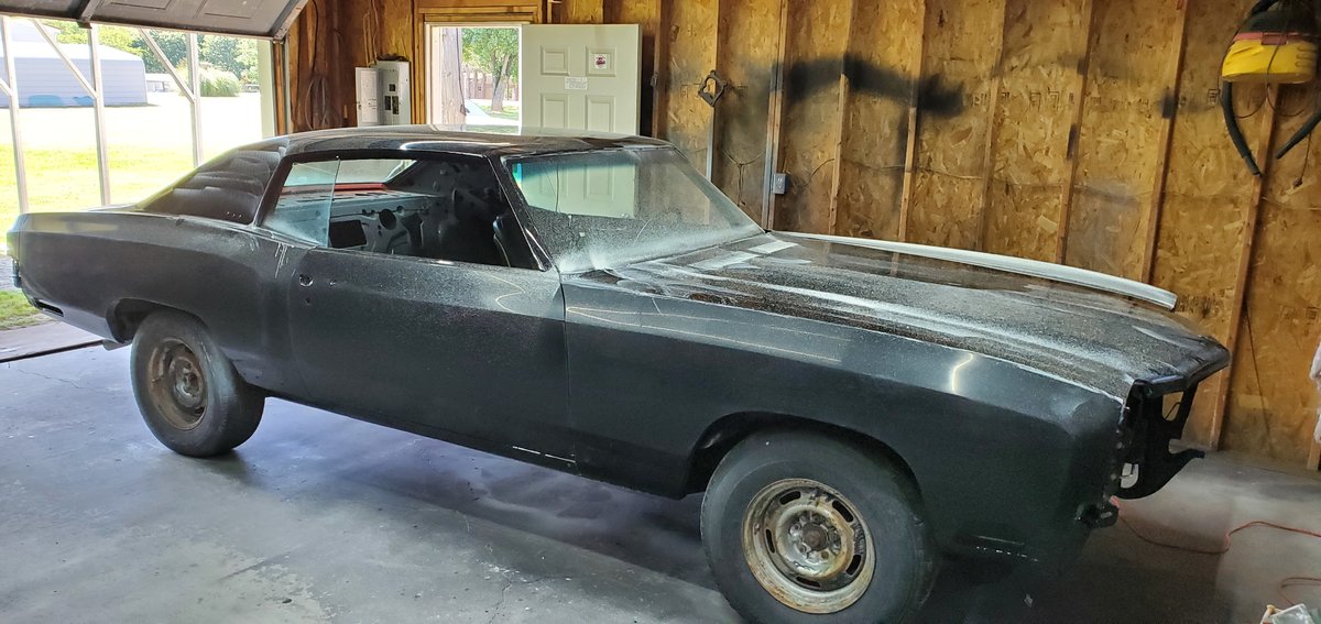

Jared Richey Posted April 18, 2020 Author Share Posted April 18, 2020 Crap just got real. Its ready. Thanks Kevin for the help over the last several weeks. His 70 c10 truck will be ready for paint soon too. We've been alternating days at each other's place . My goal was paint by may 1st. Its getting it this weekend 🤪 1 Quote Link to comment Share on other sites More sharing options...
Jared Richey Posted April 18, 2020 Author Share Posted April 18, 2020 The paint job made simple: Blast or strip, epoxy, bodywork, more epoxy, 2k, block 320, fix booboos, more 2k on booboos, paint jambs, sand booboos 320, assembly, panel alignment, . Fix last minute booboos (pin holes, etc) Mask it, continue to look for booboos, wipe it down, tach cloth, epoxy sealer. Basecoat , Clear Coat Breath 2 Quote Link to comment Share on other sites More sharing options...

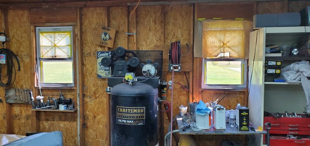

Jared Richey Posted April 19, 2020 Author Share Posted April 19, 2020 Thanks everyone. This is my setup Big barrel fan.. Compressor with a wall mount filter and water trap..Simple but works. Windows open. With a screen, keeps bugs out. My $300 Fan flows a lot of air. Wet the floor and let's roll! 1 Quote Link to comment Share on other sites More sharing options...

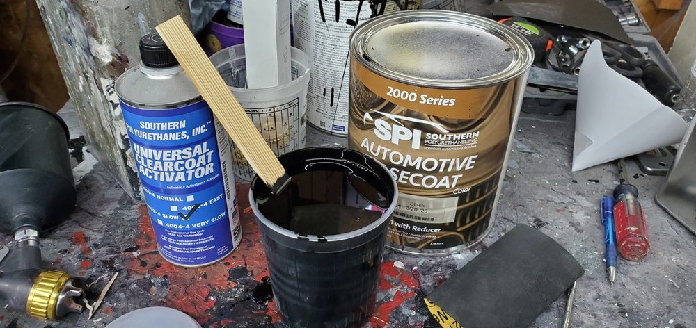

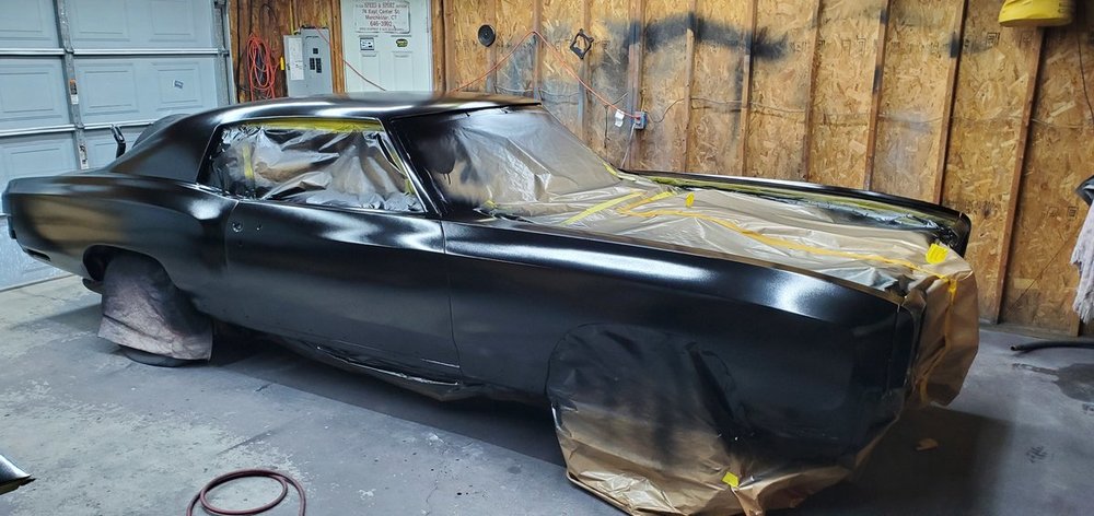

Jared Richey Posted April 19, 2020 Author Share Posted April 19, 2020 SPI Black Basecoat $175ish a gallon with SPI Slow Reducer $45ish gallon If you have never heard of SPI or Tamco I SUGGEST LOOK EM UP ASAP. Quit paying for race car sponsorships! No other fillers. True Black, All Black! 1:1 Slow Reducer. 1 cap full of Clear Activator! The SPI 2k High Build is $180ish a kit 4:1 mix just Fyi 1 Quote Link to comment Share on other sites More sharing options...
Jared Richey Posted April 19, 2020 Author Share Posted April 19, 2020 First time painting with hood off the car. Quote Link to comment Share on other sites More sharing options...
Jared Richey Posted April 20, 2020 Author Share Posted April 20, 2020 SC unpredictable temps this time of year. Cold all day. No paint. Struggled to 50s. Quote Link to comment Share on other sites More sharing options...
Jared Richey Posted April 21, 2020 Author Share Posted April 21, 2020 5 coats of SPI Universal Clear Quote Link to comment Share on other sites More sharing options...

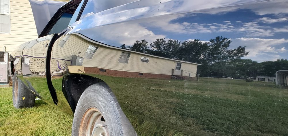

Jared Richey Posted April 21, 2020 Author Share Posted April 21, 2020 Peeled the tape tonight WOW!!! ITS DEEEEEEP Quote Link to comment Share on other sites More sharing options...
Jared Richey Posted April 22, 2020 Author Share Posted April 22, 2020 Cut 600. Started 1000 Thanks again Kevin. Back on his truck at his place tomorrow. Following Tru Bloxx instructions. Quote Link to comment Share on other sites More sharing options...

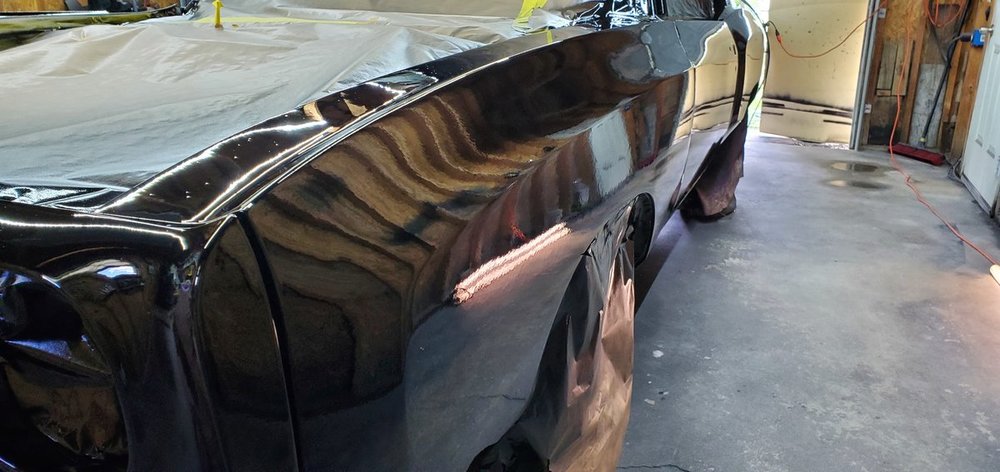

Jared Richey Posted April 28, 2020 Author Share Posted April 28, 2020 Got the compound step done today after a week of... 600 1000 1500 2000 2500 3000 Tru Blox blocks with 600 and 1000. Sponge on 1500-2500 3000 trizact pad All by hand.. this pic is earlier today Quote Link to comment Share on other sites More sharing options...
Jared Richey Posted April 29, 2020 Author Share Posted April 29, 2020 After 3M Runbing Compound on a foam pad. Then 3M polish on a foam pad. Once I get the car together I will do some more paint correction with my dual action polisher. Still a lot of work to do but we are on the downhill slope! 2 Quote Link to comment Share on other sites More sharing options...

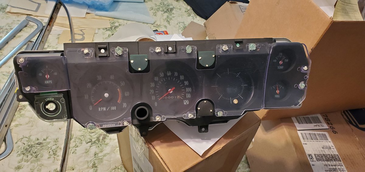

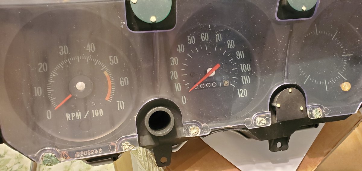

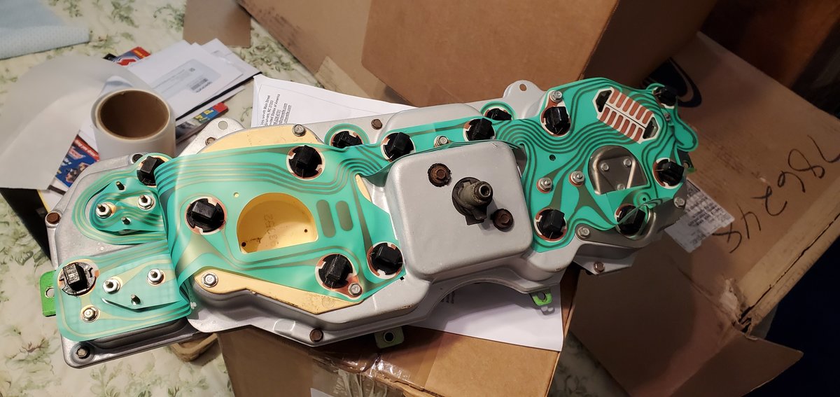

Jared Richey Posted April 29, 2020 Author Share Posted April 29, 2020 Refurbished gauge cluster from Larry Eady. Clock Delete Can't beat original. Quote Link to comment Share on other sites More sharing options...

RealRed70 Posted May 1, 2020 Share Posted May 1, 2020 It looks like your gauge cluster lens could use a good polishing to really make it pop. 1 Quote Link to comment Share on other sites More sharing options...
danny_discus Posted May 1, 2020 Share Posted May 1, 2020 Car is looking good Jared 2 hours ago, RealRed70 said: It looks like your gauge cluster lens could use a good polishing to really make it pop. What does one use to polish the plastic on the gauge cluster? Quote Link to comment Share on other sites More sharing options...

Jared Richey Posted May 1, 2020 Author Share Posted May 1, 2020 1970.. no SS on rear. Camera lens makes cluster lens look foggy from glare, actually extremely clear Quote Link to comment Share on other sites More sharing options...

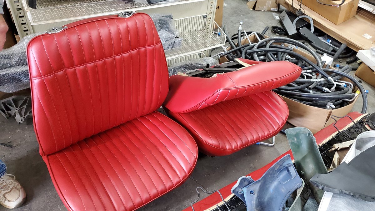

Jared Richey Posted May 1, 2020 Author Share Posted May 1, 2020 This is what the entire build was based on... RED INTERIOR Done in 1970 chevelle Red Color in 1970 Monte Carlo Pattern. Door Panels were a special order. Seat covers were hand sewn so much better than covers, plumped up with definition unlike cheap covers and the bolstered foam kit. Quote Link to comment Share on other sites More sharing options...
