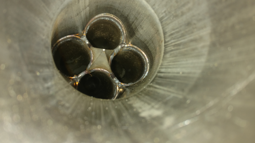

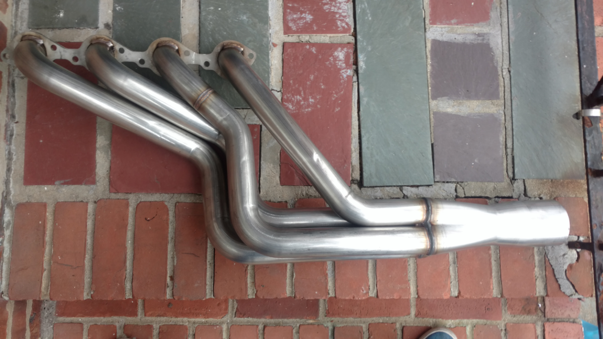

There's some roughness where the bender's collar grabbed the tubing. I'll knock it down with some Scotch Bright.
While these headers are exactly as I expected them, they can use a little buffing up.
I was originally told the collector was ball and socket design and they would include a coupling, they are not, they are slip-fit, which I kinda preferred.
They asked what port shape and size my heads had so for now, I'll assume they match.
The collectors have the merge spike in them.
As discussed, they do not include gaskets. They do include a pair of clamps for the collectors and header to head bolts-which I'll not use because I stud my headers.

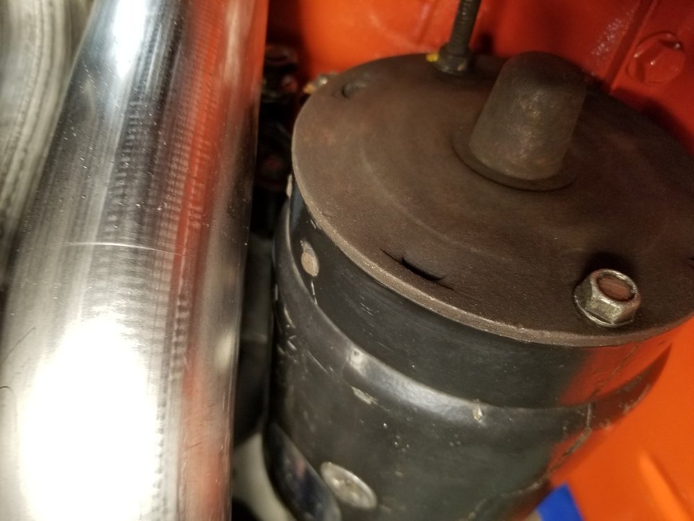

Oh, also put the stock starter up there. It's a little close, but fits. The #2 tube is sort of close to the battery terminal, maybe an inch & about 1/2"  from the same tube to the body of the starter. I'll still probably get the mini-starter that ARH recommended.

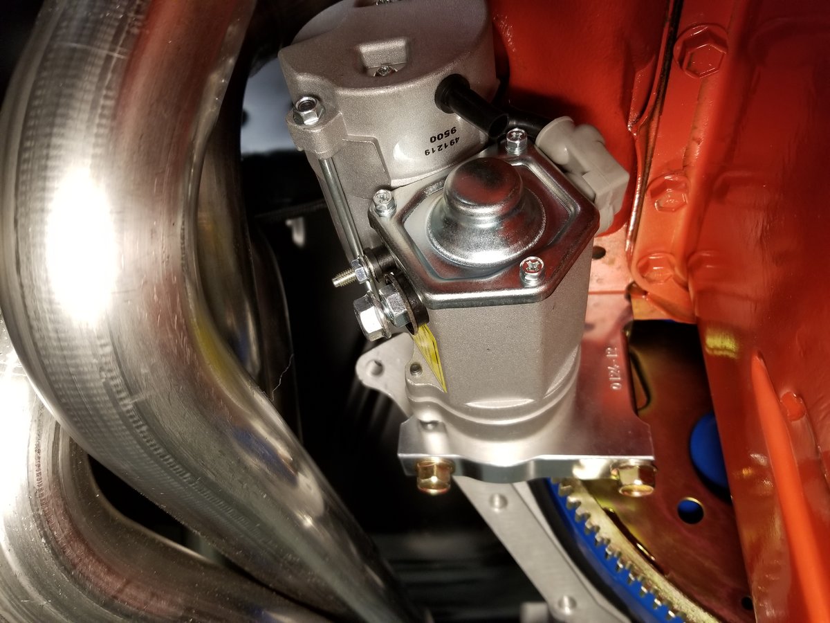

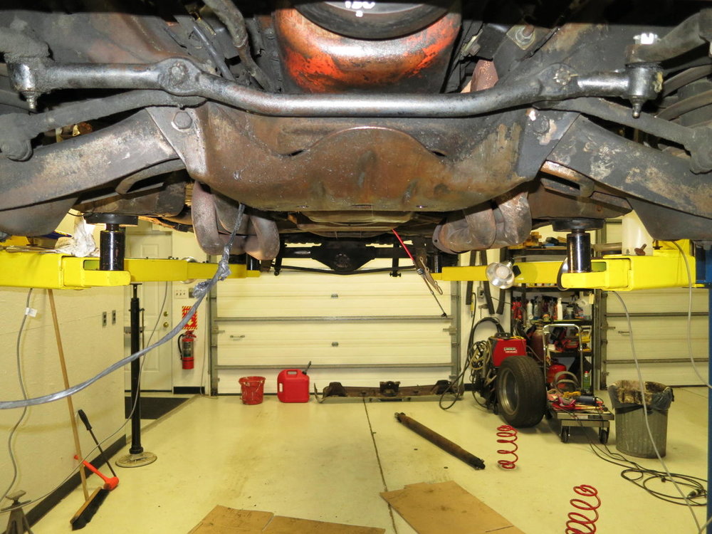

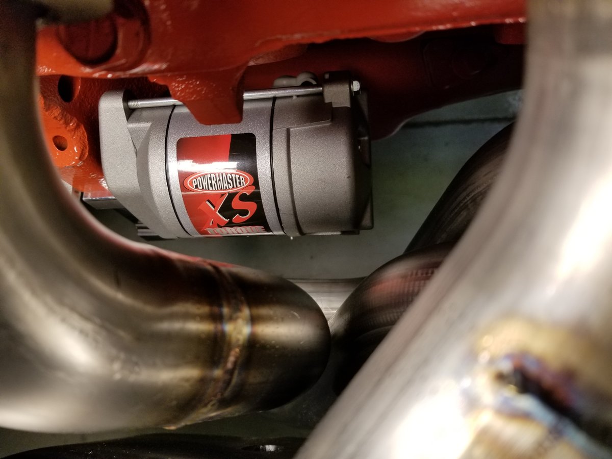

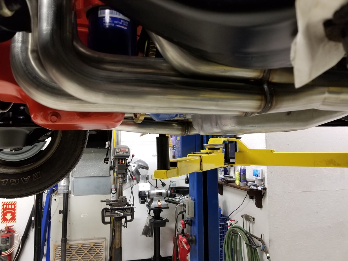

New starter came in today, huge size difference. I still think a stock one will work, but it's close to the tubes and may cause heat issues in some cases. Maybe a heat shield would fit, but I didn't try. Below are pics of the starters, and how far the ARH headers tuck up.
The last 2 are of the Hooker Super Comps for comparison. First is before I moved the one passenger side tube to raise it a bit. Still, they hang a LOT lower than the ARH set. Using the engine oil pan as a reference, the Hookers are an anchor in comparison, they hang so low.
