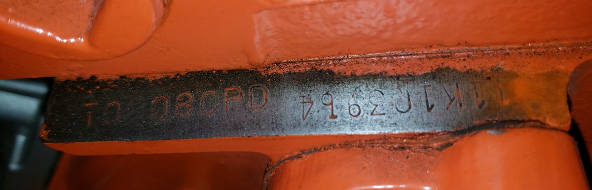

Searsman Posted December 7, 2019 Author Share Posted December 7, 2019 56 minutes ago, ripleydale said: Here is my Kansas City block stamp. You can see the letters Thomas is talking about. I see, was afraid to scrape further .. is that under alternator or down next to oilfilter? Is that a 71?.. I’ll check it out next time I get under there... once I saw the sn I didn’t look for anything else cause it’s so rough...thanks... Quote Link to comment Share on other sites More sharing options...
Searsman Posted December 7, 2019 Author Share Posted December 7, 2019 21 minutes ago, Searsman said: I see, was afraid to scrape further .. is that under alternator or down next to oilfilter? Is that a 71?.. I’ll check it out next time I get under there... once I saw the sn I didn’t look for anything else cause it’s so rough...thanks... Ok, I see part of the water pump on your picture, the letters you mentioned are to the left of the vin serial number.. now I know where to look, thank you sir. 👍🏻 Quote Link to comment Share on other sites More sharing options...

LS5 Posted December 8, 2019 Share Posted December 8, 2019 Yeah that Block has been restamped, that is not the correct Font in letters and correct spacing that we used at GM. Bad enough to tell its a restamp but could be someones attempt at restamping an original block that happened to have been decked before they asked for the machining to be tilted on the end run so the factory stamp remains.... Darren Quote Link to comment Share on other sites More sharing options...
overdrive Posted December 9, 2019 Share Posted December 9, 2019 I have the same block from Kansas City. It has the same font, and I've seen others just like it. The first part of the stamping was done at the Tonowanda engine plant. The second stamp was done at the assembly plant and it's not unusual for the Kansas City plant to stamp theirs "upside down". The Tonawanda stamp on mine was struck twice. Dan 1 Quote Link to comment Share on other sites More sharing options...
