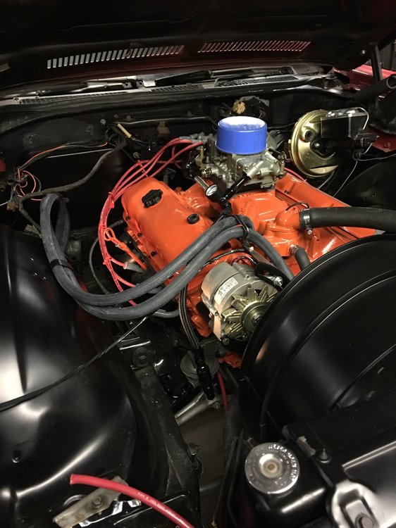

IMG_0036.thumb.JPG.77fc2d473470443a5d200a05b427f214.JPGHi, hope this helps,
1. I have used the Mallory comp 140 on a few of my projects. Great, quiet pump!  I ran -8 line aka 1/2" line all the way from tank to carb.
2. I have the RobbMc 1/2" sending unit in my 70 SS with a 496. It has the return line but is capped off because I am running a mechanical pump.
3. Your fuel system layout is good. Get a good filter. I'm running a 10micron cleanable filter. Meaning I can disassemble the filter, clean the screen and reuse. I only use one filter, between the mechanical pump and the carb. (Zoom in on pic to see the filter.)
The 850 carb is a good choice. I am running a Holley 950HP on my 496. These engines love fuel! I have 1/2 line from the RobbMc sending unit to the carb. No issues at all. I have hot lapped the car at the track 4x in a row and have had no issues.
4x in a row, made a run, up the return road, right into the burnout box, made another... You get the idea. Lolol this was also at a test and tune. No waiting.
Hope this has helped.

IMG_0124.thumb.JPG.68df9b98ef6f5748095d60e9e0cd0a71.JPGDepends on the type of line you are using. Steel or cloth. I ran cloth style 1/2 line from the fitting on the  RobbMc sending unit all the way to the pump. Then from the pump to carb.
I removed the front half of the original fuel line to run the 1/2 fuel line like the factory did. That the only somewhat difficult fitting to get. Zoom in on the pic I posted earlier, you may be able to see.
Found the above pic to show what I mean. Also, I believe it was necessary to "clock" the body of the pump to the desired position.
