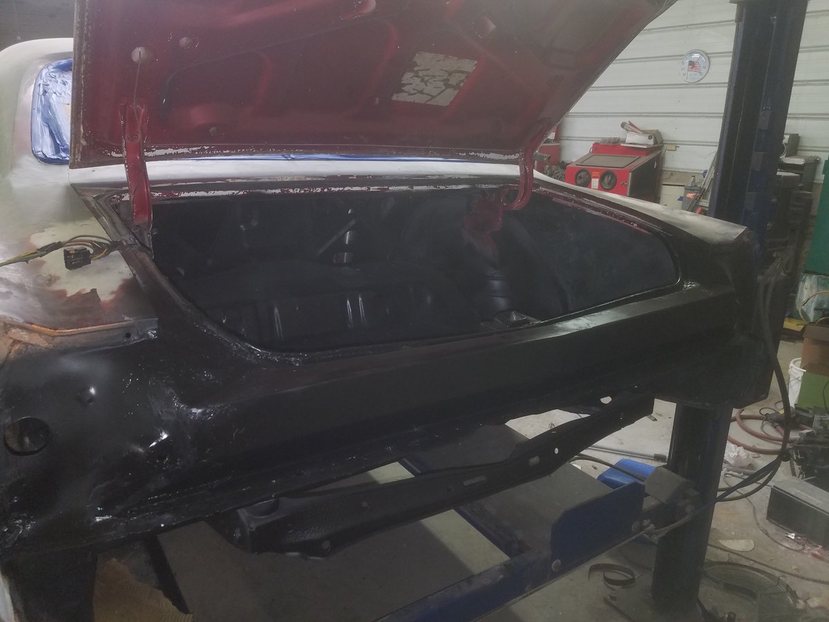

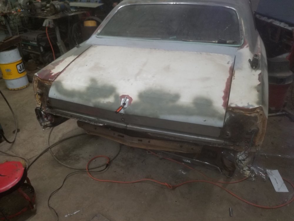

Forgot to include the picture of the trunk closed, lined up perfectly.
Truth? I would have found a 70-72 Monte rear panel and put it in. In the long run it'll come out more accurate, take less time & work, everything will fit properly/not leak, and you can put your v
Well I spent the week slowly but surely making 2 identical pieces. Today drivers side went in. I think it's looking good! Definitely have some issues that I'll have to make sure to address. I'm thinki

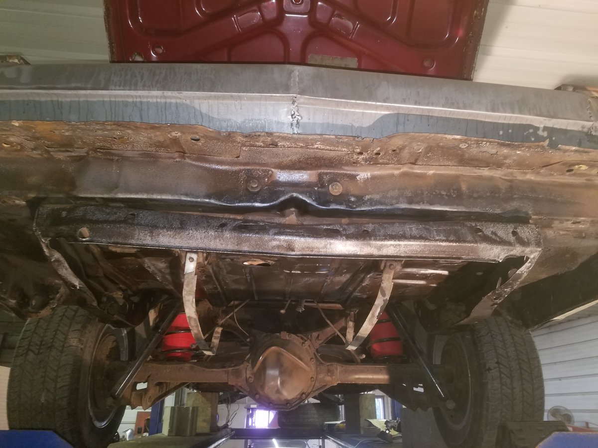

I've been spending the last several weeks cleaning out the inside and undercarriage with wire wheels, putting in floor and trunk patches. Recently used Ospho on the inside and undercarriage. Sadly all my days off have landed on the wintery spring days we've been having. As soon as it's nice out I can neutralize and epoxy, hopefully next week.  For now, I figured since I've got the car on the lift, I'd take a lower rear picture. Post Ospho.

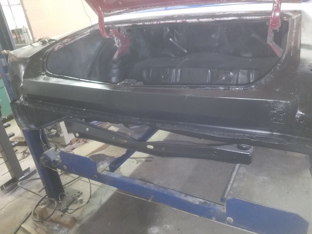

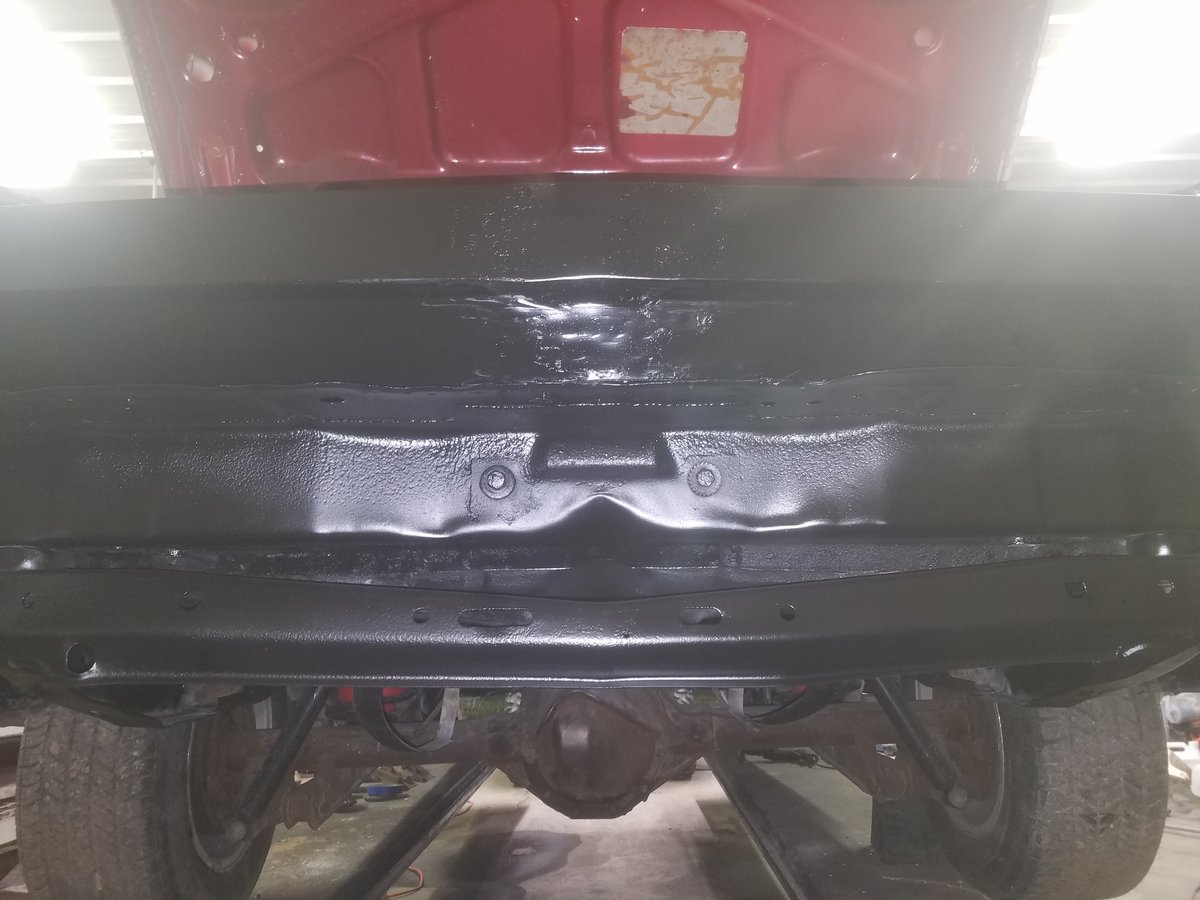

Alright,  this will probably be my last update to this thread. Epoxy on the repair, then some fiberglass body filler (upol fibral lite) with epoxy over top. Personally, I rushed it a bit but I don't care! I could have spent the time to perfectly shape the filler, but being that it will mostly be hidden...
Now when I eventually get around to blocking the whole thing I might take the time to perfect it but for now its good enough for me!
