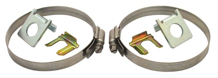

Welding the tabs on to the axle tube would  be the easiest option. Otherwise, you would have to fabricate a clamp to go around the axle tube. Something like a 3" exhaust clamp with the brackets welded to the clamp might work pretty good and would be removable.

Maybe JB Weld might work. Those clips just sit on the top tube.

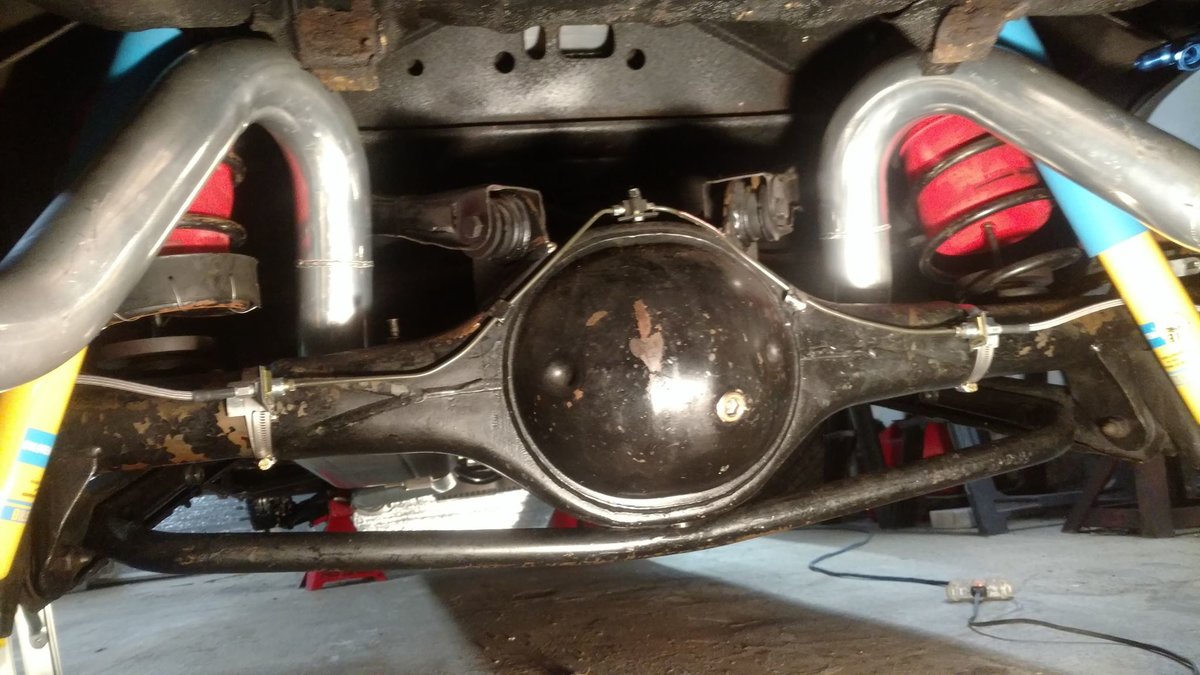

I have a kit from The Right Stuff that used my existing clips and I just made the hard lines so the junctions are just on the other side and are held securely. No welding required and no clamps to be seen. Ill take a pic later if you want to see.
