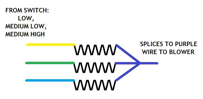

The tan, light blue and yellow wires from the blower speed switch each feed power into one of the resistors. Each resistor is then tied together and comes out of the resistor connector as a dark blue wire which splices in the harness to the blower motor wire.
When you go to high speed, none of the resistors are powered. A dark blue wire from the blower speed switch sends power to the coil in the underhood blower relay which closes and sends full power to the motor.
In low, low medium and medium, the motor, through the blower speed switch and resistors, is powered from the dash fuse block heater/AC fuse. When in high speed, it's powered from the relay which has the separate underhood fuse fed from the horn relay buss.
Question for you: Are the four wires in the resistor plug or has the plug been cut away and you just have four loose wires?

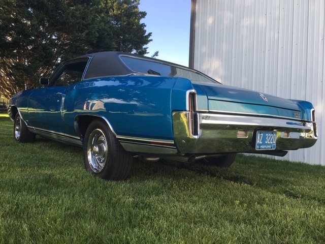

thanks - nice car too....i finally got mine done after almost 3 years...
