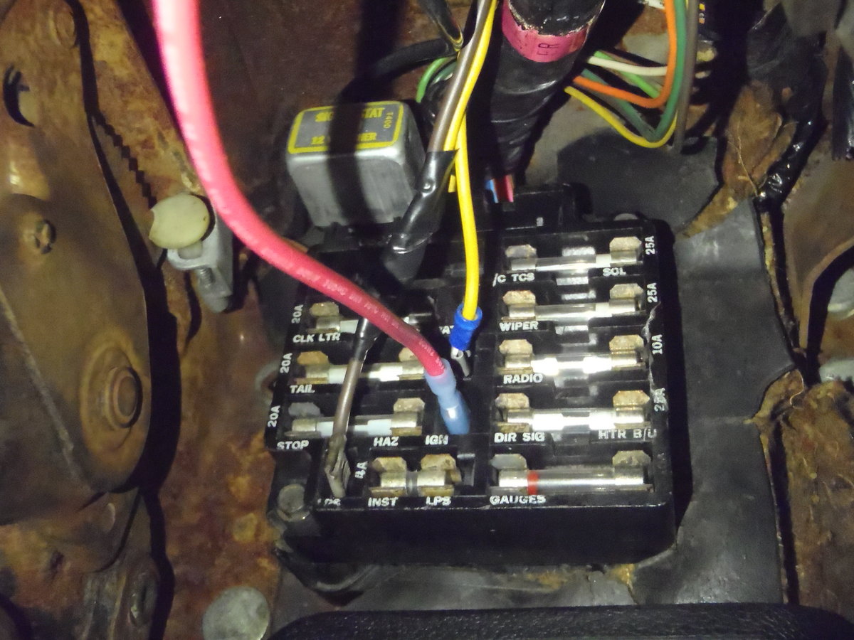

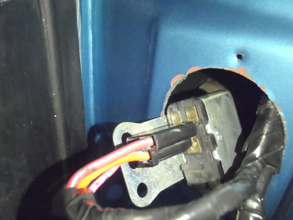

Mark,
I hope the photos below are useful.
1st photo: The 3-wire connector plugged onto the relay (Orange/Black = 12V into relay from power source; Red/White = 12V out of relay to regulators; Pink = relay trigger wire from IGN port on fuse panel)
2nd photo: Orange/Black wire is connected to the power source (mine is a 30 A-fused port on an auxiliary fuse block fed direct from the battery).
3rd photo: Pink wire is plugged into the IGN port on the main fuse panel.  This triggers the relay only when the key is turned on.  You should be able to find this pink wire coming out of your new wire harness somewhere near your main fuse panel.  If you don't have the pink wire plugged into your IGN port, the system will not work because the regulators cannot get power from the unpicked relay.
To bypass the relay (for testing only), I would unplug the 3-wire connector from the relay and insert a 10 gauge jumper wire into that connector between the Orange/Black wire (be sure it is NOT connected to a power source yet) and the Red/White wire.  Now find the other end of the Orange/Black wire in your harness and connect it to a good 12V power source.  You should now be able to operate any of the window regulators with their respective switches.  By jumpering the power IN (O/B) and power OUT (R/W) wires, you are effectively bypassing the relay which would normally make this same connection when the ignition is ON (IF the relay is operating correctly).  Good luck.

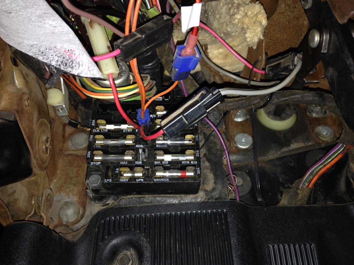

Thanks.  I do have a pink wire that is hanging in the breeze.  My fuse box is different than yours.  I'll post a couple of pictures.
Share this post
Link to post
Share on other sites
I think that pink wire is the one you are talking about.    If so it doesn't have the right type of connector to plug directly into the IGN on the fuse panel.

Mark,
Let's be sure we're dealing with the correct pink wire.  Have you done a continuity test on the loose pink wire shown and the pink wire in the window relay connector? If there is not continuity, you need to trace the pink wire coming from the relay connector back to it's other end, wherever it is in the harness.
Assuming that is the correct pink wire, the connector shown is exactly like the one used for the factory power window relay on my '70 SS (see photo below) so it is not "wrong", it just plugs into the factory harness with that connector and gets the IGN signal through a different circuit (possibly from a splitter that serves other power options as well).
When I installed factory power windows in my low-option '70 402 (with minimum wire harness), there was no connection in that original harness for the pink wire so I crimped a female spade connector on the end and went directly into the IGN port.
Since the connector you have probably won't plug directly into your fuse box, I suggest using a test lead to temporarily connect it to the IGN male spade connector in the fuse box and see if your windows will operate after you turn the ignition on.  If that works, then you could replace the "factory" connector on the loose pink wire with a female spade connector and hook it up that way.  Alternatively, I would look for another loose pink wire in your new harness that has a mating connector to the one you have already found.
