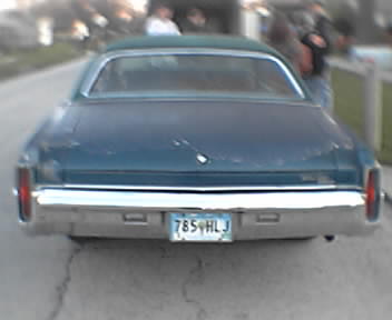

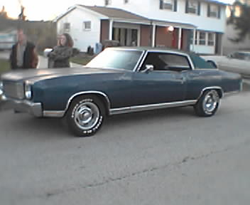

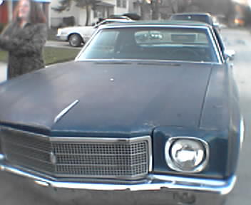

P.S. Here are some pics of the car as we took her off the trailer over in Champaign:
Because of the 10 bolt rear in the car, it was probably a 350 2-bbl car to start with. In the pictures it has no A/C so it would have had the smallest radiator available from the factory and would have probably had the 3 bolt radiator cover from the factory. HD cooling etc would get bigger radiator and radiator cover. Just a thought.
it has a/c on it.... the compressor is on the drivers side.... the primer and activator is 60.94$ and for all the stuff needed for paint including the primer is 242.91$ plus tax... the body bushing kit is available with hardware for 80$ from muscle cars only...your car is painted fathom blue so we can repaint it that color if you want.
Well that's not bad at all for paint and materials! I do like that blue... But how expensive would the blue they use on todays Dodges be? I really like something like that... A really blazing eye-popping blue...
What do you people think? (Anyone... The astro-blue, a real bright dodge-like blue... Maybe just black??)
And with all the problems Alex listed earlier... What do we expect this is going to take? I'm only trying to plan it out...
Keep me posted, and thanks again guys!
add on ac , the car was originally a non ac car from the picture of the firewall
