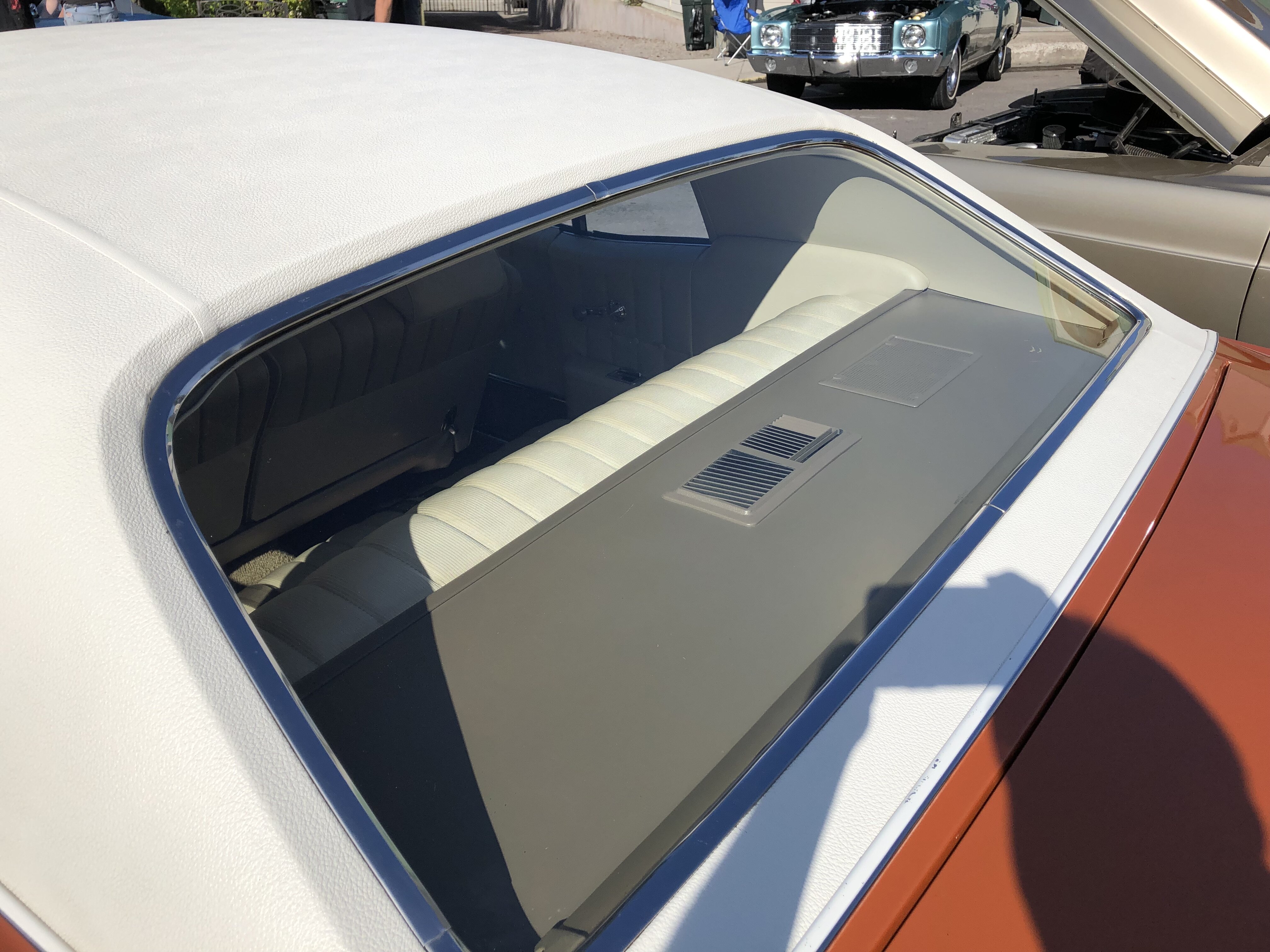

Canuck 781 Posted August 23, 2020 Share Posted August 23, 2020 Here's an original unrestored car. sbarnette 1 Quote Link to post Share on other sites

Paul Bell 256 Posted August 23, 2020 Share Posted August 23, 2020 The vinyl break moldings are painted the color of the roof. In the case of a two tone painted roof car, the vinyl break molding is also painted the color of the roof. It's a flat or almost flat color. Difficult to get paint to stick because it's stainless. Buff them up, clean and warm and shoot first with a self etching primer. The color codes for these moldings are at the bottom on the 1970 paint chart here in our technical section. https://www.firstgenmc.com/forums/index.php?/resources/paintcodes/ RODS70BB, sbarnette and Canuck 3 Quote Link to post Share on other sites
