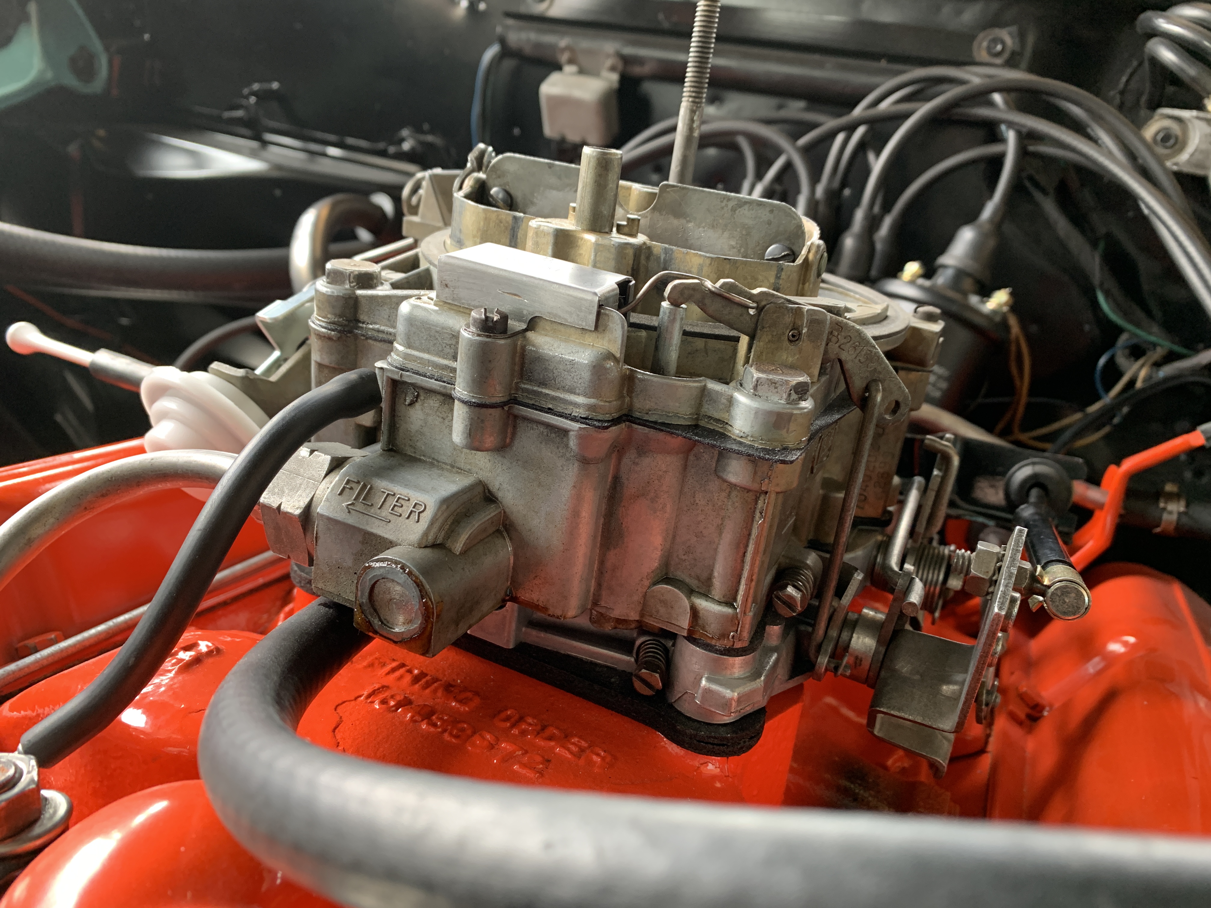

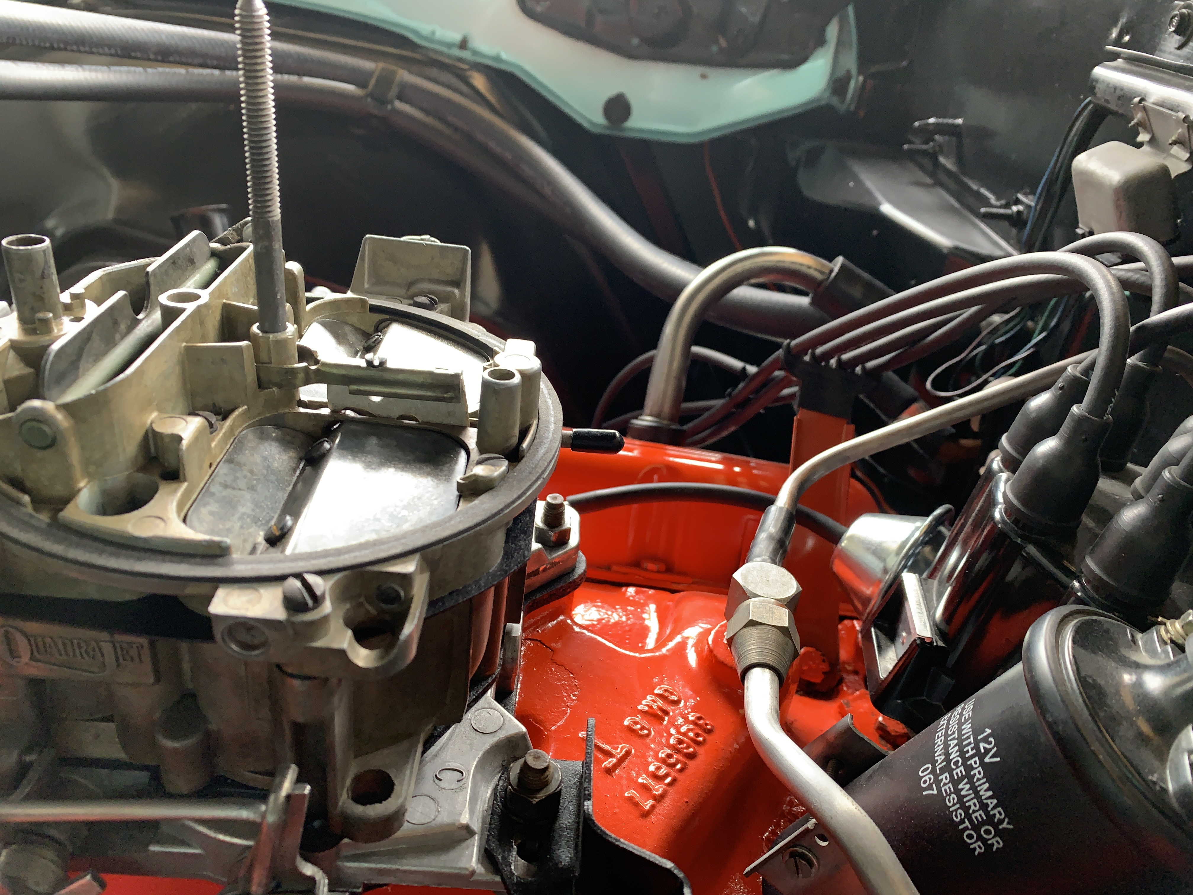

Canuck Posted February 7, 2021 Author Share Posted February 7, 2021 The carb is pretty shiny with fuel. Maybe an indication of too much fuel? I can certainly smell it. Quote Link to comment Share on other sites More sharing options...
wallaby Posted February 8, 2021 Share Posted February 8, 2021 The tubes you found are for feeding the secondaries....they will do nothing for idle and cruise situations. It looks a s if your carb is getting wet on the outside...and on the top. I suspect you have debris in the needle-seat assembly, or a heavy or sunken float....either way, you need to take that top off again and inspect. I would go ahead and start it for a second before taking it apart. That way you can see just how full the float bowl is when the top comes off. With the top inverted, the float should be level. if the float is heavy, adjustments won't help. Sometimes you just need to put in a new float because it's so hard to tell if the original had a problem. Quote Link to comment Share on other sites More sharing options...
Dtret Posted February 8, 2021 Share Posted February 8, 2021 I don’t think this applies to a q-jet but I just changed a brass float in the neighbors Holley. It had a crack in the seam and the float itself was filling with gas. Quote Link to comment Share on other sites More sharing options...
Gush's monte Posted February 9, 2021 Share Posted February 9, 2021 Aaron, check to make sure your primary needles are not binding open or the spring is too strong for your engines vacuum to pull them down into the jets. If they are not pulled down into the jet, running on the power tip of the primary needle would explain running rich and not idling well when cold. Also check that the gasket is not interfering and not allowing the primary needles to be pulled down. Quote Link to comment Share on other sites More sharing options...
