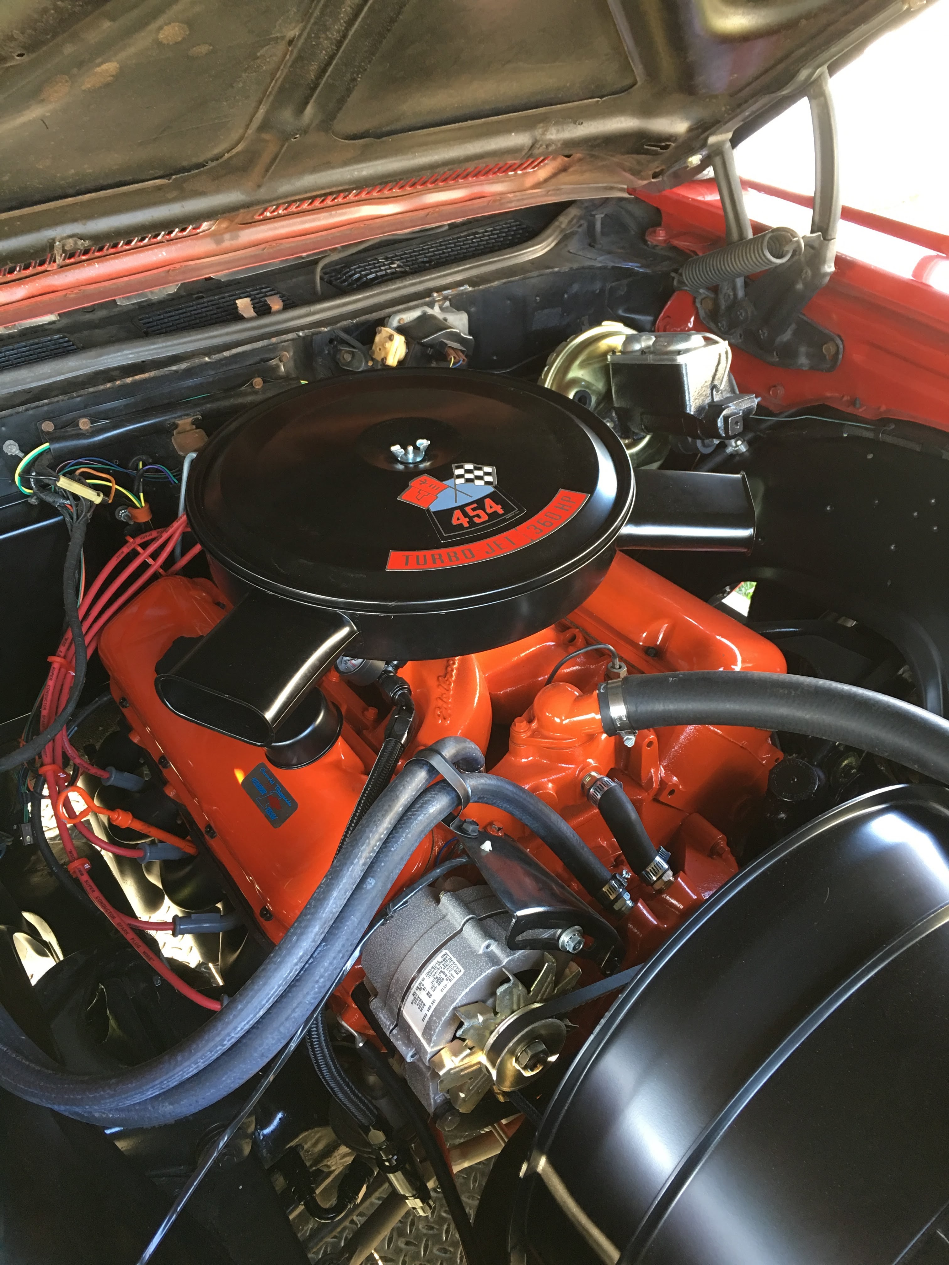

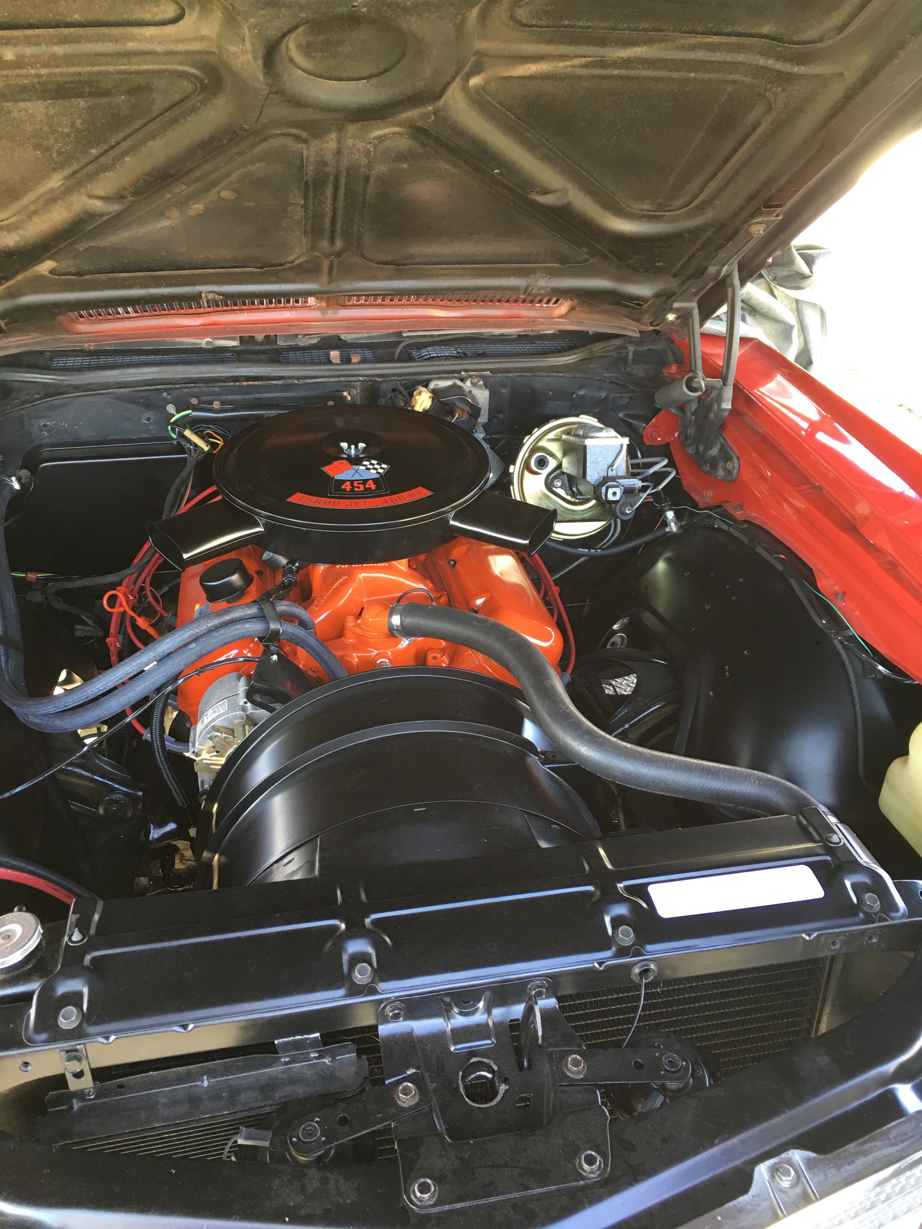

MC1of80 Posted September 23, 2020 Share Posted September 23, 2020 Andy, good eye. But they are stock production valve covers. They have a spacer between the head and stock valve cover. Lol Nothing on the performer RPM air gap intake? 1/2 fuel line? Headers? Msd ignition? Painted Holley fuel pump? Lolol I guess my wanting it to look stock ish worked. Lololol 2 Quote Link to comment Share on other sites More sharing options...

Dragginwagon467 Posted November 21, 2021 Share Posted November 21, 2021 On 9/22/2020 at 10:26 PM, MC1of80 said: Something like this? Would you share details of you air cleaner and valve covers? Quote Link to comment Share on other sites More sharing options...
MC1of80 Posted November 22, 2021 Share Posted November 22, 2021 Sure! Lol. The air cleaner is for a 70 Camaro. It's a repop. Has dimples inside to clear the Holley float bowl adjusting nuts. As for the valve covers, they are stock bbc. Idk what year but not correct for my 70. They have billet spacers under them to clear the roller rockers. 2 Quote Link to comment Share on other sites More sharing options...
Dragginwagon467 Posted November 23, 2021 Share Posted November 23, 2021 On 11/21/2021 at 10:50 PM, MC1of80 said: Sure! Lol. The air cleaner is for a 70 Camaro. It's a repop. Has dimples inside to clear the Holley float bowl adjusting nuts. As for the valve covers, they are stock bbc. Idk what year but not correct for my 70. They have billet spacers under them to clear the roller rockers. Is that the 2-1/8" drop? You have an RPM AIr Gap like me, I have a 1" spacer and a 3" air filter rubs the hood. It looks like you could run a 4" air filter in that housing, with an open lid and still clear the hood 😁 Quote Link to comment Share on other sites More sharing options...
MC1of80 Posted November 23, 2021 Share Posted November 23, 2021 It's definitely a drop base air filter housing. Idk what the drop is. Again, it's a repop air cleaner housing for a 2nd gen Camaro. Quote Link to comment Share on other sites More sharing options...
