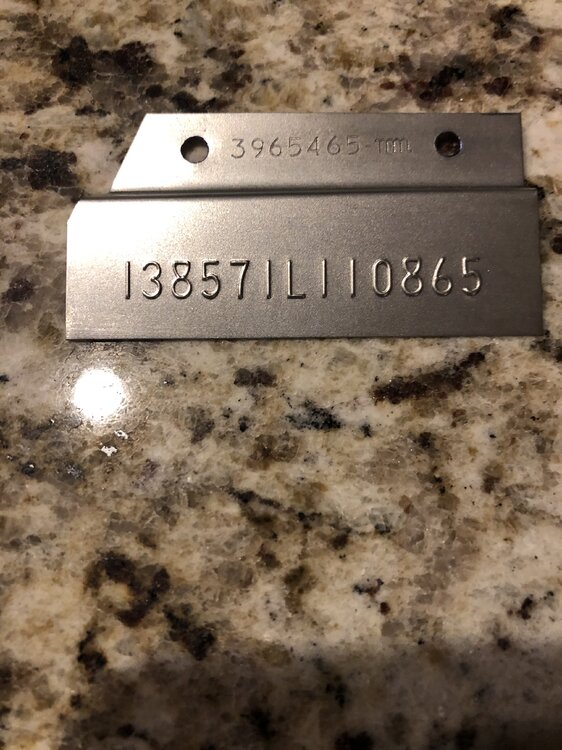

40 minutes ago, Dtret said:
I’m told black. I originally painted it blue to match. As I was mimicking your pictures ( because yours was painted). Now I’m not sure but I went safe with black.
Before I sprayed mine, I looked at a LOT of those tags on some of the dealer sites that have classic cars. Streetside Auto had the most cars, plus I looked at sold cars too, they still had a lot of pictures available. My take was they're interior color, so that's what I did with mine. I may have only been focused on dark saddle though.
Later tonight, I'll look them up again and see if my memory is failing me.
When I search other sites I find the question “ is tag painted “ and the answer is yes with no explanation. Don’t they realize black is paint also. Lol.
7 minutes ago, willie said:
All of mine are black, or look like they were black.
Dennis what is that blue tag called, i dont think i have that on any of my cars?
I sure hope not. Lol
Thats the replacement tag the state of California put on the car because the one under the windshield was rusted and gone. They were at least smart enough to verify the original vin and use that number.
I looked at the Streetside site. Looks like the Saddle interiors mostly had the tag & adjacent area interior colored, though one had a black tag with cowl area painted saddle. There was a darker brown interior that had the tag & adjacent area it was riveted to black.
There was one with a blue interior that had the tag and the panel it attached to black as well. So the next question, on the darker cars, should that whole area be sprayed black then (tag & cowl it mounts to)? Are yours both black everywhere Willie?

My “adjacent area “was originally blue. Though now I’m not sure if it’s supposed to be dark blue (interior) or ascot blue (light)(body color). It sure looked dark blue to me. What was left of it anyway. So it got painted interior color
I will ck all the cars tomm.  But the 72 custom that was painted by my painter the color blue at the time, i asked him if that was correct and he said NO it should be black. So i had him repaint it black. I also, on the same car had the same problem on the rear window that the upholsterer told me it should be painted black. I didnt know at the time but found out later.
Dennis tkx on that info about that tag, i also didnt know thats what they do.
On 1/18/2022 at 7:58 PM, Dtret said:
So I got one of the first parts I started looking for when I bought the car today. MY VIN TAG. ( I also posted in another post so sorry about duplication).  So tomorrow Two rivits popped in ( yes I have the correct ones) dash pad installed and I can get the glass put in. Whoo Hooo.
OH! I am in desperate need of a factory VIN tag to replace my old one. Where/how were you able to get it? PM is fine if you'd rather that.
