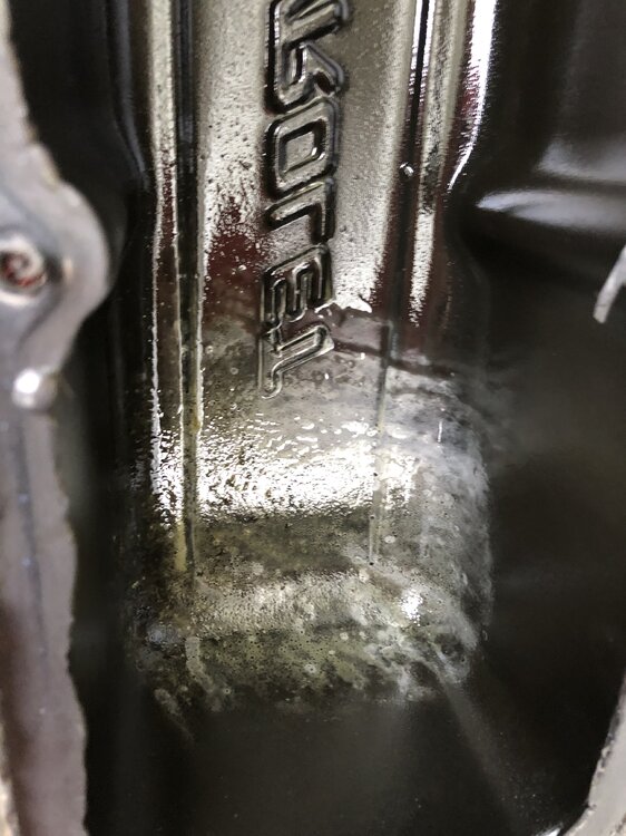

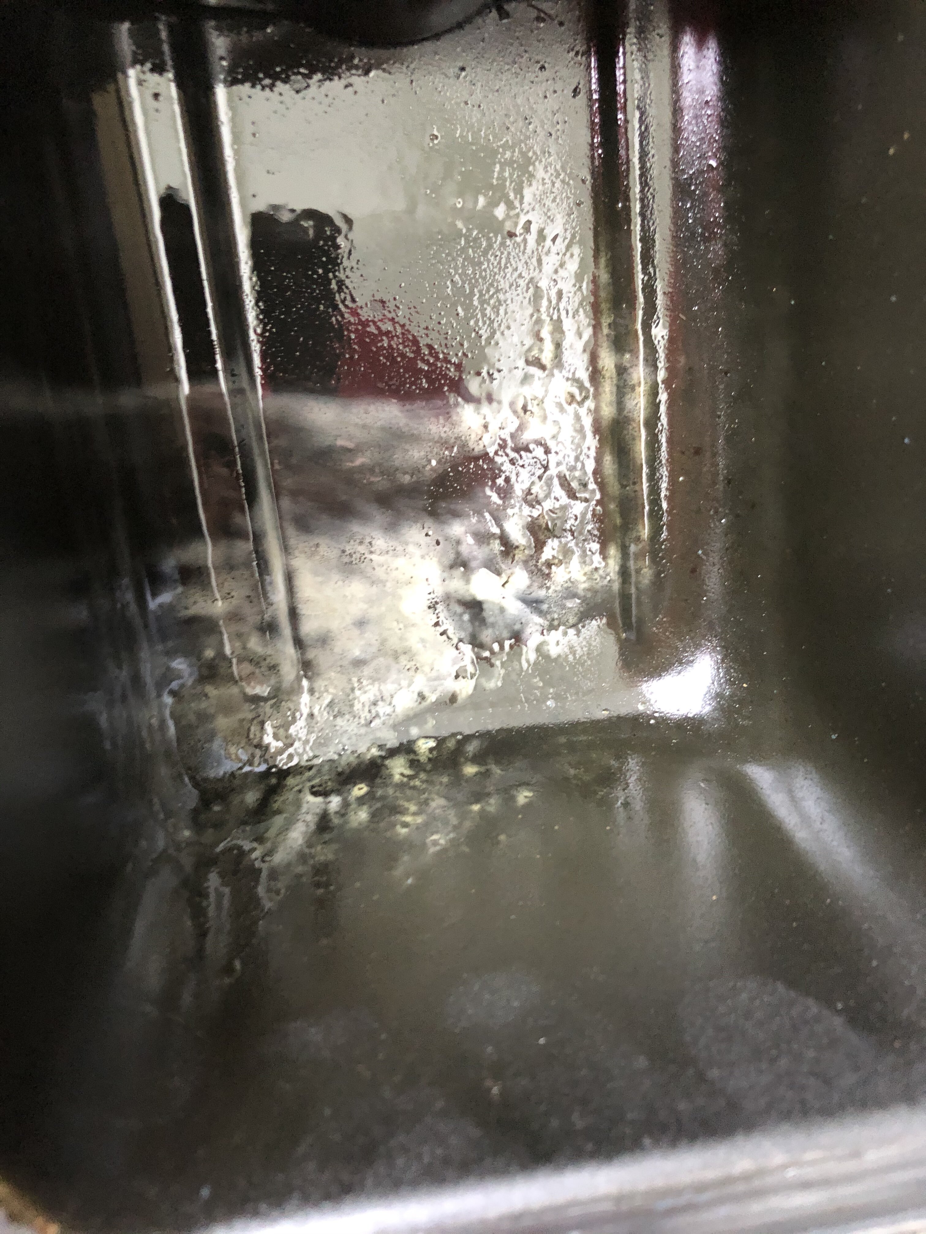

It’s for my 1972 GMC C15 with SB350-it was leaking oil as I took the first step by replacing the valve cover gasket and cleaned up engine to detect leaking.  Still see oil spots on  driveway as did not find any leak around the covers as it seems to be leaking somewhere in rear top.
Question here is if the distributor (HEI) has gasket that might need to be replaced?  If not, where else should I look for leaks?
i read on other forum to use oil dye with black light to detect leak, I never used this method before, would you recommend doing this or not?
