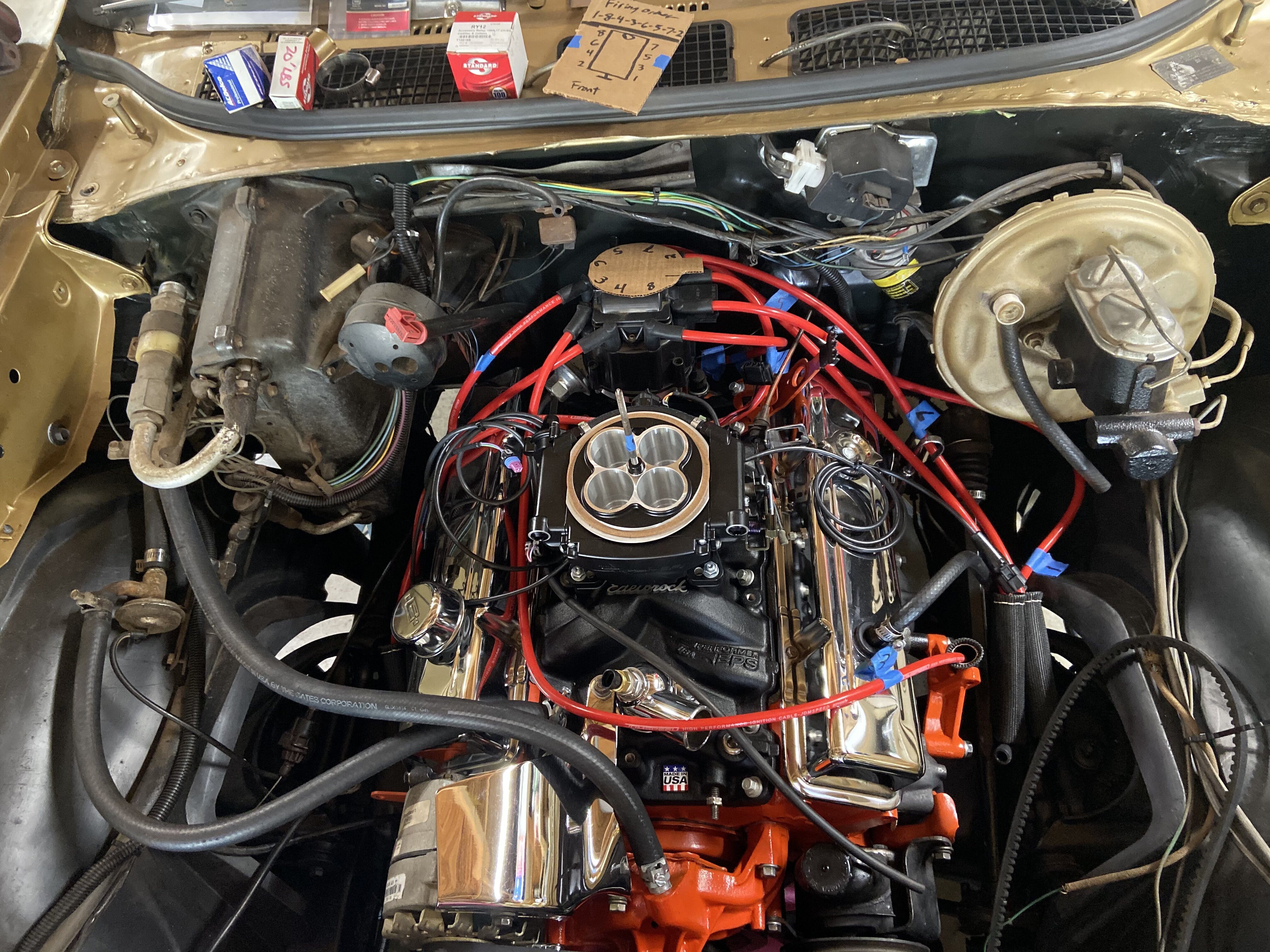

I installed a Sniper on my small block
Like others said, it’s pretty easy.
love being able to depend on it starting.
Red plug wires were only ones I had in the shop. I replaced them later
