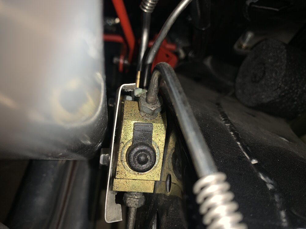

Did you guys get 2 inch or 1 7\8 Headers ?  Ill have to figure it out. I know all cars even same models can be different depending on parts used and such. The Patriot headers I have do work , but they hang low. Im not bottoming out all the time but it does once  in a great while. Main issue is I don't like how you see the exhaust when u step back from the car.  Here is a picture of how close the Proportioning valve is.

I went with 2" primaries, and my proportioning valve looks similar to your pictured. I haven't had any bottoming out issues, and I have to go over 2 speed bumps leaving my hood. Some fast and furious cars have to do some creative driving for them lol. I'll see if I can get a "level" picture to show how they tuck up this week, all mine are from me standing a couple of feet away. And since we are having cooler weather I figured it would be a good time to test the heater lol.

Thanks guys.   I have gone back and read through that other post as well.   I would be going with the 1 7/8. I reached out to Dan - Overdrive since he has the 7 1/8 installed. He said
"plenty of room for the original starter. One tube is close to the valve, but it doesn't touch it and never had a heat issue with it.   The only thing I found that I didn't like is that the driver side header is in the way of the backdrive linkage from the transmission"

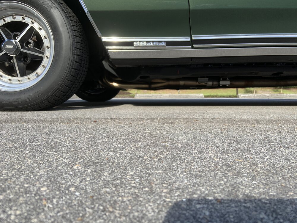

Here is a better look at how low my patriots hang.

Hey Alan , I too had an issue with the back drive linkage ( I call it steering wheel lock linkage lol ) not fitting. I don't think I posted it in the thread because Joe (jft69z) mentioned it. Joe asked me today about it so I thought I would add it here, I never fab'd anything to make it work so far. But it also got me thinking, I had another issue with my a/c bracket (link below) but Joe found me the spec's and I just modified my stock one to fit. Also is a picture of my headers, i'm laying on my side and probably tilted the camera up a tad to much but again Ive had no clearance issues.
Ya yours are defiantly tucked up nice.  Car looks great , love the wheels. No one wants to pay a lot but I am willing if it fits right. It seems like everything I get some other change needs to be made though. Nature of the beast.  It looks like it may be the ARH. I also found this place GP Headers in Minnasota. They have a kit you buy to mockup your headers. Send them the mocks ups and they build your headers. The nice thing is you can be sure it will fit everything. The down side like everything is the cost.

The tubes run close to the brake combination valve on the frame, but it doesn't ever touch and I've had no problems at all with the heat near the valve.
