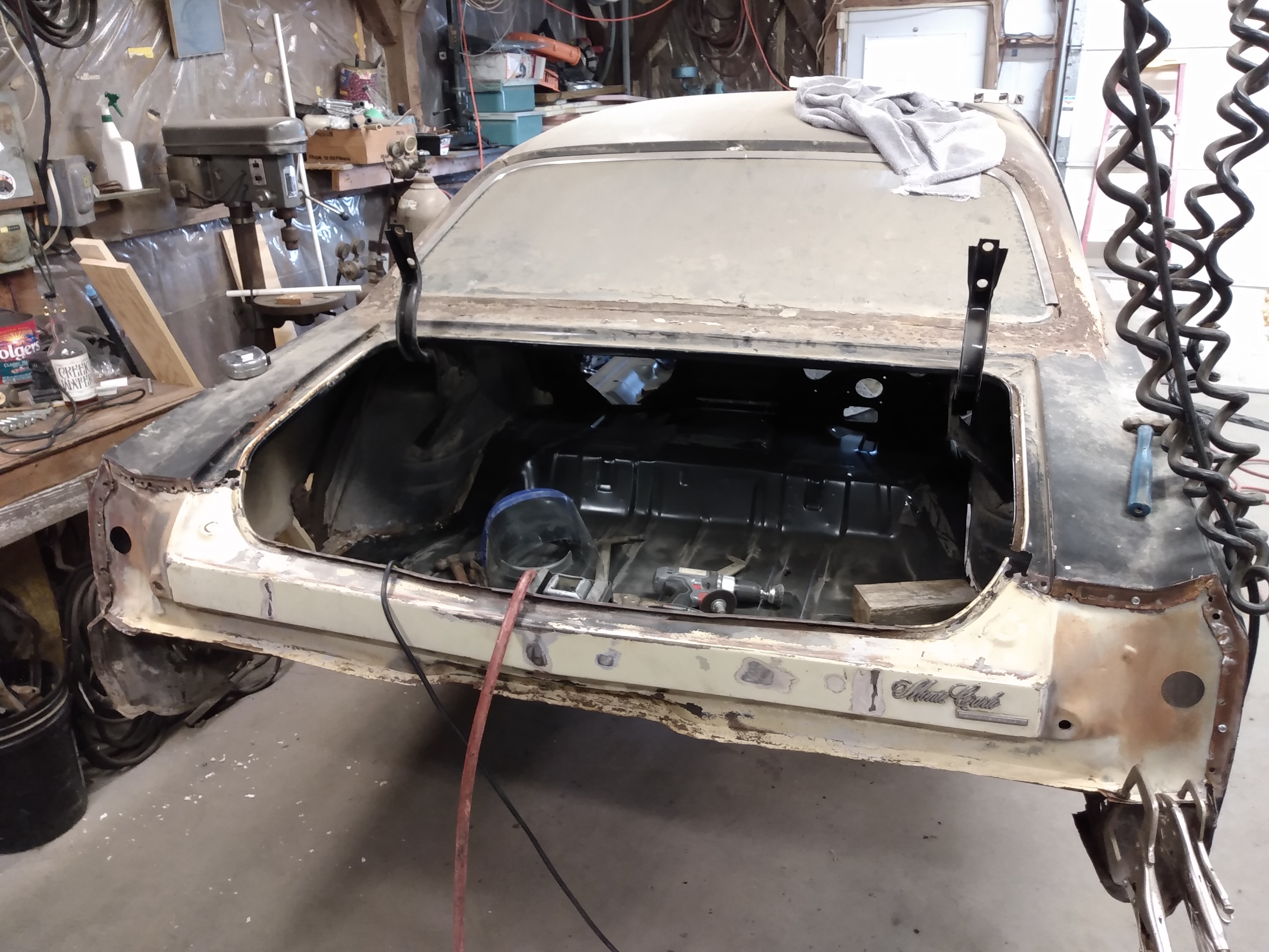

Thought I would just add to this ancient thread with a new pic. Since I didn't get anything done but motorcycle riding this summer I was going to get to work on the Monte while it's cold out.
All new wheel houses, trunk extensions, and full quarters on order. Now I'm being told AMD is backordering the quarters until mid March and the wheelhouses until May. Out of all that I ordered I got one inner wheelhouse and a trunk extension...for opposite sides.IMG_20211230_170008482.thumb.jpg.e037fbf808a248c577dfc71d37bc6ce8.jpg
